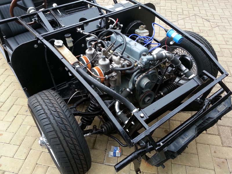

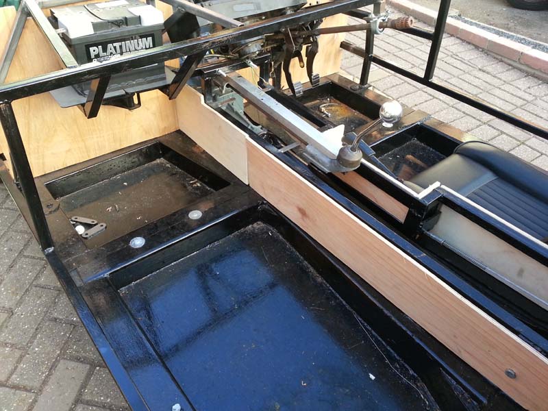

Weekend update.....

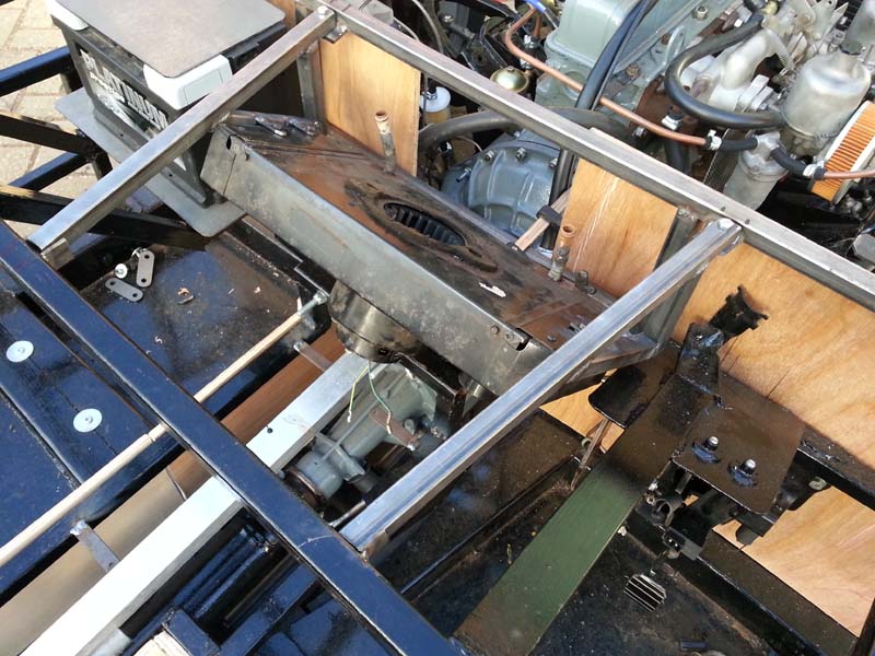

Got hold of a Spitfire MKIV heater matrix and fan and made up a mounting for it. It is a lot slimmer than the Herald one and so I don't need to cut it up or modify it.
Started to panel out the bulkhead and centre tunnel - the front parts will be removable so I can get to the clutch slave cylinder and propshaft bolts in the future.

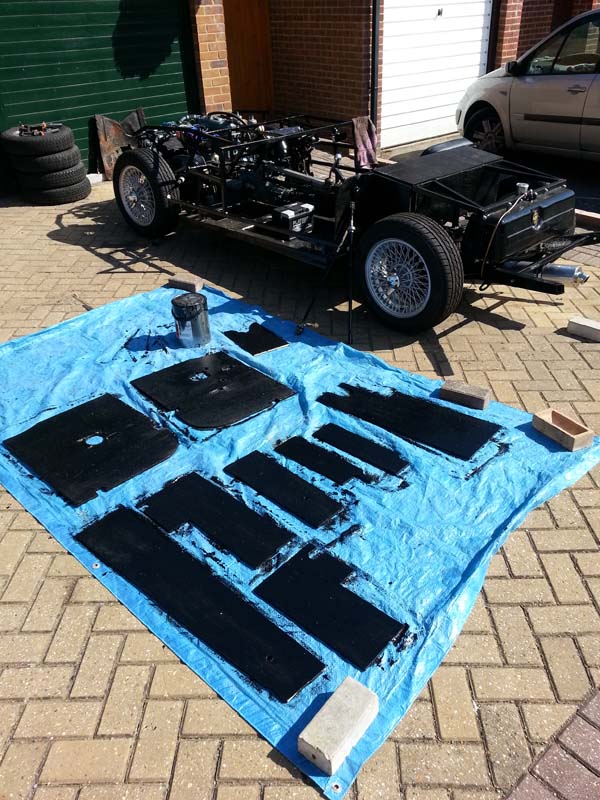

Then took it all apart and resin and painted all the panels and frame...
Then plumbed in all the engine with the radiator and header tank mounted. The header is out of 1600 Vitesse and looks period. I had one in my Sammio Spyder and this one I managed to grab on ebay.

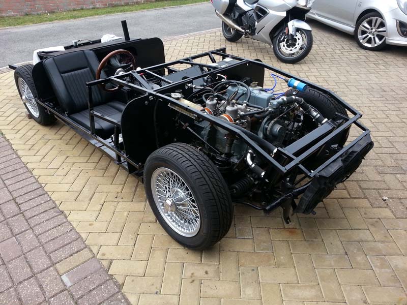

Made up the hinge point for the seats so I could get the seating position right and it is very comfortable. Even the pedals and gearstick are in the right position!

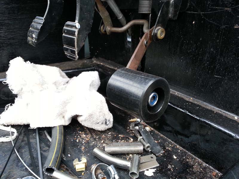

Got hold of some 50mm diameter nylon and got a friend of mine to turn me up a rather nice roller throttle pedal .... it's a bit different and reminds me of some VW Beetles I had where I put a skateboard wheel on as a throttle pedal.
So a bit more progress made. :thumb:
Should be getting my body next week so I will do a trial fit and then if everything is okay I will start to get the wiring in and get the engine running!
4 Aug 2013, 8:04pm
Looking a top job Tony.
It is always nice to make the effort at this stage i think.
I like the header tank , i think its nice to use period items on your build as it can
still confuse the general public on the cars origins and keep them guessing.
Keep up the great work mate.
:thumb:

Tony - It looks like you are well on your way to building another very nice car. :cool:
Hope the trial fit of the bodywork goes well.
5 Aug 2013, 7:28am
I really like the penultimate pic. It looks ready to go. Nice job.
5 Aug 2013, 7:40am
Agree with comments above, black chassis and frame looks classy.
Moon rover stage looks good to go!

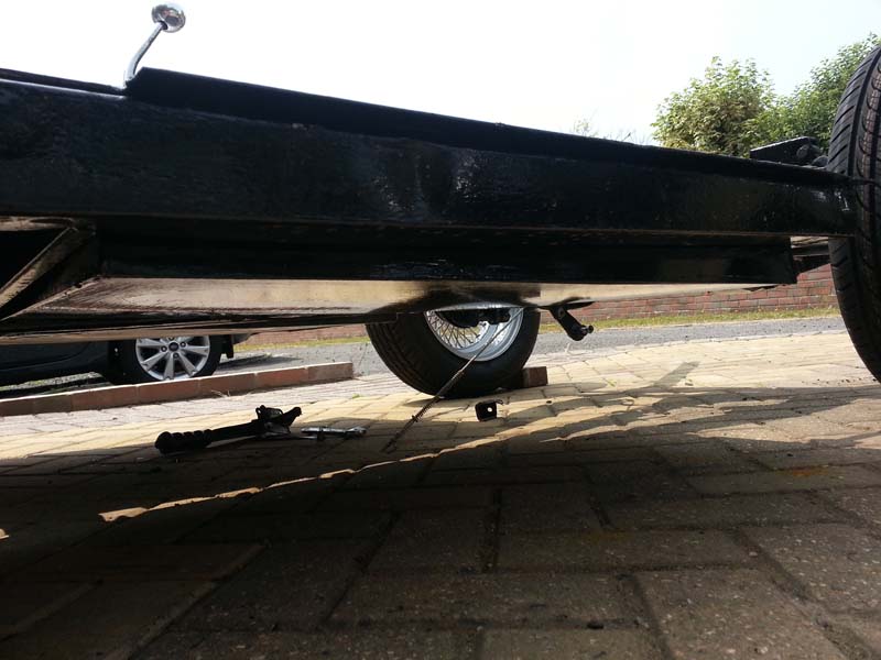

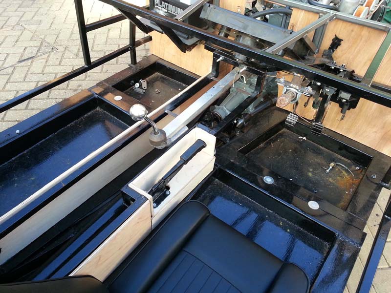

hi tony could you give me the meurment of the floor pan the rear one width and length +/_ 5 m/m sorry to be a pain going to make my seats this week thay may end up in the skip ta dave r
22 Aug 2013, 12:28pm
i'd also be interested in those measurements, and also whether the "drop" at the rear takes the low bit lower than the bottom of the centre chassis rail, and if so by how much?
22 Aug 2013, 8:21pm
And this is what the rear ones look like in situ...
23 Aug 2013, 11:47am
hi T ta for info dave r
