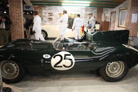

And this original d-type in the dry motor show building

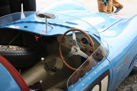

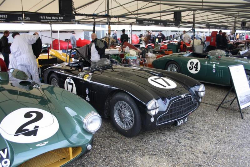

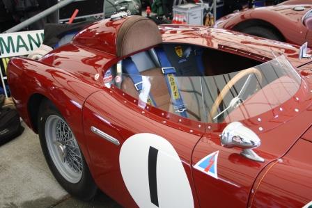

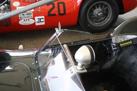

But the best part was the close and personal in the pit area with the 1950's Maserati, Ferrari and Aston Martins.
Where I was keen to see how the side screens were attached and fitted to the main screens

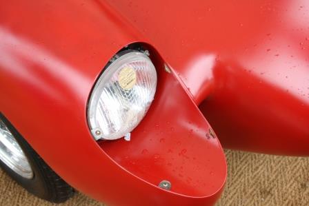

Headlight aim - A bit low as they were shining at his feet, so some serious packing or even cutting of the fibreglass mounting is required.

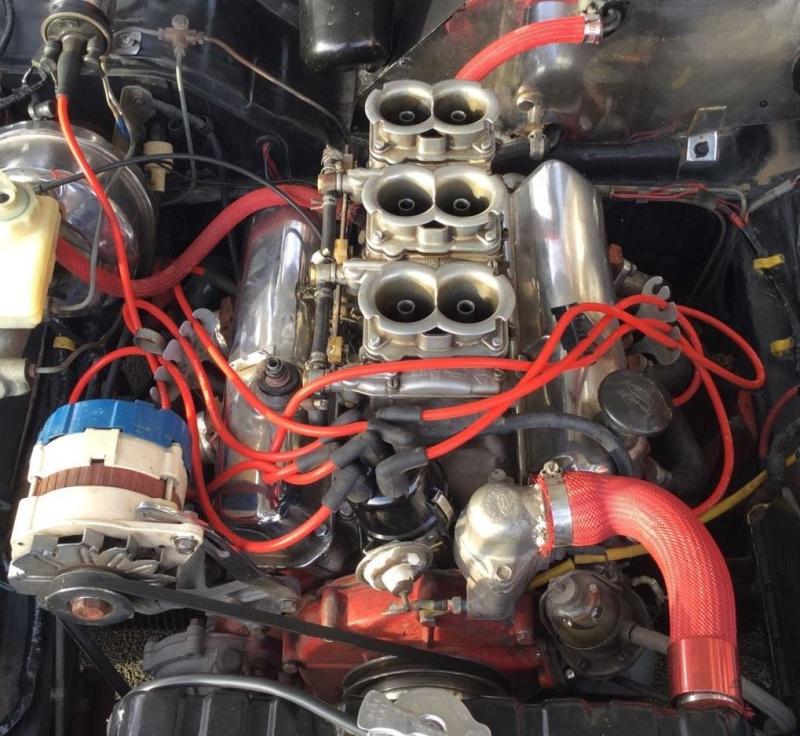

I'm new to this forum, I am the owner of G46 no5, the ex WCA car.
It was on the road for a while, great fun to drive, and is now being rebuilt as the original construction was quite rough. At the same time I am upgrading the frame to an SE5A and a fast triple carb engine.

I like the sound of the triple carbs and great to look at.

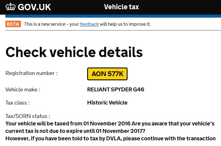

Dvla
Just got the V5 back from DVLA so I did a vehicle tax check.
I wonder what the other G46's have on their V5C

Unfortunately, what I mean by a bit rough was the original build, the body is bodged on with lumps of wood and 2 part foam, internal panelling is cheap ply and the engine was a complete nightmare.
The car looked great from the outside and drove quite well although skinny tyres on 4" wide TR4 rims made for lots of sliding around.
I am going to replace all the panelling and the front bulkhead with aluminum sheet. I am fitting a balance bar pedal box to get twin circuit brakes.
The car should be back on the road in the Spring, should have around 200 or so horses so will be an exciting drive!
