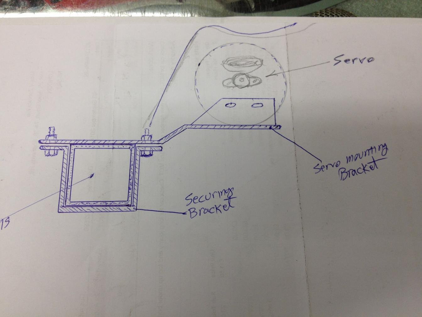

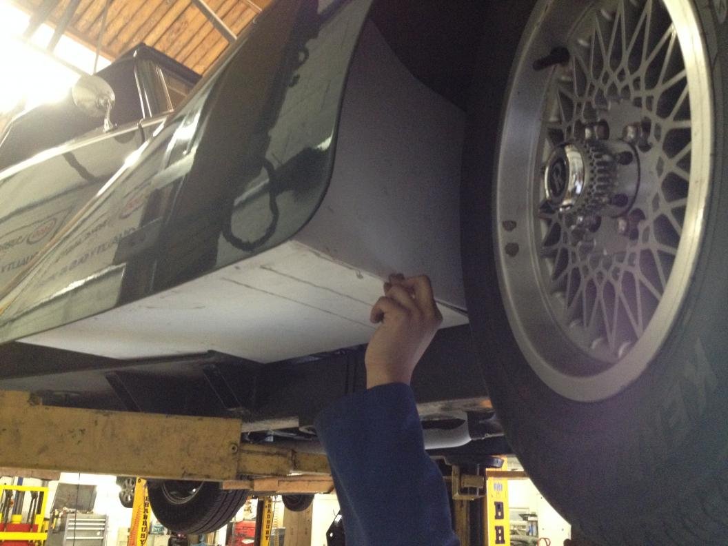

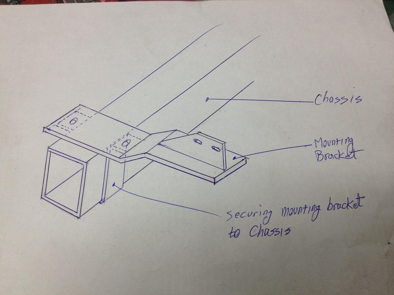

Remote servo
Hi Peter,
I have managed to put some pictures which shows the original sketches, the bracket and position the brackets and remote servos would be fitted, underside of both front wings, how it can easily be covered from the elements with light weight material which can easily be removed for service. Hope this is useful.

20 Oct 2014, 3:57pm
Hi Amir,
that is an ingenious idea. I had not considered using the spaces under the front wings!
Do you have a particular servo in mind?

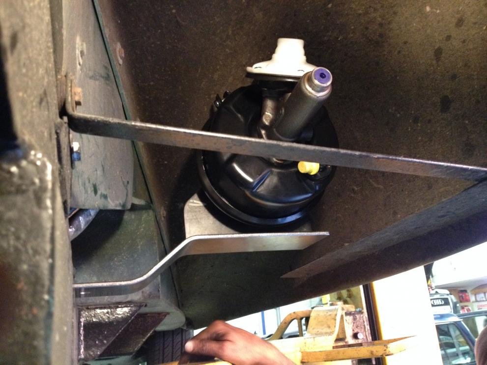

20 Oct 2014, 4:37pm
Hi Peter,
The two Remote Servos were purchased from Powertrack Limited, Lockheed Servo Installation kit, I believe Part No: PT726798, at least this is what we have been invoiced. and the picture of one positioned under the wing is attached.
Attachment “IMG_3403.jpg” from the original forum could not be reliably recovered.
20 Oct 2014, 4:56pm
Sorry, the picture was wrong one, I attach the right one, I hope.
