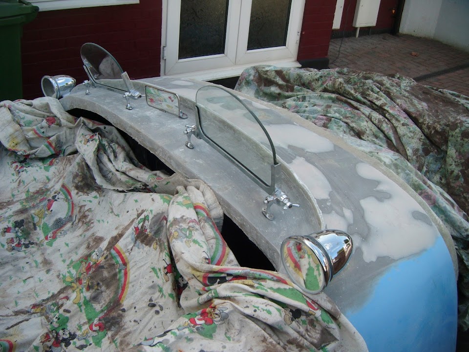

The M5 bolts I ordered initially looked like a perfect fit for the aero screen brackets.
But the countersinking in the bracket doesn't match the bolt, which stopped it sitting straight.
So somewhere along the line I need to take a file to this area.
Still, the bolts are certainly good enough for the next round of mocking up.
I really took my time to ensure that I would only need to drill each hole once.
So I didn't mark up the second bracket hole until the first one had been drilled & the bolt pushed into place.
Then I fitted the screen to ensure the second bracket was in the correct position relative to the first.
Note:
The "inside" bracket is half an inch further away from the scuttle lip compared to the "outside" one for a subtle screen angle.
Obviously I repeated the exercise on the driver's side, but ran into a small problem, that was thankfully easy to fix.
I want to fit the screens so that the "Brooklands" stamp faces forward & the "Made in England" faces backwards.
But the two screens had the fitting brackets fitting in different ways, so I had to swap the "ends" over.
That way, the "flatter" section of the bracket was in the same orientation on both screens.
As always, the sloping drive doesn't help the "head on" view.
Next it was the turn of the rear view mirror to be fitted & I just had to enlarge the holes ever so slightly to take the M5 bolts.
After I had temporarily fixed all these things in place, the M5 "Penny" washers arrived.
So I will be using these when the time comes to finally fix everything into place.
Then I put my well used former back into service to help me line up the wind deflector.
I trimmed the metal former to allow the bottom edges to be curved nicely.
But in addition to curving "forward to back", I also needed the former to curve "downwards" too.
So I had to make some slits in the vertical face.
End of Part 1...

That's looking great. I bet it was rewarding to fit the screens. I have aeros as well.
4 Sep 2014, 6:44pm
Agreed v.pretty.
Although after years of no one using Aeros it seems like we've all opted for them at the same time, as I've got some as well :)

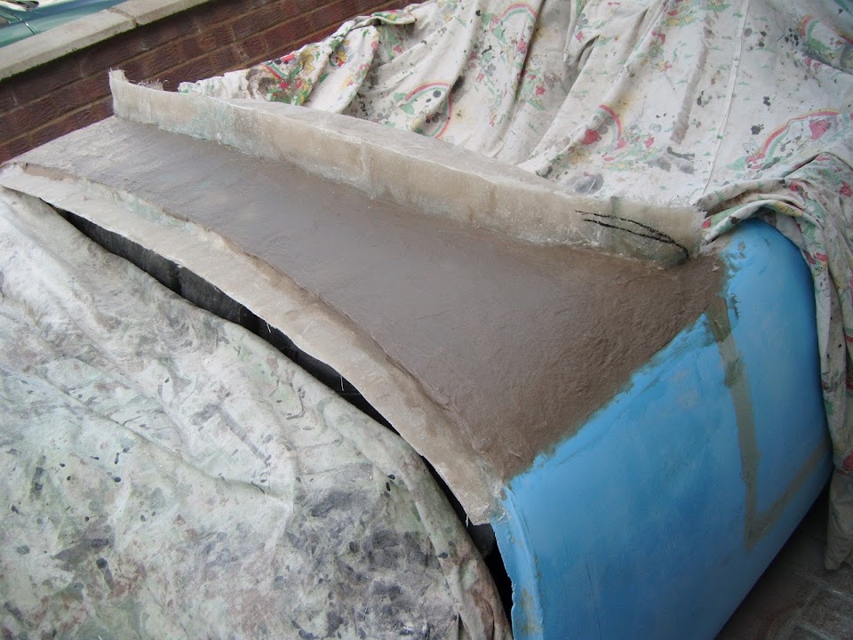

Very Slow Progress - Part 2:
Instead I started to extend the other side of the lip, which due to the curves involved I need to do in stages.
Well, the curves and the fact I only have 4 clamps to play with. :rolleyes:
With the first round of fibre glassing complete, I left it like this while I got on with other stuff.
After a while I came back to remove the formers, leaving the lip looking like this.
This allowed me to put the formers back on to fill in the gaps and extend the lip on the driver's side.
As before, I had to ensure there was a bit of extra pressure from behind to hold the shape of the lip.
Although it doesn't look it, there are actually 4 layers of matting in parts of the lip "extension".
That was all for today, but I hope to start building up the lip from the other side over the weekend.
And at some point I will have to re-work the outside edges of the lip to minimise the lack of symmetry on each side.

After some other domestic chores were ticked off, I could finally return to the wind deflector lip.
With the formers removed it looks like this.
Before I started to build up the lip from the "inside" face, I went back to the outsides edges of the lip.
The cold reality is that the cockpit sides are not the same distance from the centre line of the car. :frusty:
But I abandoned the quest for perfect symmetry a long time ago, so this is just another compromise I've got to live with.
However, I have decided to line up the final edge of the lip with the cockpit sides, regardless of where they are.
Hopefully, the more areas of the car that vaguely line up the better.
So I cut out the end sections and re-used some mesh to provide a new profile.
Driver's Side:
Passenger Side:
Obviously the two sides are not identical by any means, but I am not going to lose any sleep about that.
I cut out two long lengths of matting to cover the inside face of the lip and the join between body & lip.
( This last piece had some slits cut in it to make it easier to bend into place. )
The reality was I should have stuck to my normal practise of using smaller sections of matting as these sagged when lifted.
Still at least I eventually got them into position and all flattened out.
I also started to rebuild the corners.
By the time I have given this lip its final shape, I expect it to "fade" down to the scuttle long before it reaches the ends you see here.
As I have just added extra fibreglass to make the whole thing easier to build and then cut back.
That was all I managed to get done on the car today, but it is good to see the wind break slowly taking shape.

It's Filler Time:
Started the day by applying fibreglass filler to the scuttle area inside of the wind break lip.
Then I switched to "normal" body filler to cover the low spots on the other side of the scuttle & make a start on the lip.
Note: I really must learn to put less filler on when I'm supposed to be just giving it a skim. :rolleyes:
While I had the normal filler on the go I also covered the "sealed" door gaps.
When the filler had gone off sufficiently, I started to sand it into shape.
This took two sessions, was hard work and extremely messy.

Anyway, this is what the various areas look like now.

I had re-drilled all the mounting holes from below so I could re-fit the aero screens and mirrors.
I made a temporary rubber spacer from a bit of inner tube for the rear view mirror.
The penny washers worked well on the rear view mirror.
Not so well on the aero screen bolts. :rolleyes:
Until I cut the new longer bolts to size, I just used extra nuts to hold the side mirrors in place.
So here are all the shiny bits fitted. :cool:
The next steps will be to trim the wind deflector lip & scuttle lip, but I ran out of time today.

( I will also shape the bottom edge of the perspex to match the scuttle contour. )
My theory is that by keeping the lip a constant height, this helps to disguise the different gaps between the mirror & the screens.
My next trimming job was on the scuttle lip, so I temporarily fitted the dash into position.
It was clear I needed to take a bit off the lip, so I made another low tech marker pen guide.
I left the lip a constant depth until it reached the corners, where I let it expand to blend into the cockpit sides.
( Depending on how deep the sides end up being I might come back and trim some more off. )
End of Part 1...
