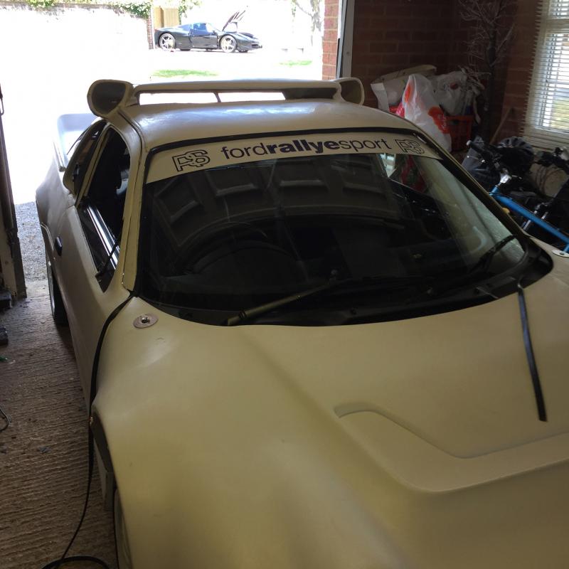

The bigger windscreen looks great. I didn't realise there was that much difference in how it should look to be honest. Interested to see how you've gone about hinging your rear end. Also, how have you managed to keep your car so clean?!
16 Feb 2018, 11:43am
Badrep - here’s a couple of additional pictures showing how I marked out the new roof line and built up the sunstrip. I based the roof line as close as I could to the original RS200 (see fourth picture here) but you are left with a couple of gaps in each corner of the roof panel where it no longer flows down to meet the hard top/MR2 windscreen upper rail. For these I made up a couple of rubber fill pieces that I then used to create GRP pieces out of which I bonded to the inside/trailing edge of the roof panel. I should say I had already cut my roof panel away from the rear clam and my pillars were also separate as I had the kit delivered. That in itself made this a lot easier.
The sunstrip being magnetic just about holds on to the edge of the screen/hardtop and I had intended to leave it this way so I could remove it later as/when the screen needs replacing. I think I may ended up glueing it down as not convinced it won’t flap at speeds over 70!
Nostromo - thanks for the feedback on the screen. I was pleased with the effect and the windscreen rubber whilst only for show (and glued on!) makes a real difference as well. I’m holding fire from hinging my clam right now but have all the hinges/brackets and support work - would rather get all the other jobs completed and it back on the road first, hence I’m bolting the clam in as a first step but making everything like wiring, fuel flap/release such that it can hinge later. As for keeping it clean ... I’ve yet to do any real sanding/prep work on the panels which may explain, but I must admit the old garage dyson comes out after any drilling/cutting of the panels and I’m fortunate enough to be able to work on the car in the garage most of the time .

It looks so much better!
My kit was delivered too so I'll be going through the same process. I really like how you've done it. The other bit that really bugs me is the bonnet line - that's an area that I'll be working on to fill in. Never done any fibreglassing so I'll be in at the deep end with that one.
Is that a Ferrari I see in the background too?
19 Feb 2018, 8:39pm
Thanks Badrep. Yes I think even Andy, the original owner of the moulds, has commented in the past how he wished the bonnet line was longer and squared off instead of following the MR2 wiper/vent area.
I have been keeping a lookout for a cheap Sierra MK1 lower windscreen vent panel to see if I could marry that with the MR2 panel and extend the bonnet up. Probably put that on the phase 2 list along with hinging the clam!
Yep that is a Ferrari in the background - unfortunately it’s not mine!
