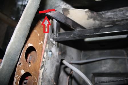

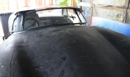

Chesil were more than happy to supply the 500 screen, they said my money was as good as anyone else.
The kit came with all the rubbers, trim and bolts all tapes in position. Good quality cast uprights with a great chrome finish.
There were 2 problems:
1. The g46 scuttle did not match the curves of the bottom of the screen at the angle I required.
2. I had to extend the metal frame so that the uprights had something solid
to bolt up to as I suspect the fiberglass body would not be strong enough.
