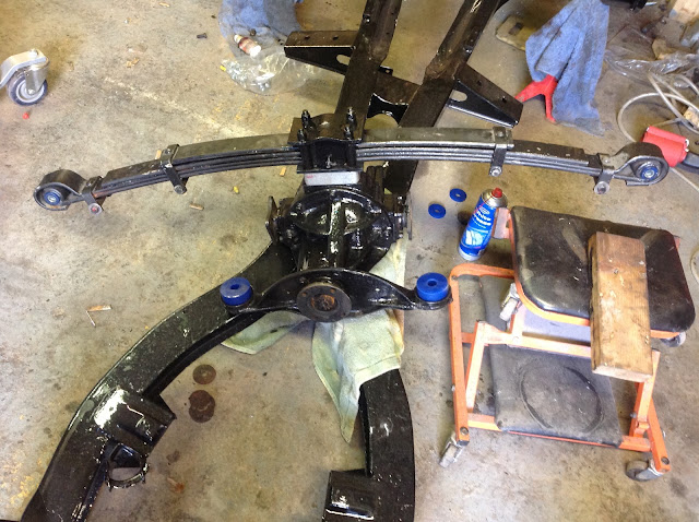

Diff an spring fitted today before I left:
