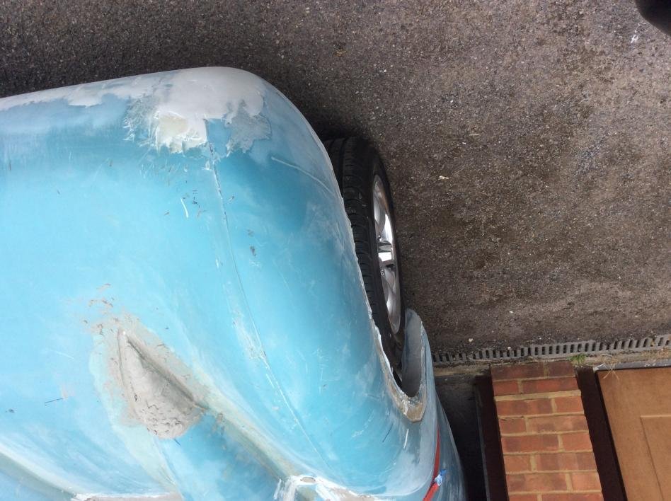

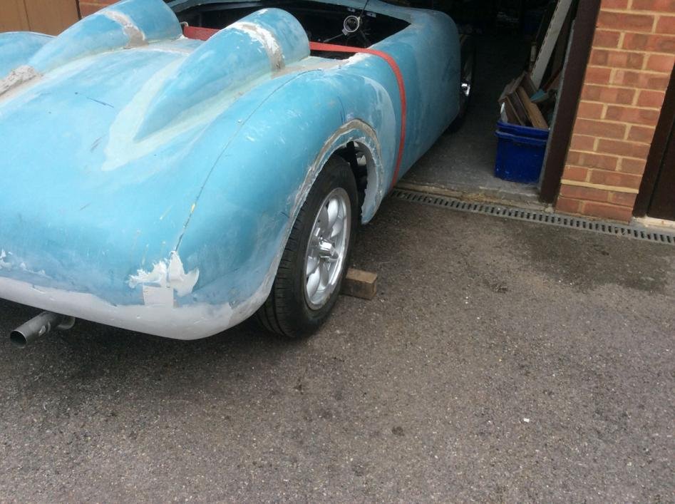

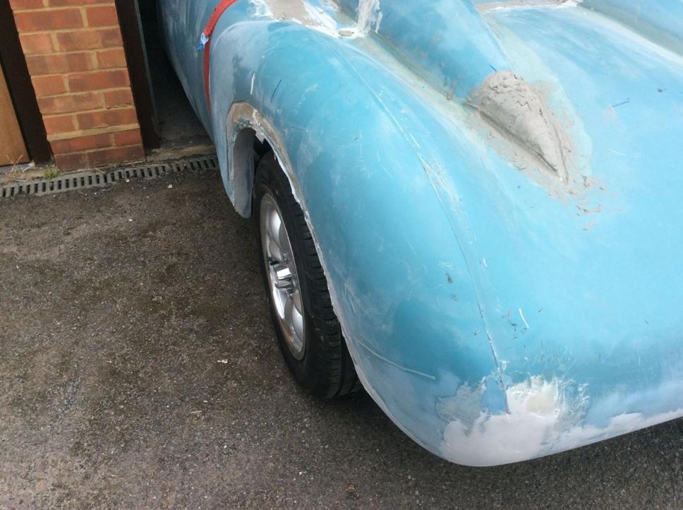

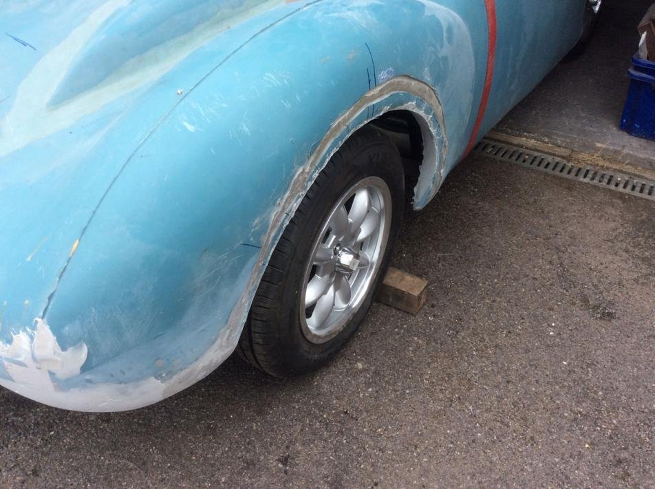

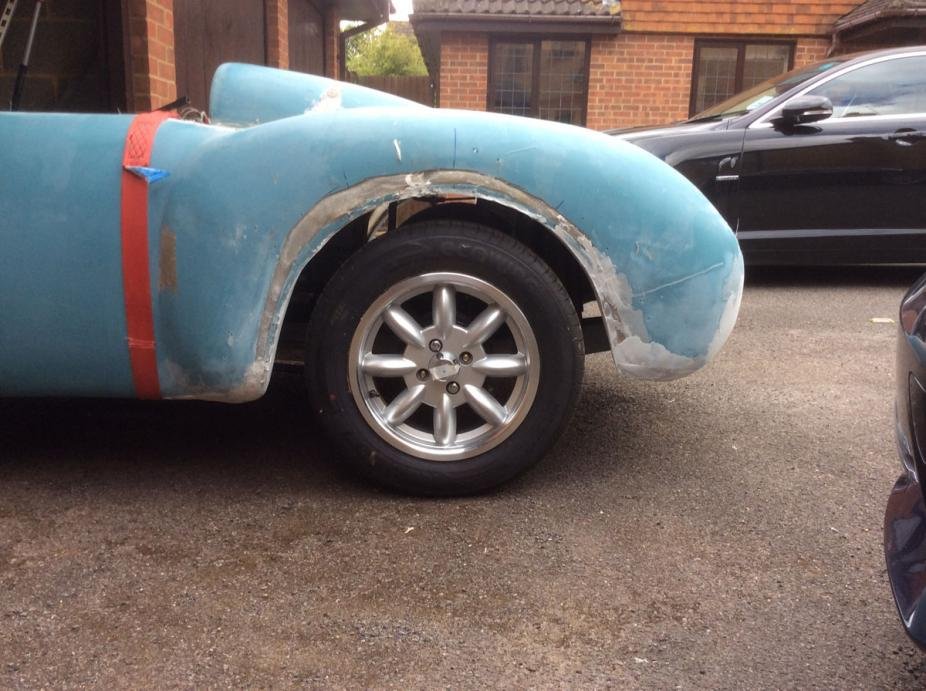

Paul - the wheel arch is now on a 35cm dimater circle from the centre of the wheel and looks about right.
Here are some pictures:
Seems to me that the front of each of the rear wheels is quite a way inside the wheel arch whereas the rear is well outisde the wheel arch. I have not changed this aspect of the bodyshell and so assume this pose to be standard?
Thanks
Chris
8 Jun 2015, 4:23pm
Chris - Thanks for the measurement & your arches looks miles better. :cool:
As the the rear arch profile, they did "sweep" back on the Spyder, as seen on this photo of Mister Towed.

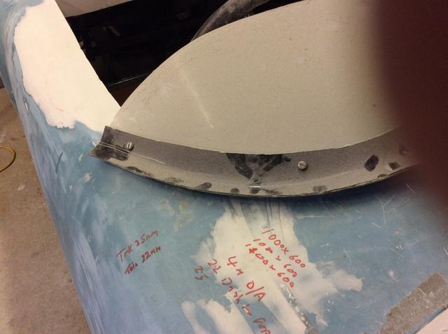

Tonight I have fitted the bonnet which is now bolted to the car for the very first time. Was feeling pretty pleased with myself UNTIL I tried to open it and found that the skirt (underneath the grill) meets the chassis before the bonnet fully opens. Photo below probably gives a clearer picture.
Cant remember seeing this on any of the other build threads that I have followed. Is it me or do I need to cut out some of the skirt to allow the bonnet to open fully?
26 Jul 2017, 8:08pm
YOU WILL NEED TO RELIEVE IT ...I have done it several times so don't panic !
Either slot each one individually or , an easier solution , one large slot across the two horns ...
