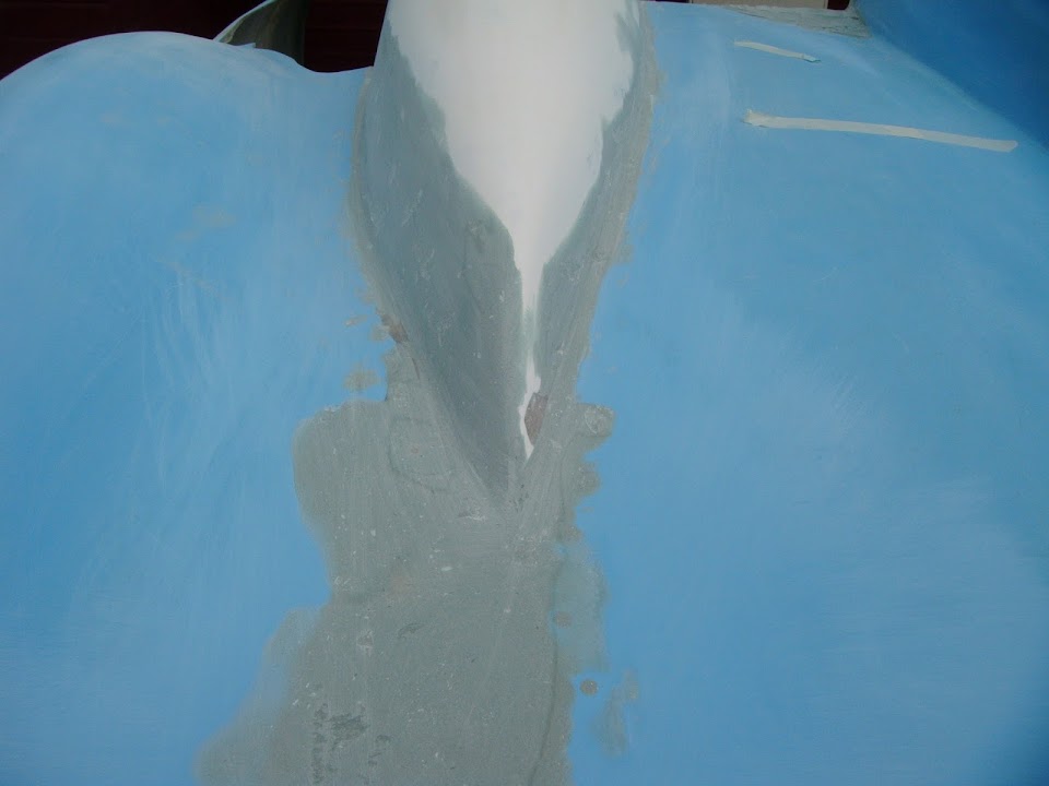

The bulk of the day was taken up with adding filler and roughly sanding it down.
Hopefully it will be easier to see the differences if I stick to one section at a time.
Outside edge, cleaned and ready to go.
Fibreglass filler added, pushed into the gap between the hump & the body shell, plus over the rivets.
Roughly sanded down when that was initially set.
Another round of filler was added to cover the join and smooth the transition from hump to body.
This too was sanded down.
Obviously everything I did on one side, I replicated on the other.
The "tail" of the hump had some extra filler added below it to cover the previous repair work and blend it in better.
The filler is quite "runny" so I build up the vertical faces of the humps in stages.

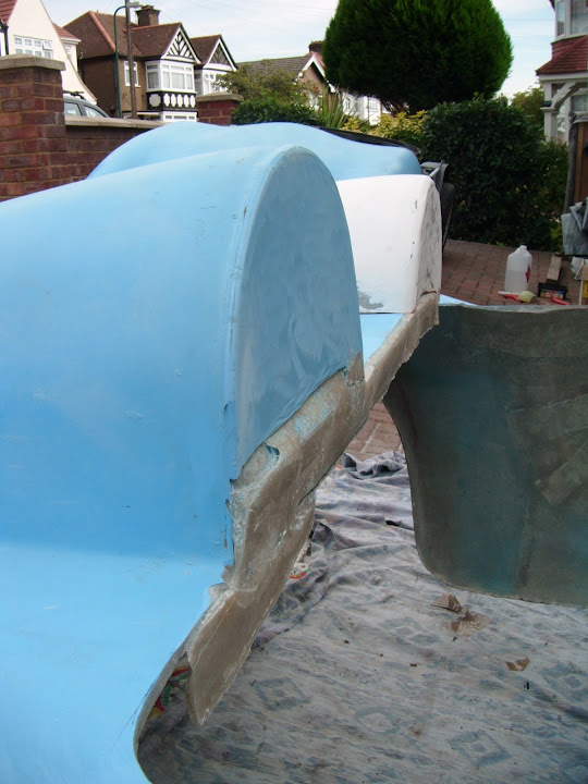

Passenger Side:
End of Part 1...

What A Difference A Day Makes - Part 2
Driver Hump:
I also started building up the body shell area next to the driver's hump.
I was hoping to re-fix the section of body shell I cut out next to the passenger hump.
So I lined up the front edge with the rest of the rear cockpit lip.
Then added some brackets to hold it in place.
Including the bracket I had "left over" from fitting the hump itself.
But once again the clouds were gathering overhead.
So I decided not to push my luck and packed everything away and put the body shell back in place.
You can see there is plenty of room to fibreglass the panel back in from underneath.
You will also notice I have modified my wooden cover to match.
There is still plenty of normal body filler to apply and lots more sanding down required.
But today was a good day in terms of pulling all the modification work together. :cool:
So I'll end with a "before" & "after" view from the front.
Note:
The passenger hump profile is slightly smaller than the driver's, but I think that looks OK.
And, as always, this view will improve when I finally get around to finishing and tidying up the rear cockpit lip profile.

While I was waiting for that to set, I added the last round of fibreglass filler to the driver's hump.
There was also a thin "slot" in the lip on the passenger side that I had previously repaired from the inside.
This also got a dollop of filler to help tidy it up a bit.
Then the filler had gone off a bit, I gave it a rough sanding down.

Also the panel to the right of the passenger hump will sit slightly higher after I have added some filler over the wound.
This is the view from the back and you can see the passenger hump has ended up sitting a little lower than the driver's one.
If anything, having one obvious difference might help disguise the fact there are lots of other smaller ones. :pray:
