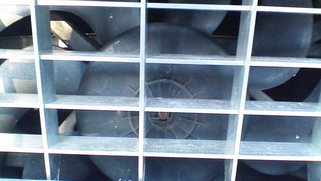

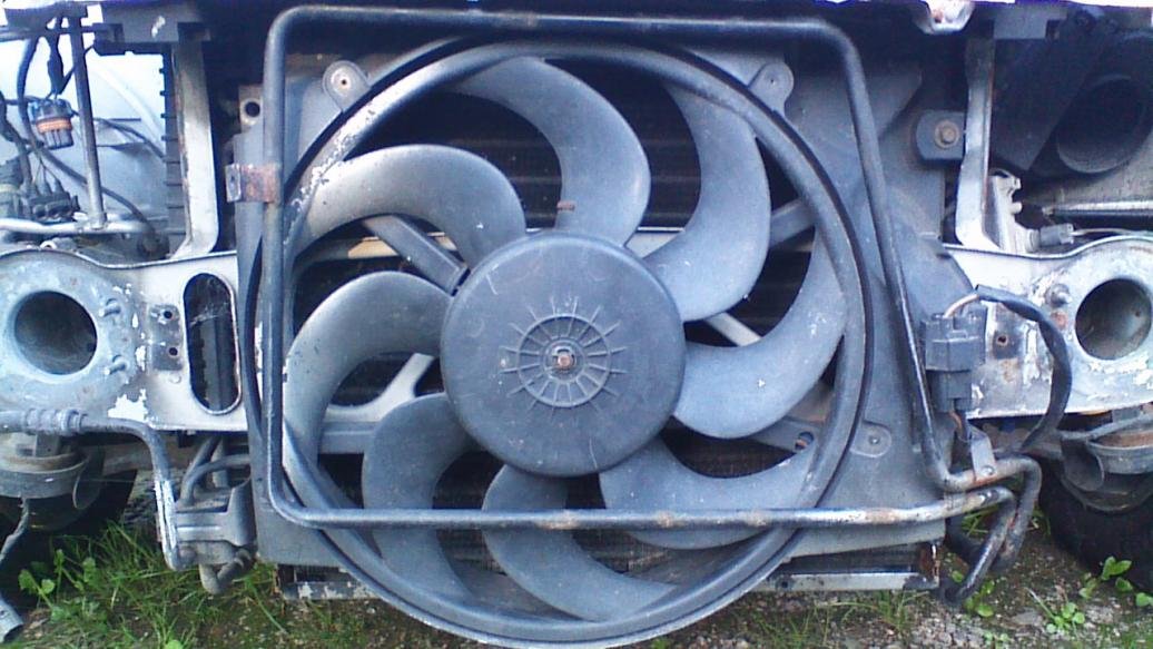

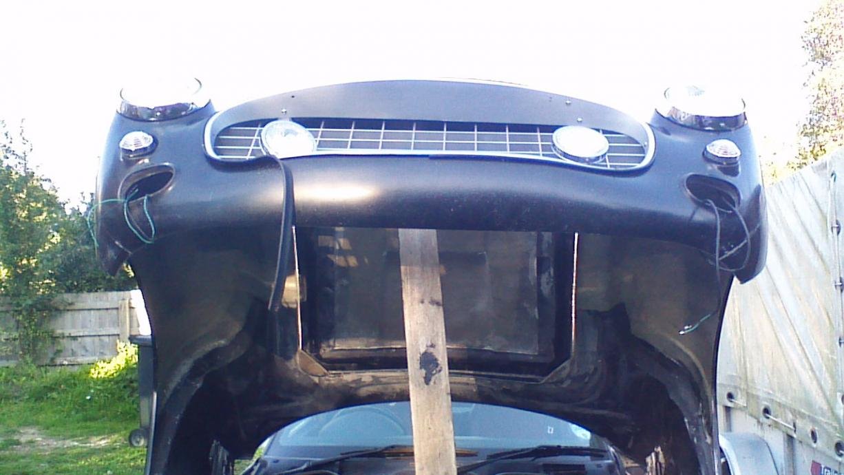

Hi I'm watching progress with interest, I tried the fan adjustments at front, as showed in your pictures and also trimmed 2cm from bottom of section as it would be behind the no plate. It still doesn't fit.....grrrr. So maybe I have a slightly longer car, will see if land rover smaller fan will bebetter. Cheers
Evening Eric ref the AC fan it is certainly a tight fit , my fan is tight up against the rad but there is clearance (just) , is there adjustment to allow the bonnet to sit slightly further forward? your car is looking good , cheers Geoff .

The details take forever, I have spent about 6 full days re shaping the back section to make it symmetrical around the hood and creating a decent lip for the boot seal which has a channel for the water to rundown when fitted, I may still need a couple of days to reform the lower edge at the bottom so that the tub is not stressed when fitted due to the bottom left hand mounting glassfibre being twisted.
It does however fit perfectly now and I don't have the issue Nubodi had with the sill or door bonnet gaps
My AC fan has the grill removed and is mounted as per the z3 with no issues, I took more than 2 centimetres off the lip though
