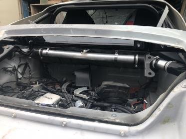

Ian@ Classic has kindly shared the following pics with me as I’m away at the moment, these show the filler pipe’s route through the boot...
[ATTACH]6278[/ATTACH
From the filler, the pipe goes forwards towards the bulkhead....

I’m away briefly but Ian@Classic has been continuing his excellent efforts and kindly sent the following pics;

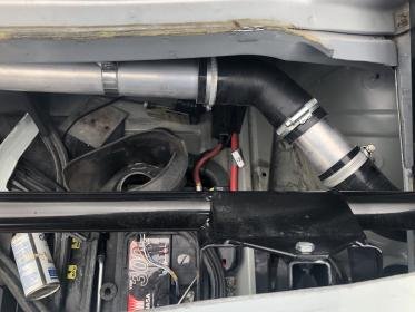

Here you can see the fuel filler pipe heads initially directly forwards towards the bulkhead...
11 Aug 2019, 4:47pm
At the bulkhead right at the back of the boot to keep the space as usable as possible it takes a 90-degree turn and runs parallel to the bulkhead, continuing its steady fall as it does so
11 Aug 2019, 4:52pm
At the right hand side a pair of 45-degree bends allow the pipe to continue to the cutout that was made previously through the relatively flat sheet metal at the side of the boot here. It joins on to the pipe shown in last week’s posts and into the tank. A continuous fall from filler neck to tank, if a little convoluted to retain the usability of the boot-space. Yet to be tested at the pumps but we’re very hopeful!
