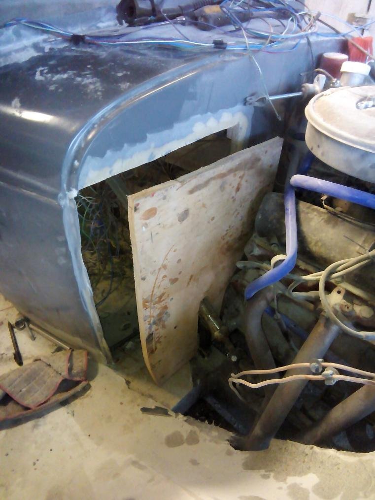

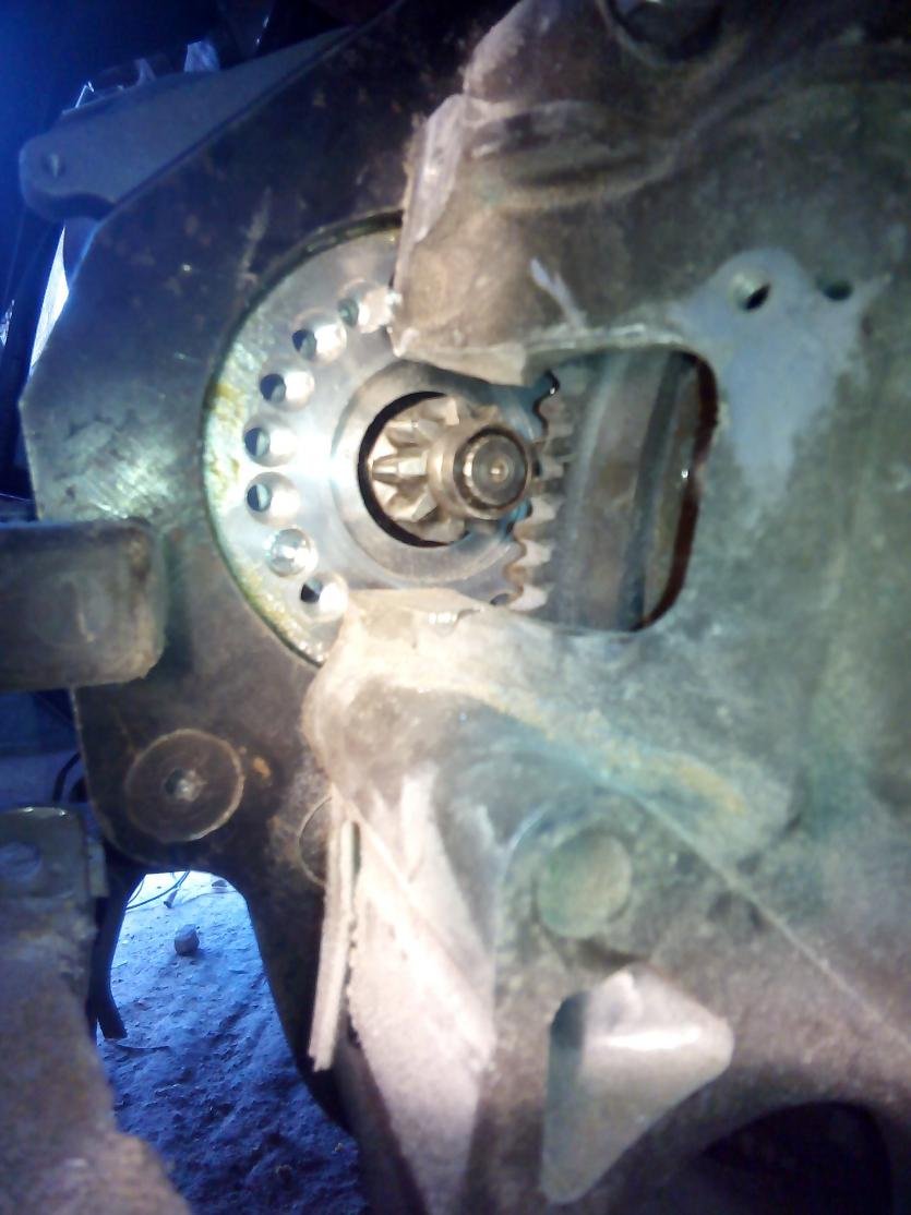

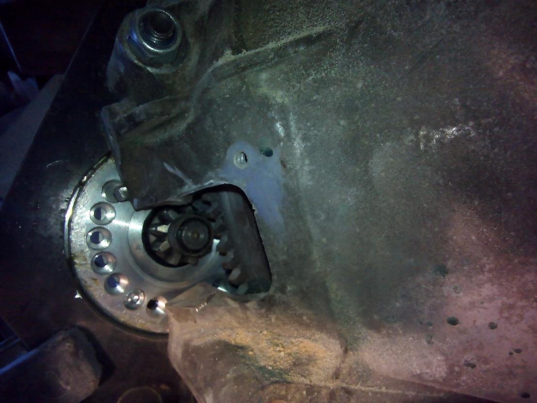

well back on rod so here we go again update time got the gearbox fitted and bought a high torque starter so I would not need to cut too much out of the Mazda box. The plate married the engine to gearbox well but the problem was the p9cyoplates adapter was miles out for the starter and I do mean miles out.
so I had to grind down the edge of the starter then re-drill the holes to move it by about 15mm good job the plates only mild steel, still took me a full day to work out what was going on but now starts off the key.

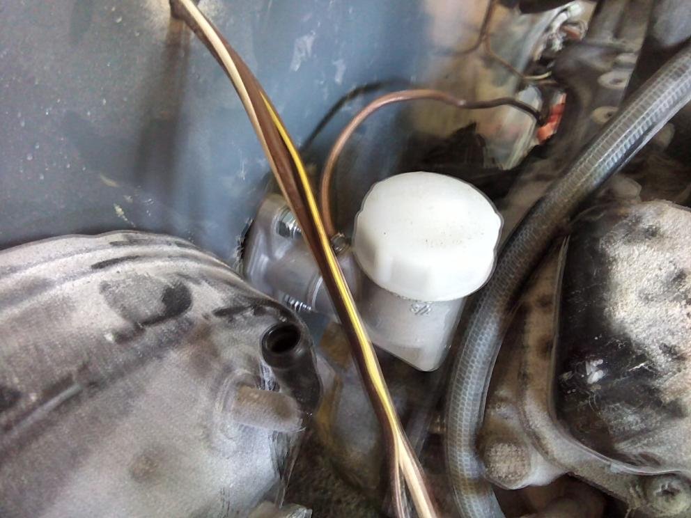

spent most of yesterday trying to bleed the mx5 clutch master servo I can not get the air out of it, had a look on the web its a known problem to bleed so I will revisit it when I stop swearing at it.

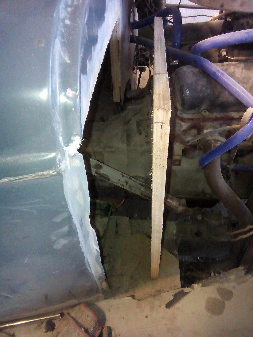

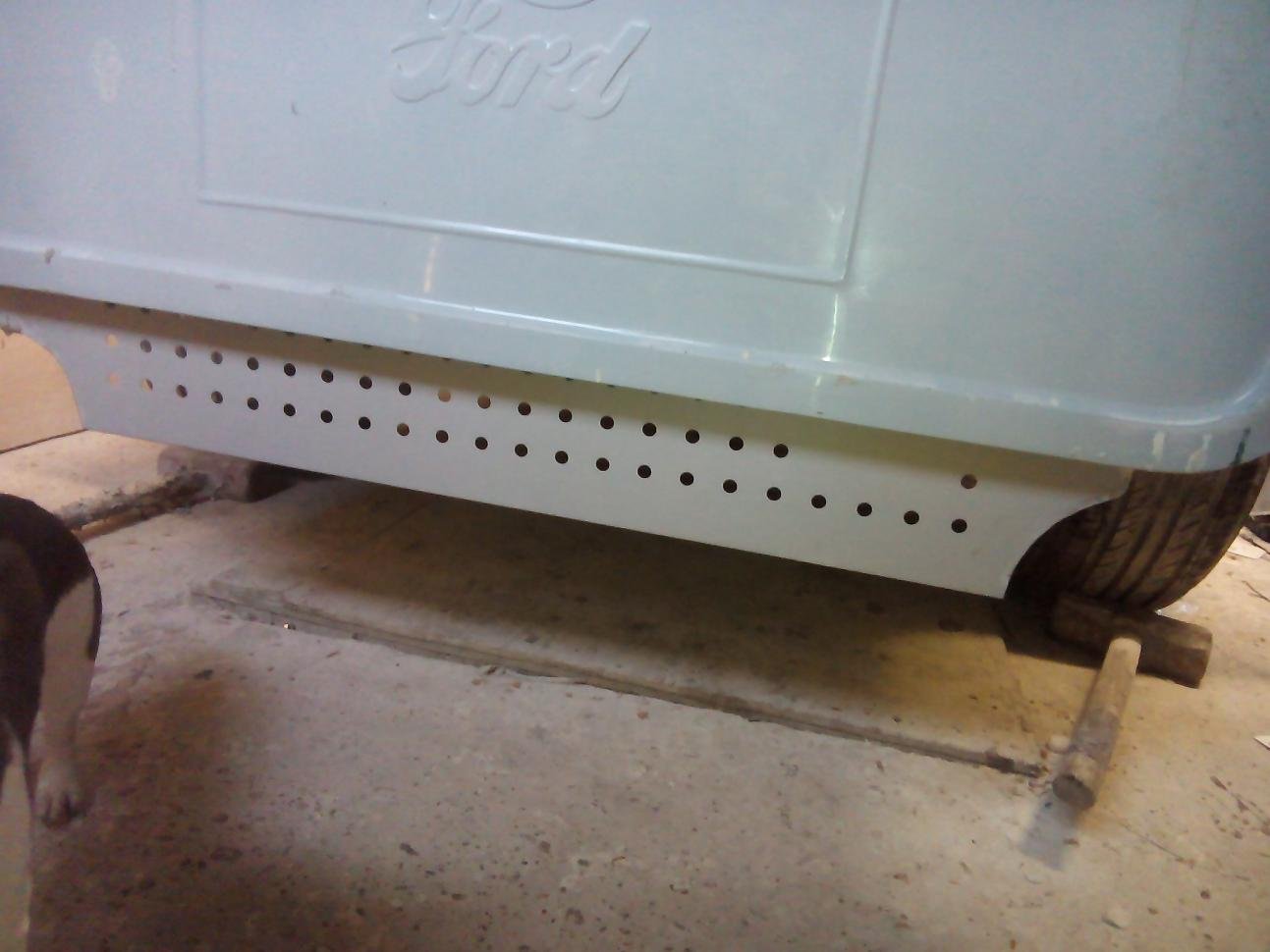

working on the body today in the sun made some changes to the sills and trimmed the back wheel arches.

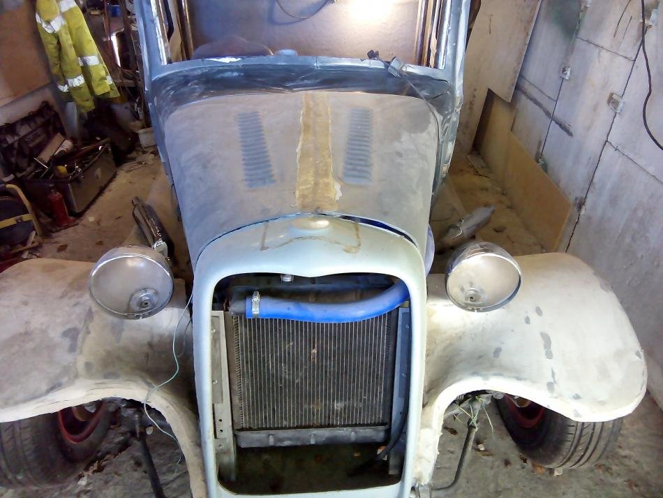

need to look at the bonnet again not happy with the fit so going to cut it up and rework it next job.

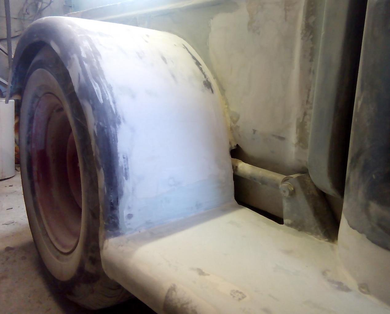

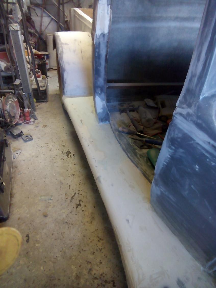

good weekend sanding and filling starting to shape up well, itching to get some paint on her.
happy I made the changes to the running boards it's going to look well cool. starting to think of adding some flames or pinstriping or what about this

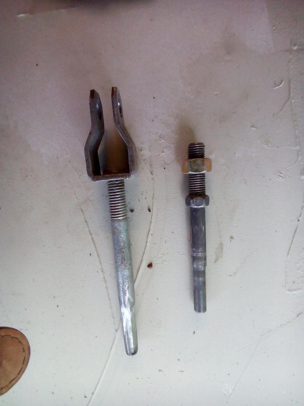

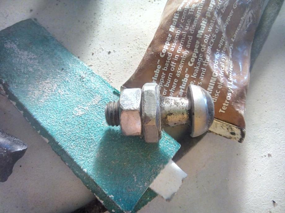

I worked out it was not enough leverage so added a nut to the back of the pivot
this worked but caused the arm to hit the clutch not a lot but to much but some clutch improvement so I removed the nut and did this
this worked out a lot better it did not hit clutch anymore but again could be better, so I extended the piston arm to the clutch master to try and get a bit more fluid
again better but no cigar so next I swapped out the mazda servo for a landrover we now have a car the moves under its own power not me pushing it

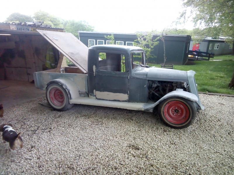

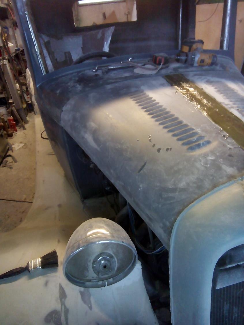

only done a few bits on the body, bonnet split again now fitts proper job just needs re finishing

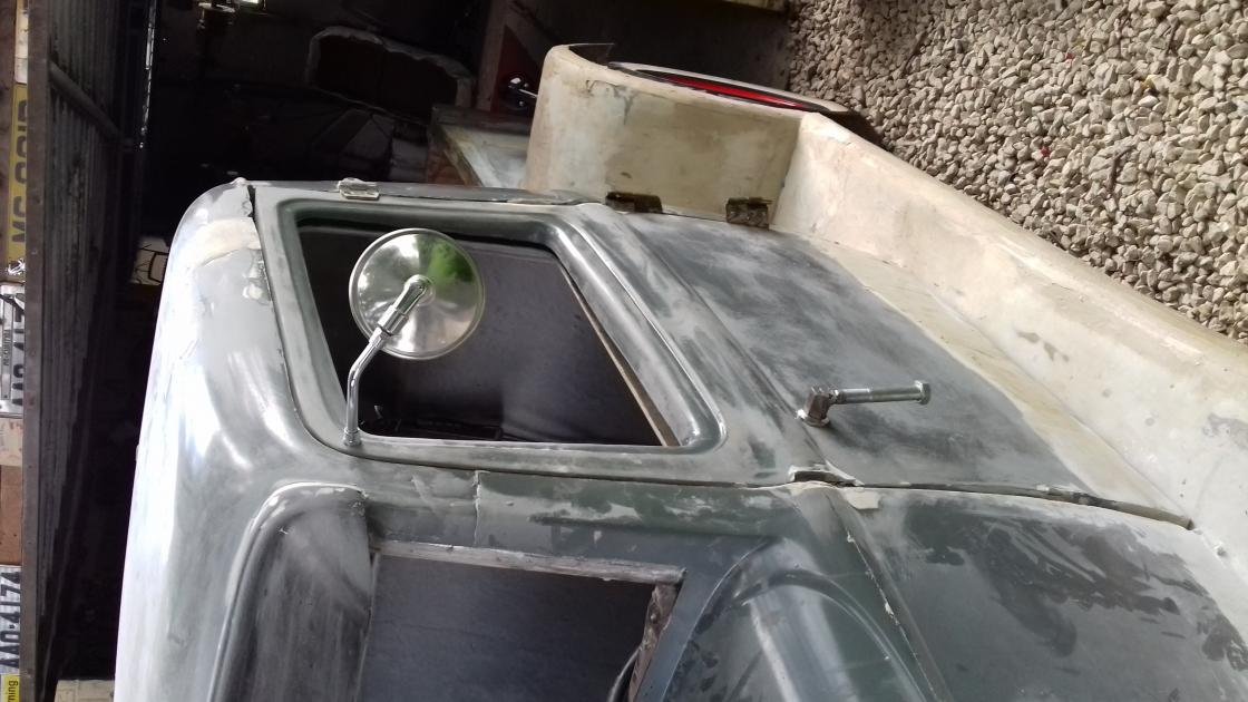

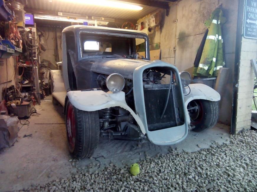

had to try the light shells
I added a skirt to the back I want to run some lights on it and a number plate.I also removed the hinges from the back door and bonded it on ,well it was never going to be used as a door and looks better
and the paints arrived so I now do need to pull my finger out

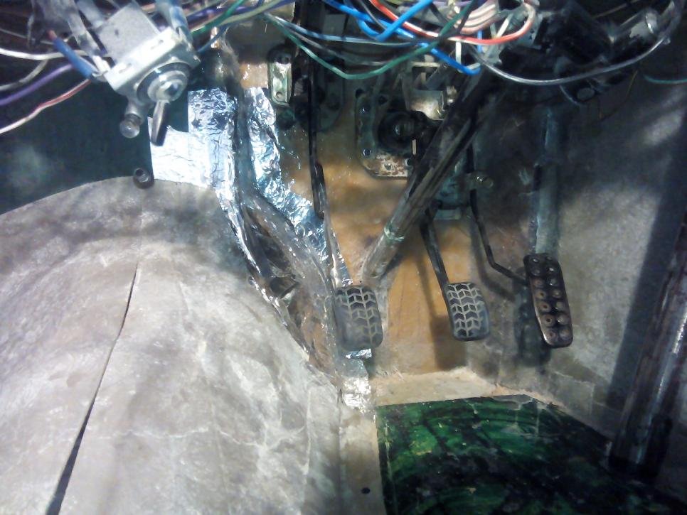

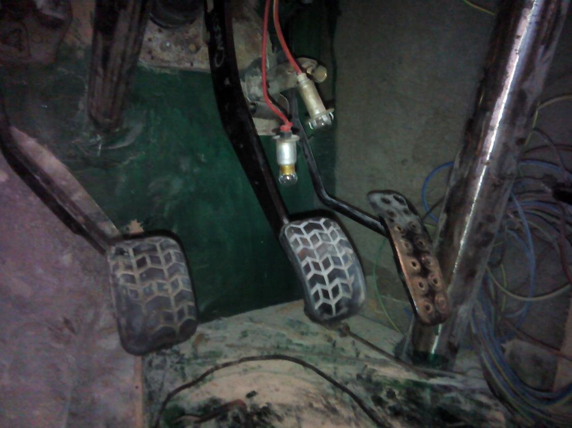

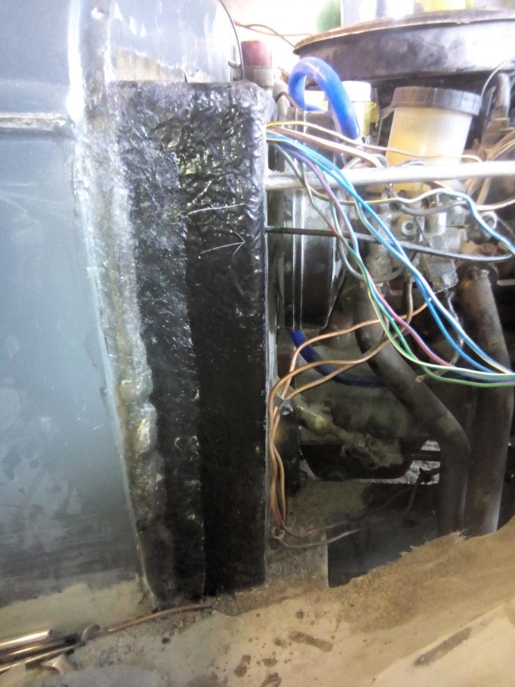

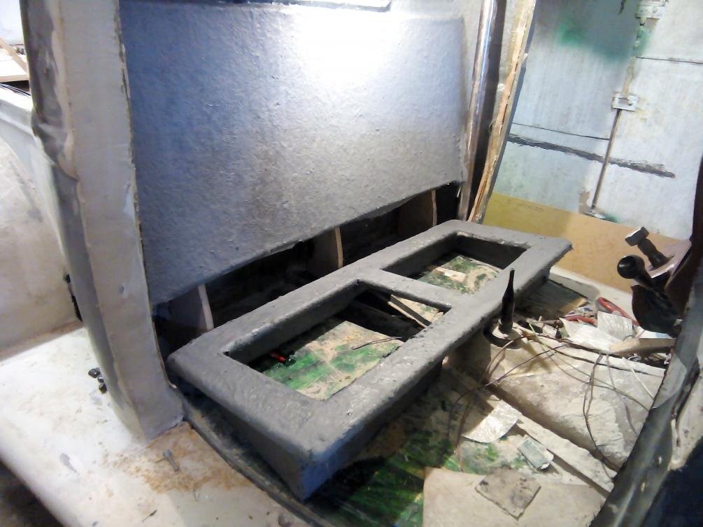

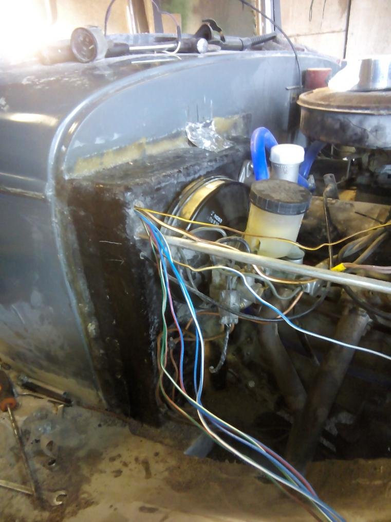

cars coming along nice I actually drove it yesterday it even stopped when I pressed the brake pedal :pray:. BUT the driving position needs work so all the pedals and the steering is back out. I have moved the steering up and right a bit sound easy but not when it's all been welded into place.
I am going to move the fire wall on the driver's side forward about 6" and lift the servos up to clear the engine
I should be able to cut some of the bend out of the pedals and make them longer, hopefully when finished it should give me more legroom and a better driving position. 1 step forward 3 back better now than later :decision:

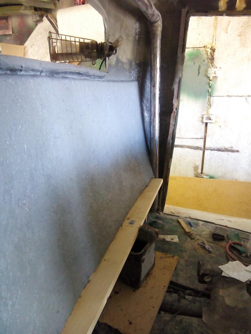

fire wall is all back in pedals refitted and all plumbed back up I have gained about 6" in leg room so driving position is better.
I had to flip the brake pipe connections from one side to the other on the servo to get it in as it was a bit close to the exhaust. hindsight I should have made the box higher.

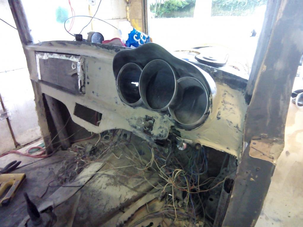

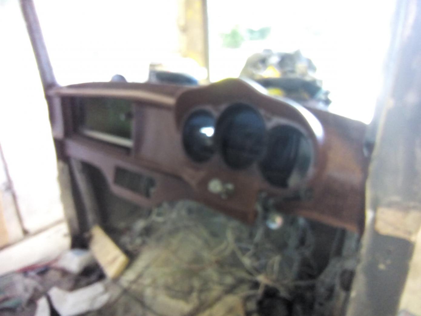

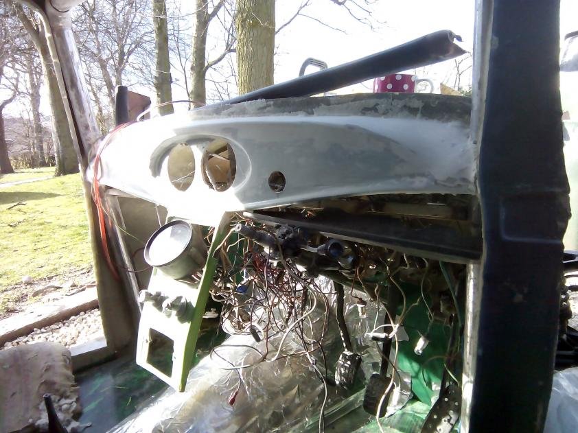

I also decided I did not like the dash so the had to go
new dash in or should I say in progress
The clocks are RX8 which means the electric drive from the gearbox should work for the speedo, glove box from the old scimitar

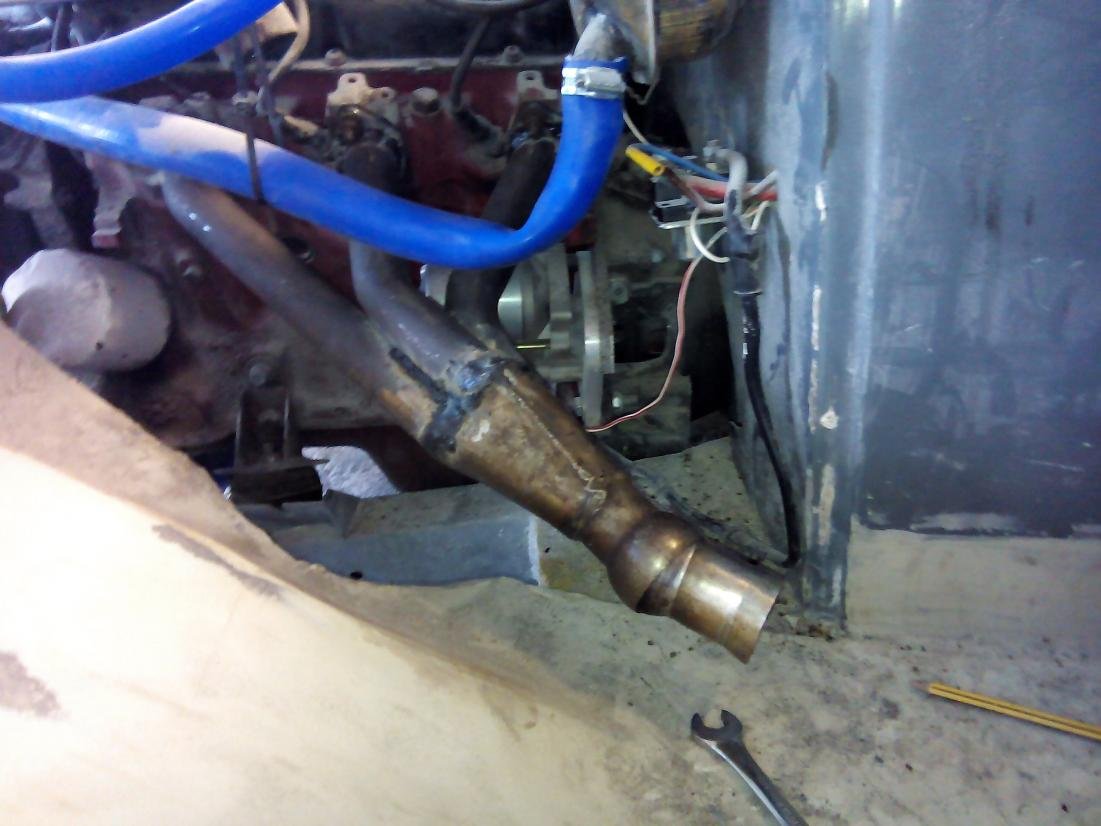

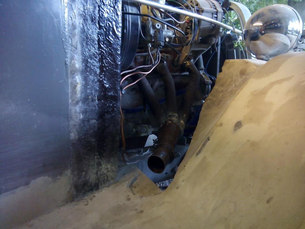

been fancying a side exhaust so this weekend I cut up what was the manifold and made everything shorter and to come out above the running boards
I did plan to use motor bike silencers but now I am thinking of a bit of flexi tube and a side exhaust running along the side of the running board like you see on the cobra.think rat look bit of rusty pipe running across the board would look mean. lol

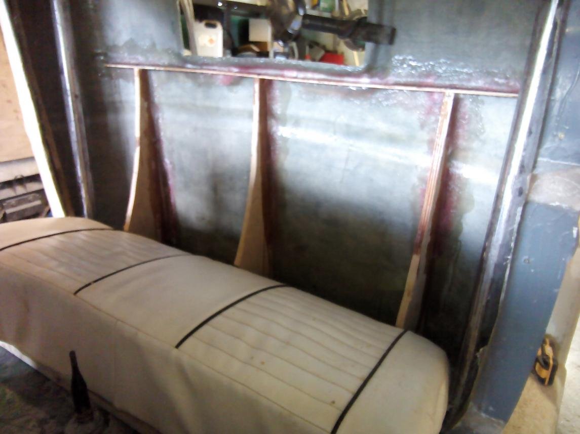

well I got fed up with sitting on a box and moving it from one side to the other as I worked on the dash, so I decided to get the seat in
still work to do as always I have made the base to be removed as and when the back is glassed in. I did try the back from a VW beetle but it was taking up to much room. I have got a padded quilt cover with the american flag on going to look well when its fitted.

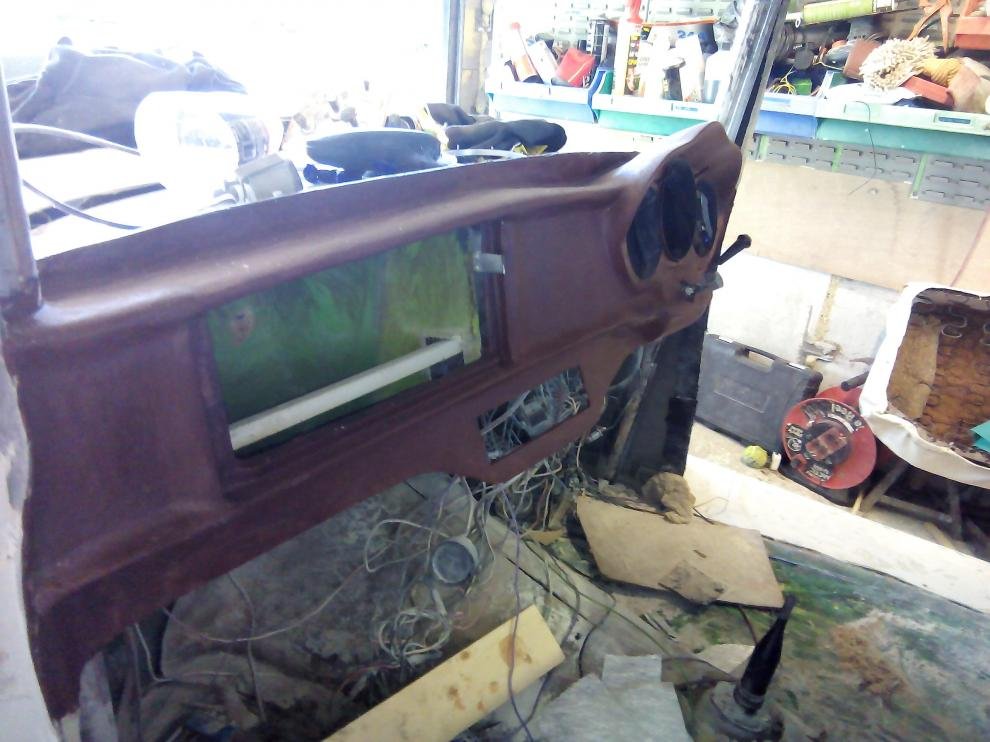

bit premature but had to try a bit of paint on the unfinished dash love the colour it goes on well even with a paint brush :peace:

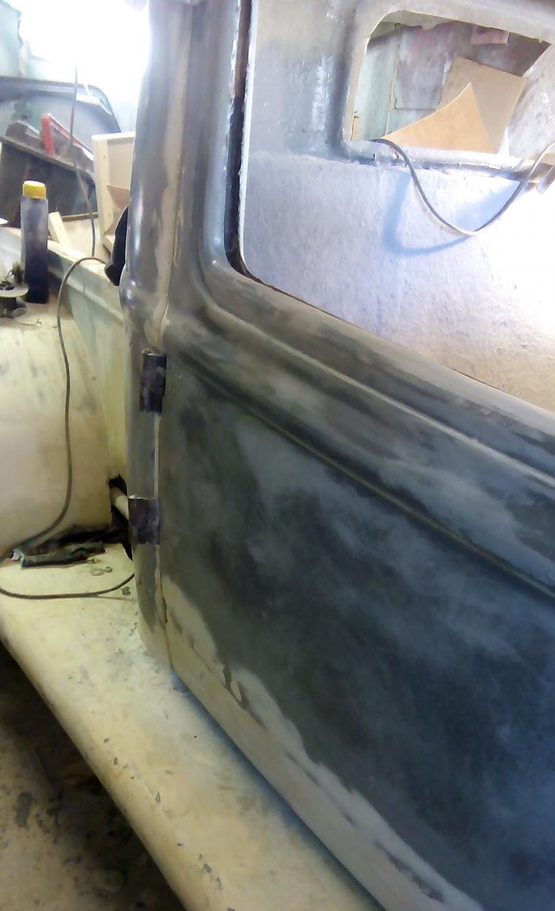

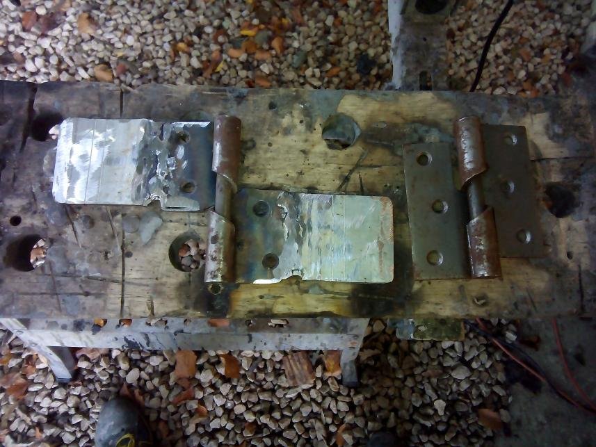

I will stop changing things one day and finish it , been watching welderup again and decided I could not live with the standard door so gone for the suicide look again.
absolute nightmare to do when I cut the body I did it on a slant thats ok till you try to flip the door hinge then it will not open it just slams into the sill.
in the end after 3 days on I came up with this
three hinges top one fixed bottom two lift clears the sill and shuts spot on, locks on order that's next weeks job.

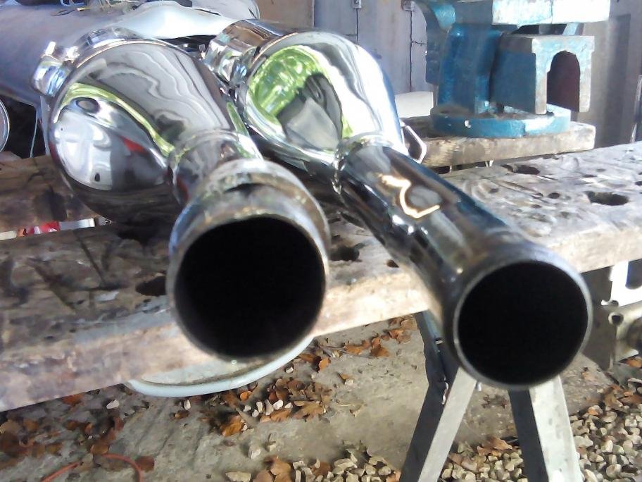

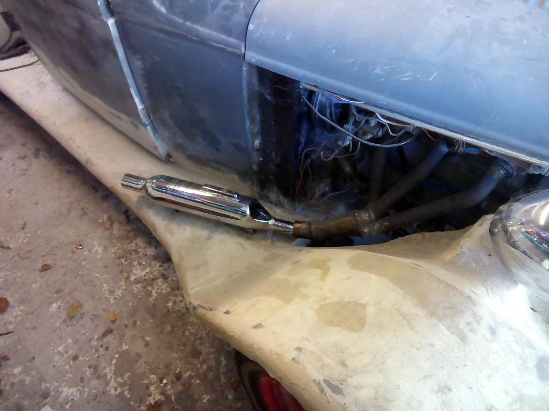

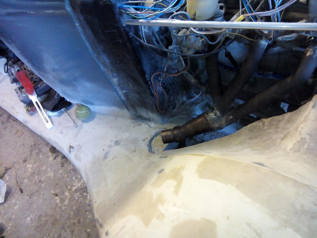

bought some triumph silencers just hoping they will work may need to take the baffle out . bore is only 30mm the down pipe is 40mm so I needed to make a filler . que scaffolding tube
and finished looks like this
fitts a treat bit of joint compound and a clamp job dune , need to think about securing the box to the sill so it will move with the engine .

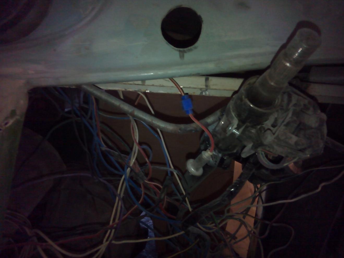

wiring loom on order I have spent hours trying to get the loom sorted for 80quid should have bought it weeks ago u live and learn:icon_eek:

still plodding on with the hotrod most of the wiring is now sorted we have all working lights and it starts and runs on the key and even drives . Utube link below would not let me add a video

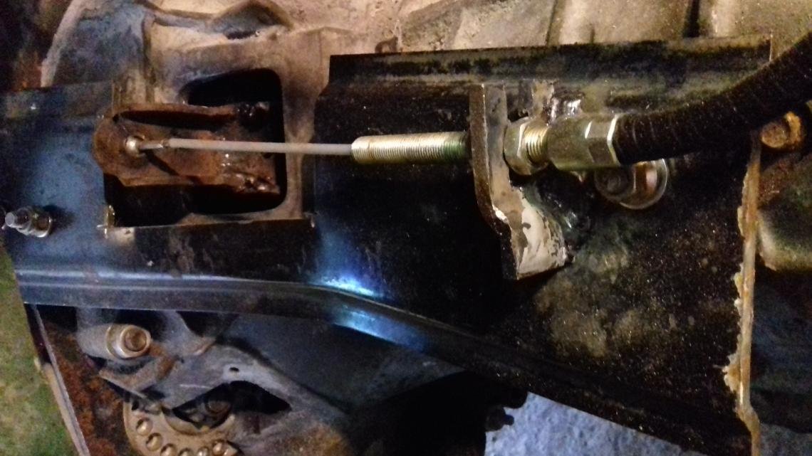

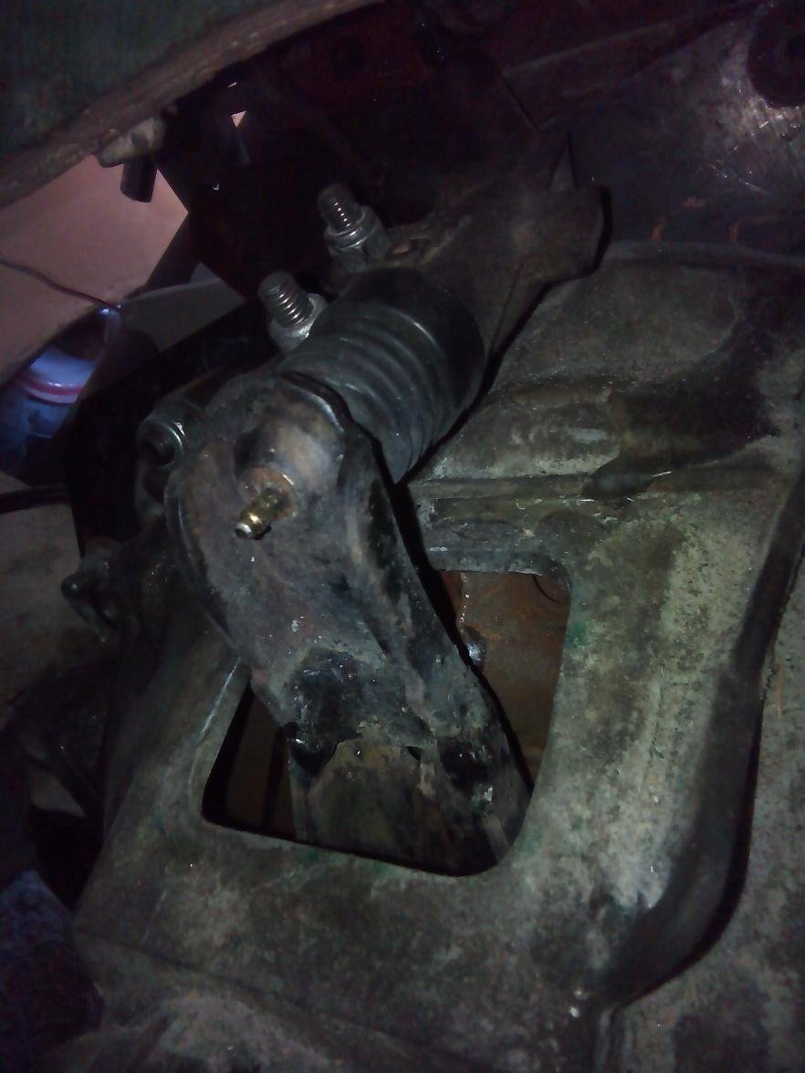

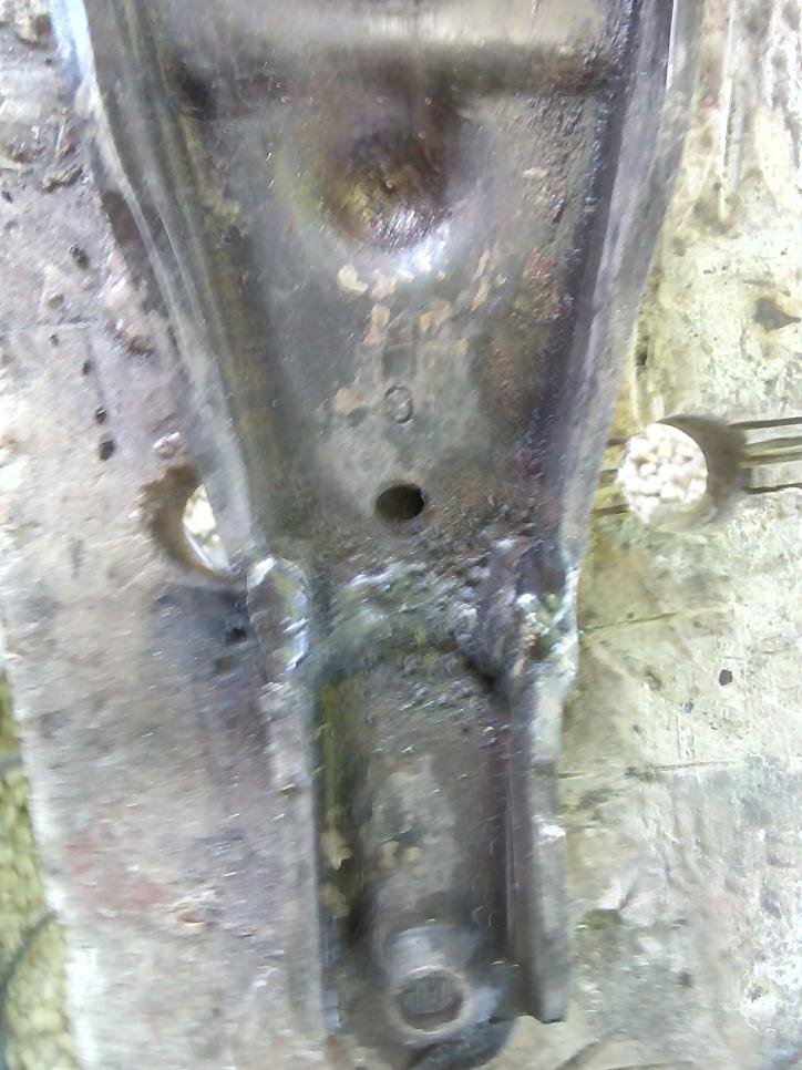

the clutch is pants only just biting and the gears are stiff so I dissed the slave and just used a monkey wrench off the clutch leaver and a bit of rope. all gears fine but only biting at the very top so looks like the clutch is on its last legs but the slave has to go.The piston on the slave dose not travel enough both ways to work the clutch properly.
so next job fit a cable clutch ebay new cable 8quid and a bit of old cross member I came up with this,woks grate but will still need a new clutch bugger.

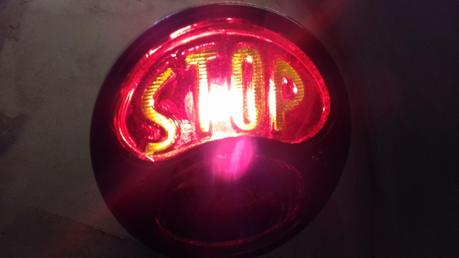

rear lights from the states

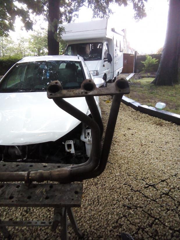

exhaust next week I have bought two newish manifolds I am going to direct it under and out the side well thats the plan.
