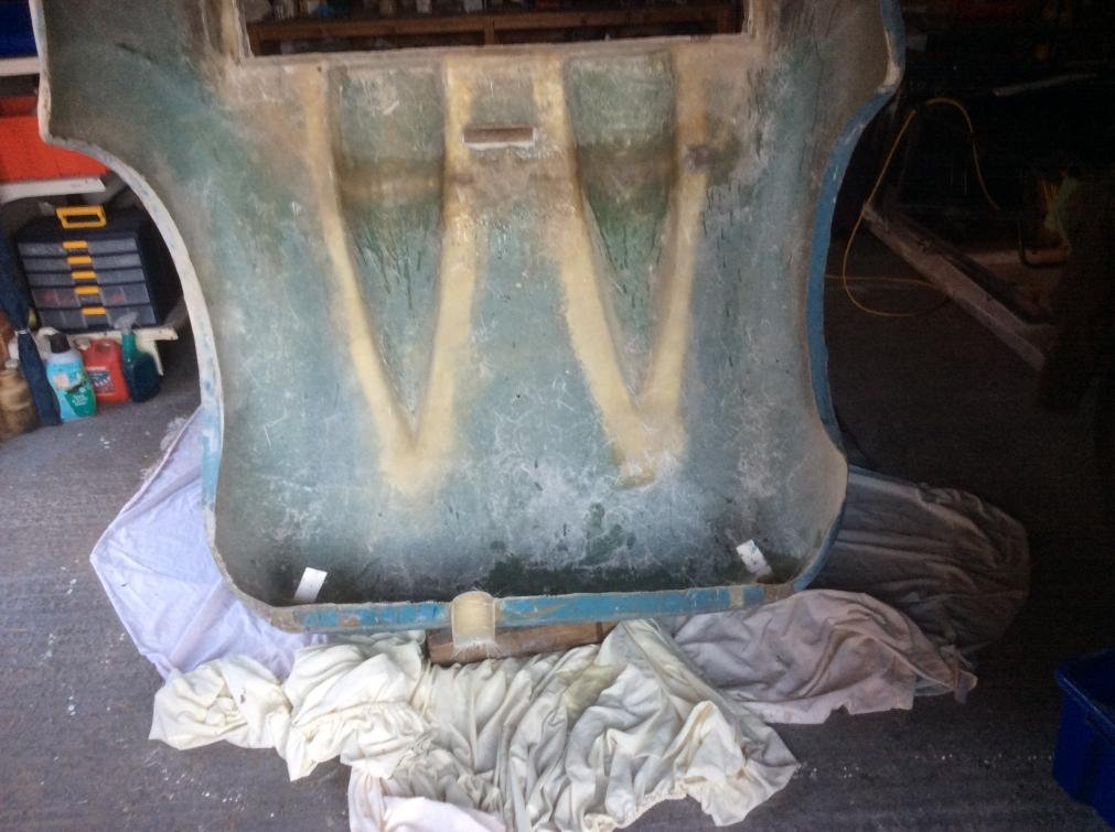

Grateful for all the answers above and I am now able to add some photos which summarise my progress to date.

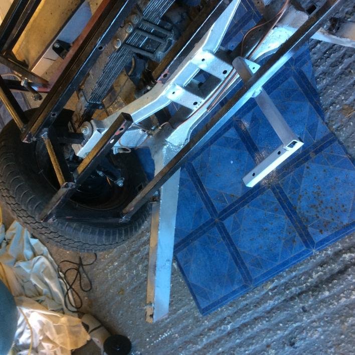

First shows the shorter, Sammio outriggers and bracket to support the exhaust system.
Rear lip after major surgery and with slots for the seatbelt buckles.

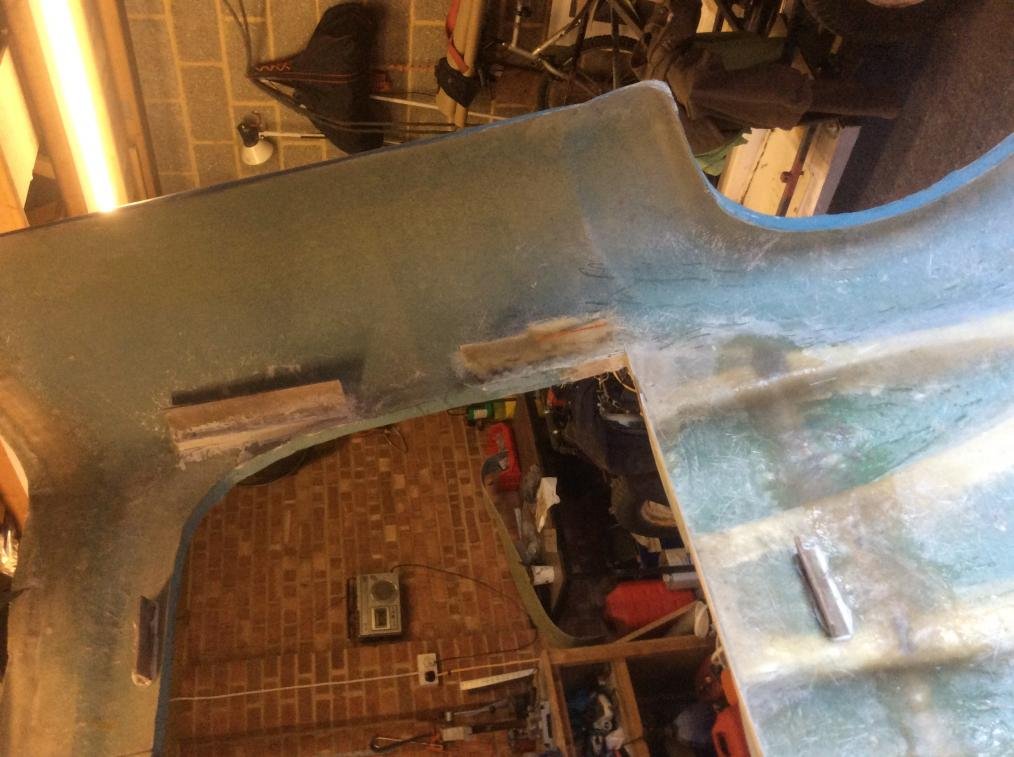

I have bonded some webs into the top of the shell so that I can bolt these through the frame when the body is in situ. Including a couple at the back which will be bolted through the outriggers.
Side and front webs.

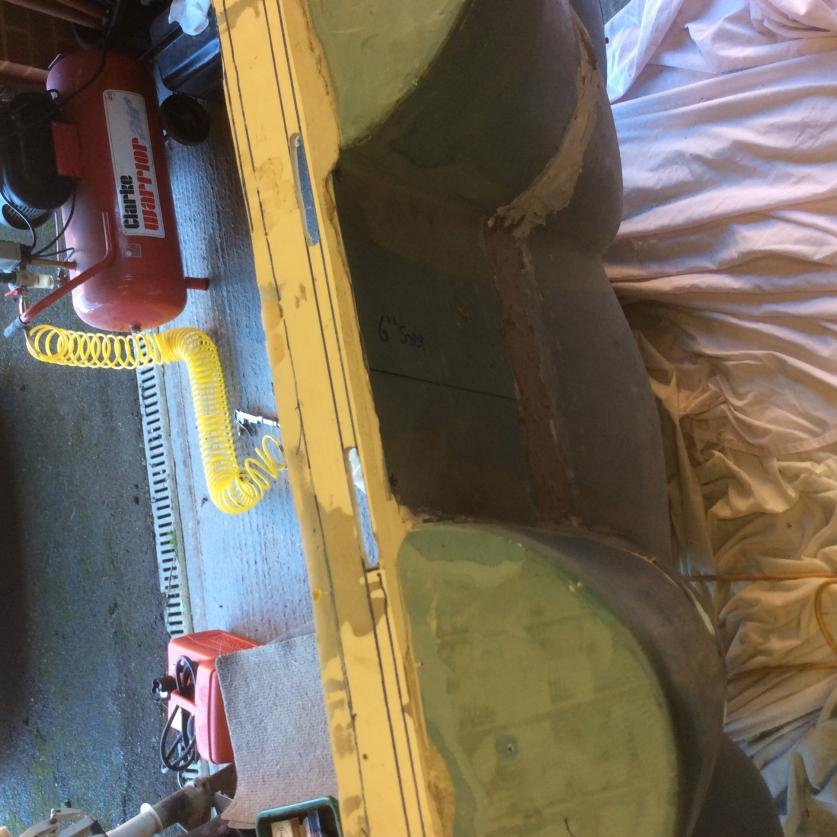

Not a very clear shot but trying to show the major hump surgery that I decided needed to be done.
15 Dec 2014, 5:14pm
CJ - Good to see some photos. :cool:
Was the major hump surgery to align them with the seats?
15 Dec 2014, 7:24pm
Hi Paul,
Considered hump surgery to align with seats but could not work-out a solution that would have looked correct. Probably why Gary put them where they are in the first place!
But a straight line across the front of the 2 humps was nowhere near perpendicular and the cockpit edge in way of the humps was very rough. So I thought that I would 'kill 2 birds....' but it involved quite alot of work.
Other problem is that the passenger hump is somewhat shorter the the one on the driver's side. So that still needs attention.
Chris

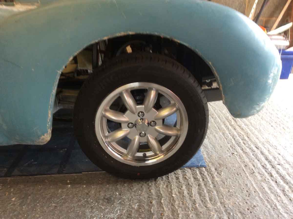

5 Apr 2015, 3:00pm

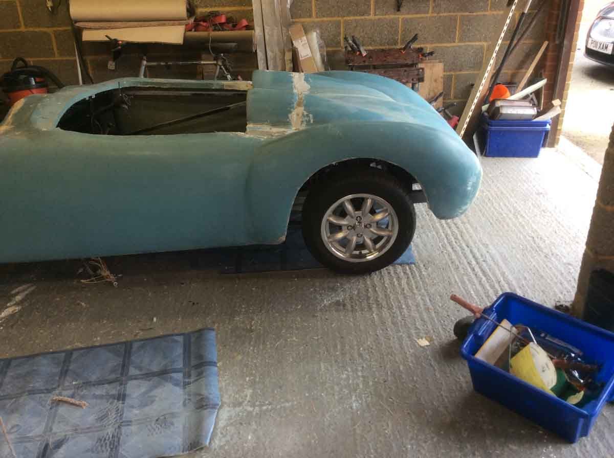

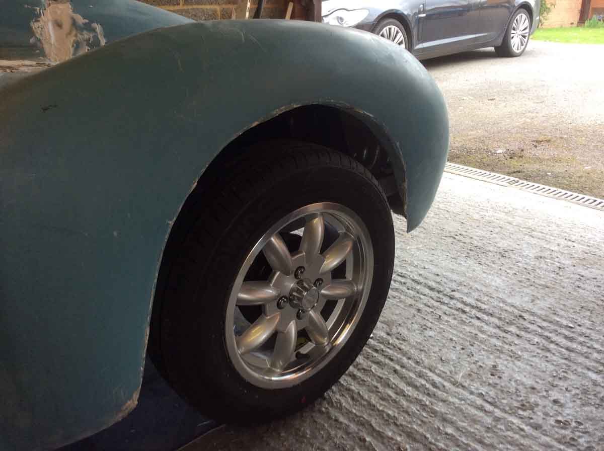

Have just fitted my brand new 14" alloys and put the body in-situ.
Now to decide whether I need to adjust the wheel arch to decrease the gap between tyre and arch.
Looking at other cars I think that it would look better if I did some surgery!
Chris

Chris – Nice wheels. :cool:
I’ve got a similar set, but in 13”, that came with my donor.
At some point I think I will have to adjust all four of my wheel arches too.
11 Apr 2015, 5:18pm
Thanks Paul,

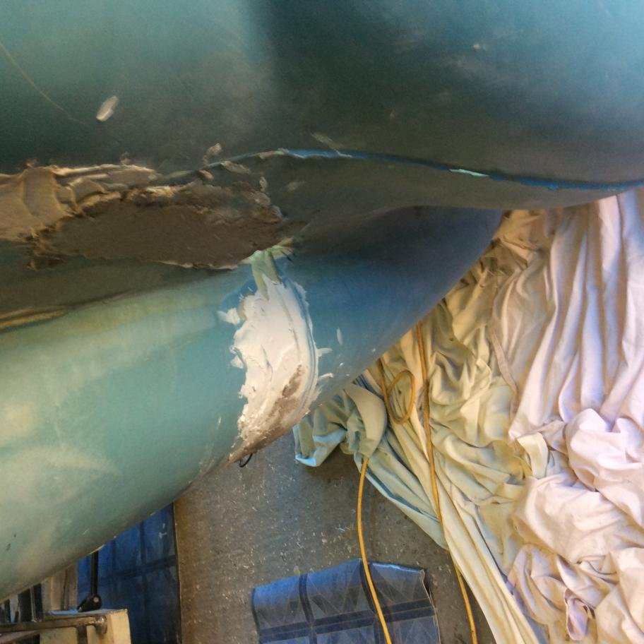

The wheels do look nice but I have decided to do some wheel arch modifications.
So 10 minutes with the grinder and the familiar cut & shut work starts again. This is the near side positioned today and will now do the offside before getting everything glassed into place.
Attachment “sammio.jpg” from the original forum could not be reliably recovered.
Chris
11 Apr 2015, 6:15pm
That's done the trick.
