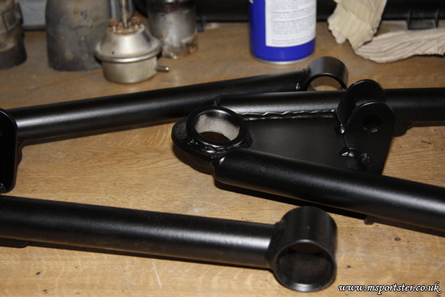

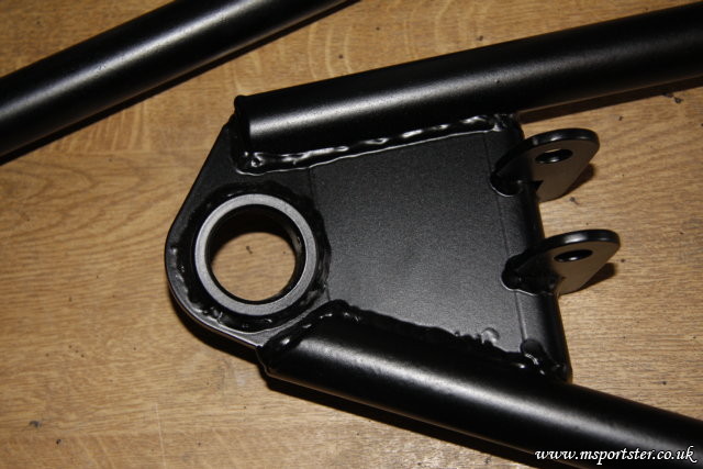

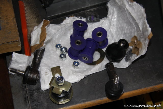

I'll post some pics of the wishbones tomorrow, new design has address the potential week spot that the old ones had. Surprisingly a set of powerflex poly bushes was in the box! They look good!

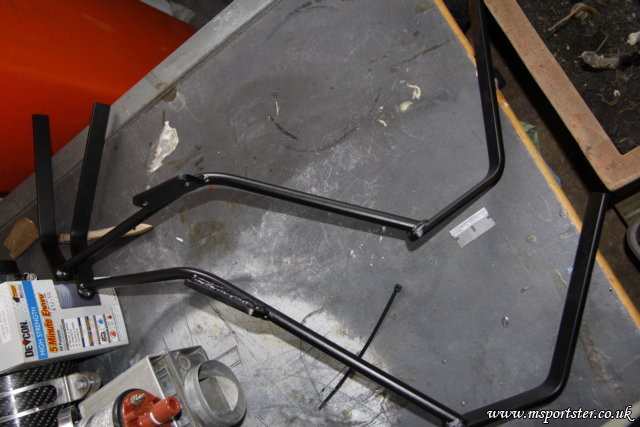

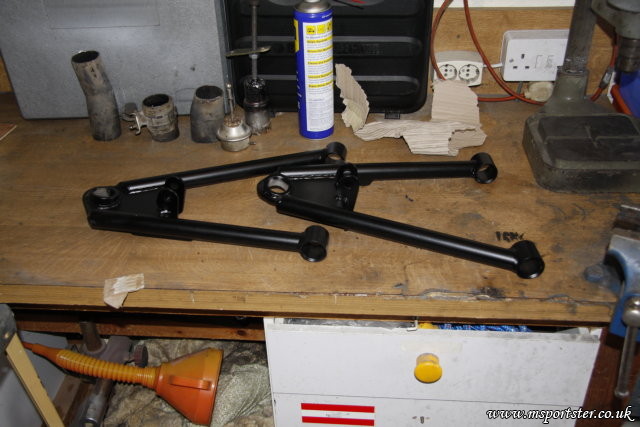

As promised here are pictures of the parts supplied:
22 Mar 2008, 7:34am
Hi Patrick.
Looking good mate.
They look like the same lower balljoints as the 5EXI lower wishbone's.
22 Mar 2008, 9:35am
Thanks for posting the pictures Patrick. Both the wishbones and wing stays seem to have a much better design (To my non-expert eye) than the ones I have. I shall hopefully be getting my replacements soon once Marlin have completed the move to the new factory.

I'm sure that the ball joints are the same as on the old ones.
22 Mar 2008, 10:57am
Those wishbones are exactly the same as mine. Good luck getting the damper bolt in! :)
If you remember, I had to shave the head of the bolt to get it in:

Patrick,
Great too see you've finally got your replacement parts back after all this time. :smile:
Interesting to see that Marlin are now suppling Powerflex bushes as standard rather than those old rubber Ford Fiesta ones.
I've got some Rally Design Polysports for the lower arms but haven't decided whether to fork out for a set for the top arms as well?
hmmmm...
like GOO's, no ARB brackets?

I've been asked to pay for the bushes ....

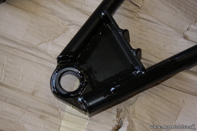

I have today been working on the suspension of my Sportster and have noticed my nearside wishbone is bent and the powder coat is cracking right along the joint that Patrick's snapped. I have mailed Terry and await a reply i iwill keep you informed of progress.

I'd be interested to see some close up pictures of the issue before you return them to Marlin.
