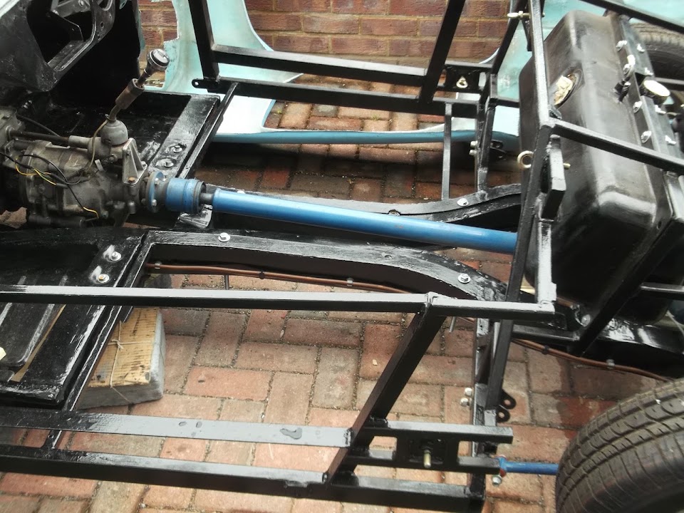

First job was to remove the body shell and then the rear framework so I could paint it.
There are a few bits left to paint on the frame, but I need this side to be dry, so I can flip it over.
With the framework out of the way I turned my attention back to the chassis.
I had bought a heavy duty 19mm drill bit which was marginally smaller than the crush tubes.
After expanding the 4 holes I'd already drilled in the chassis, I switched to a hand file for the final bit.
This gave me as close to a friction fit as my manual tools (& skills) would allow & all 4 tubes were in.
I marked the tubes and cleaned up the metal where I was going to weld them.
I also cleaned up the holes on the chassis & it was nice to see shiny metal under the paint. :cool:
As the rolling chassis is parked on a sloping drive, it is not easy to see what is straight.
So I used a "L" shaped ruler to keep the tube perpendicular to the chassis when I was welding it.
Don't ask me how, but I managed to blow apart the welding tip's shield. :rolleyes:
Thankfully I had a spare, so soon all four tubes were welded into position.
Then I cut the tubes off with my angle grinder before cleaning up the top surface.
A quick spray of etch primer over the top completed stage one of this chassis mod.
I still need to drill 4 holes in the bottom rail of the chassis through these crush tubes.
At least by doing it this way mean I know the holes will line up. :icon_wink:

Still Chipping Away - Part 1
I test fitted the floors to the frame so I could mark up and drill the holes for the pop rivets.
The first thing I noticed was that one of the holes I'd drilled on the driver's side floor was not going to work.
The position of the cross frame rail leaves a gap from floor to frame.
With the floor removed it is easy to see the slight drop in the "factory" set up.
Whereas the new passenger side section that I welded in sits flush.
( Surely luck, rather than judgement. :rolleyes: )
So I simply drilled a new hole in the floor a bit further inward.
( The gap will be filled by the bonding paste, so I'm not going to worry about it. )
With all the other holes required marked up I could start drilling the frame.
I stuck the rivets in just to make sure that the holes in the floor & frame lined up.
I will be bonding the floor to the frame, so the rivets are just going to help hold everything in place when the time comes.
Then I cleaned up the chassis ready to put some paint on where the frame and bulkhead will sit.
This was the overall view "before".
The rear bulkhead mounting point.
The front bulkhead mounting point.
Dare I say the previous owner had left a bit of over spray from the body shell on the chassis too.
After a coat of Hammerite smooth, the whole thing looked a lot better. :cool:
While the paint was out I touched up the floors where I was drilling the holes.
I also got to finish off the last bits of the framework.
End of Part 1....

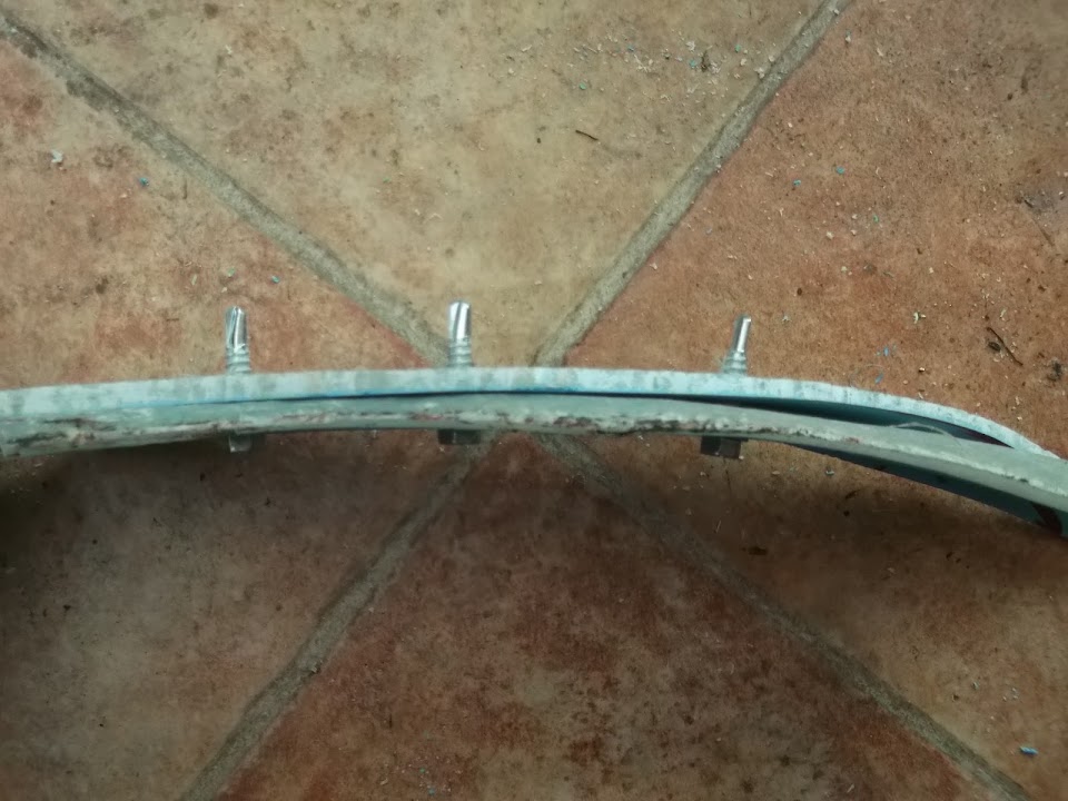

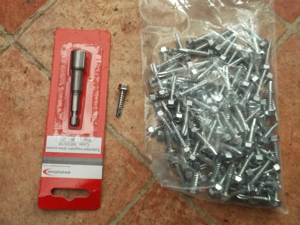

Another recent Ebay purchase was a bag of self tapping Tek/Tech(?) screws that came with a matching drive socket.
I hadn't picked up on the fact the socket has a magnetic head, but that makes using the screws so much easier. :cool:
The first job for this lot will be to fix the outer door skins back onto the body shell from the outside.
Which will allow me to cut away the rest of the door opening lip and fibreglass them into place from the inside.

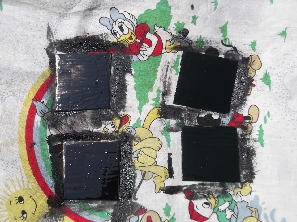

But as I've never done anything like this before I decided to do some experiments with some fibreglass off cuts.
So I drilled a few holes.
Using the screws was very straight forward and they certainly hold everything together nicely.
I know that there will be a lot of "cutting & shutting" required when I start on the body work which is quite daunting for me.
However, I do take comfort from the fact that lots of other builders have done this kind of work before.

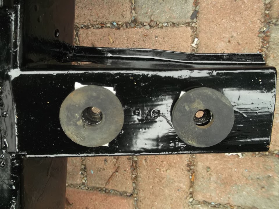

Next I added some rolled up masking tape to my rubber washers.
That way I could "stick" them to the chassis while I tried to but the bulkhead back on.
( All my previous attempts at doing this myself have ended with these washer all over the place. :rolleyes: )
I managed to get the bulkhead into position without scraping the new chassis paint.
Then I bolted the bulkhead into place, although some bolts were more of a pain than others. :rolleyes:

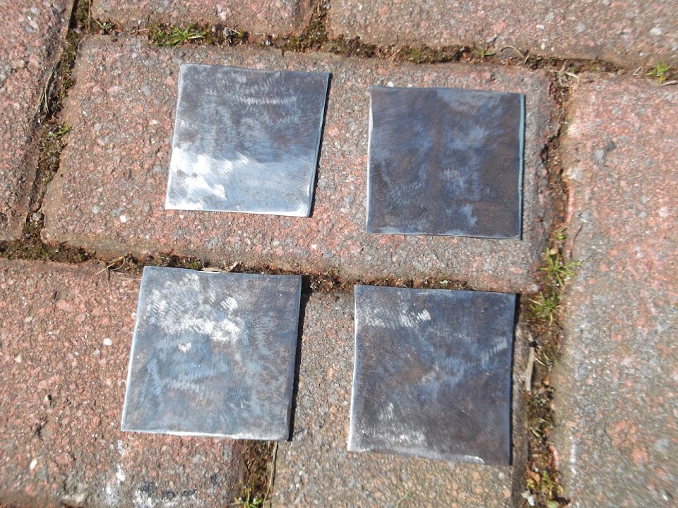

This is how the "washer" sits on the inside of the wheel arch (I will be painting it).
I tightened the bolt through the arch to the point where I could just about move the "foot".
I used my trusty set square to make use the box section was at the right angle.
Then I tack weld all the pieces into place.
Before removing the bracket completely to finish off the welding.
There was just enough time to get some etch primer on and leave the bracket to dry on one of our wheely bins.
I also got some primer on one side of the wheel arch washers.

So I simply removed the rear wheel arches.
This section will now return to the back garden which will make it easier to finish off the last bits of work required.
( Mainly the fibreglass repairs of some of the rust "gaps" at the base of the arches. )
Then the rear framework went back on.
I then used the fixing bolts to hold the frame in position.
( These bolts will be cut to size after all the layers of the "sandwich" are in place. )
With the bulkhead already bolted into place, I could now make a start on the "join".
I quickly bolted the two recycled "plates" into position.
The lower door hinge mounting point should be the easier of the two to secure.
I will either weld some box section to the middle of the plate like so.
Although I will need to do some trimming to take account of slight angles.
The alternative approach to this would be to run the box section along the bottom edge.
Again, there would be some trimming required to ensure everything sat tightly.
The top hinge mounting point is a bit trickier as the top of the rear framework is below the hinge.
Running the box section below the plate would work.
But I may have to put a "slit" in the end of the box section so it would pass either side of the framework.
I could also fix the box section to the top of the rear frame.
Then I would need to either drill a hole for the lower bolt to pass through, or just use two bolts, instead of three, in the join.

Given how often I've had to remove & replace the body shell recently, I was getting more worried about this crack.
This was caused by cutting out sections using straight lines instead of curves. :rolleyes:
So I cut down one of the sections of fibreglass that I had used to test the tech screws.
Then I drilled a couple of holes and used it as a brace which I hope will help stop the crack spreading.

One thing I noticed after bolting the frame to the chassis is that the outer edges of the frame look like they "sag" a bit.
I assume that the frame work should be roughly level with the bulkhead.
Which meant I needed to prop up the frame a little bit (less than 1 cm) to take up the slack.
Question
Should the frame actually be left at the "natural" angle that it wants to settle at?
Or should I put it under some upward pressure when I am bolting it to the bulkhead?
What I don't want to do is to stress the framework in any way that might lead to a failure of some sort.

Paul, if its sagging already its only going to get worse, I would reinforce so that it stays in the position you want it in.
Mac
11 May 2014, 9:23pm
Mac - The plan is that the "join" I'm building between the frame and bulkhead will fix everything into place.
So once that is completed, nothing should move one way, or the other (touch wood).
But I just want to make sure I have the rear frame in the correct position relative to the bulkhead before I start welding.
Obviously this would have been easier to explain if I had taken proper 'before' and 'after' photos. :rolleyes:
So I will take some better photos next time and would be grateful if you could let me know what you think.
11 May 2014, 9:31pm
Paul it may pay to check using a straight edge from one side of the frame across to the other to see if the frame is sagging OR is the bulkhead twisted up over. If the frame is sitting down a little i would either cut the frame and re weld onto the chassis or cut three sides of the frame box section and realign and weld the split up.
Basically what i am saying is find out first where the problem is and work from there.
