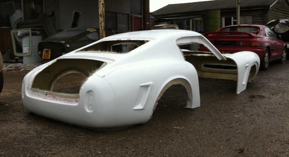

mobilerobbie wrote:

Hi Rob. Here are the main sections of your first SWB kit, smaller panels ready tomorrow:

Chris and I am guessing Dan, these look absolutely fantastic. If/when I finish the MX250 I am definitely doing one of these!
Well done!

chris, all followers must conclude now that you are doing an amazing job!!!!
Look forward to collecting the 3 kits next week.
My staff cannot wait to get their hands on the kits, the rolling chassis are all waiting!!
That's one cool looking body, had a quick look on tributes web site but no info, does any body have an idea of the cost for the shell?
