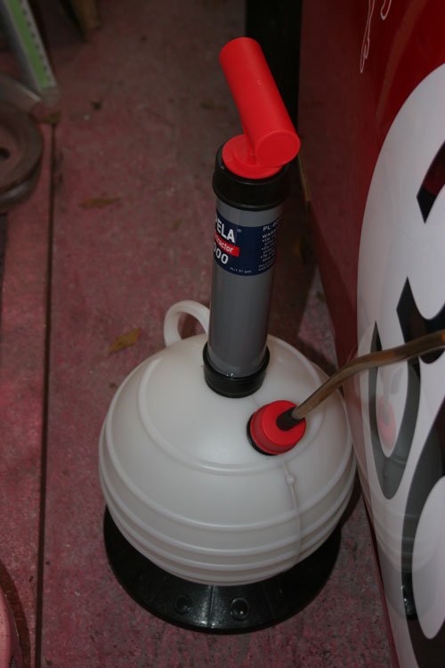

Decided to do a little maintenance over the winter and after a lot of online searching for a solution to a poor gear change between 2nd and 1st in a type 9 box i went for the easy solution first by changing the gearbox oil. One problem is there's no drain plug so without removing the box i had to buy a suction pump which worked better than expected.
Oil advised to use and manual suction pump.

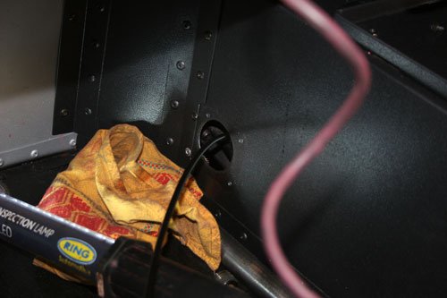

Small inspection plate removed to gain access to level plug where the oil was sucked from.

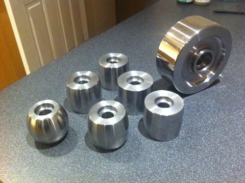

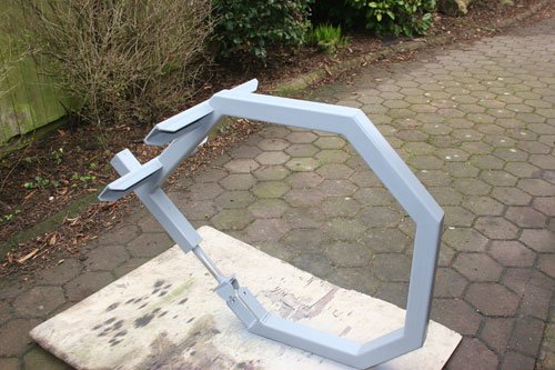

Also been busy fabricating an english wheel from 60x60 mild steel box section and turned the top and bottom anvil wheels from EN8 which ive had hardened by a specialist heat treatment company.
60x60 box section frame cut to angles then welded to make a horse shoe shape. Top anvil wheel mount is fixed while the bottom anvil wheel is adjustable depending on material thickness. Sorry for the upside down frame had just finished the undercoat.
The top anvil is the larger one with a parallel od surface, if i made this again i would leave more material on the center boss to minimize distortion during the heat treatment luckily the internal bore shrunk out of true so i was able to machine it back to size and true with the outer diameter. The six smaller wheels are the bottom anvils with various radius's on the o/d to accommodate different amounts of curve required. All anvils have internal bores for the bearings.

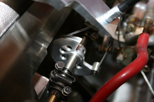

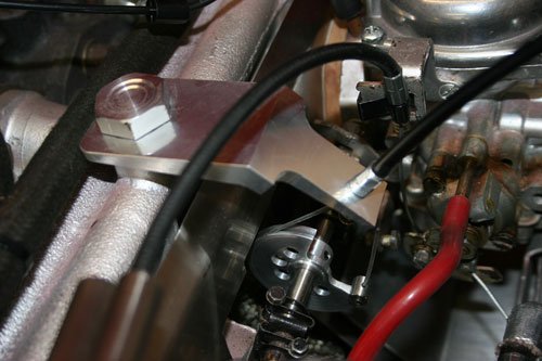

The throttle has always felt a little numb lacking instant response which prompted me to consider fitting bike carbs, but speaking to a few lads who have fitted these carbs they all said the same they are a pain to set up so wanting an easier solution i decided to redesign the way the throttle linkage operates.
Made a bracket to anchor the throttle cable along with a new spindle and cable guide wheel, all made from ally and stainless.

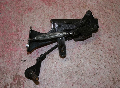

Old linkage which has a lot of wear probably due to its age.
New setup fitted, it's made a massive difference to the throttle response, much quicker but requiring less foot travel so it may be a hand full in the wet. Thinking of turning a larger cable guide wheel or fitting a heavy return spring.

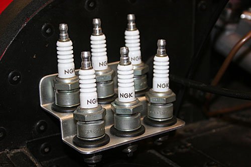

Also made a bracket to carry a spare set of plugs.
