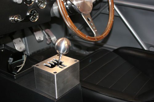

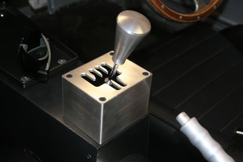

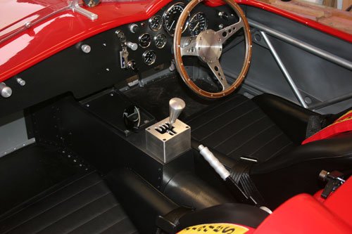

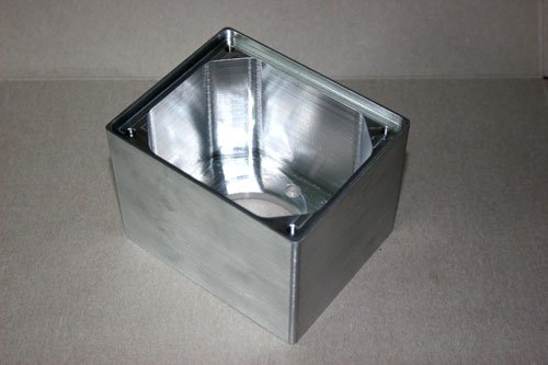

The gear gate is now finished and fitted which works a treat, just need to machine a round gear knob to finish off.
Machined out of solid ally or as known in the trade a billet.
No more mistaken reverse gear for first now.

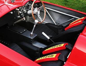

Image of the original gear stick.
13 Jun 2016, 8:43pm
Great attention to detail
I am envious of you skills
13 Jun 2016, 9:47pm
Almost a work of automotive art.
Wicked stuff
14 Jun 2016, 6:53am
Very nice indeed. Can't wait to see it with a ball gearknob.
14 Jun 2016, 6:57am
Swifty - Great job on the gear gate. :cool:

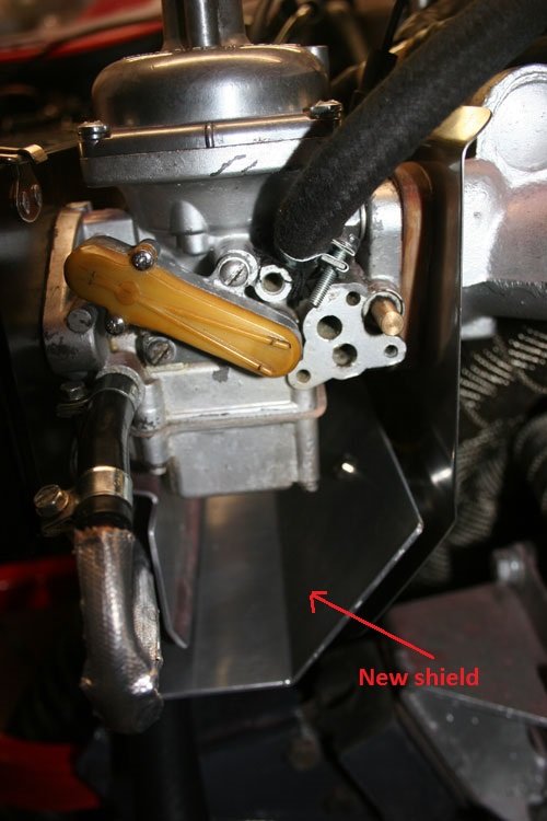

Hot start saga still continues.
Still not 100% sure as to what's causing the none start when hot, been playing around with the pick up air gap for the electronic ignition and found that the info given by the supplier is not entirely true so are at the moment in negotiation for a solution.

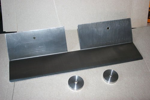

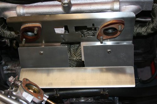

Also been looking at the heat shield which Ive now extended so the whole underside of the carbs are covered.
Fabricated a plate from 2mm ally with 7mm spacers to give an air gap between the original shield and the new one.
New shield in place, bolted to the original plate.
Side view showing how far the new heat shield covers the underside of the carbs.
Gave the car a run out then stopped for 10 mins parked up in the garage to retain as much heat as possible and she started after about three cranks with the throttle wide open, i may be on the right track but i still feel there's an issue with the electronic distributor. The dizzy shaft has 0.5mm side float which will give a fluctuating air gap when running, while the focal length for the pick up is 0.08mm to 0.10mm which is well below the half mill side float.

Can you wrap the manifold to assist in reducing the heatsoak? Or ceramic coating???
14 Jun 2016, 9:11pm
The manifold and just about the whole exhaust system has been wrapped which made no difference, ive also tried the higher octane unleaded petrol, checked the carbs over float height etc and made adjustment but still no solution. The distributor was brand new with built in electronic ignition but it looks like the dizzy may of been a cheap copy that's why i am now turning my attention to the ignition components although i can't understand why a hot ignition would cause problems to not start but ok when cooler.

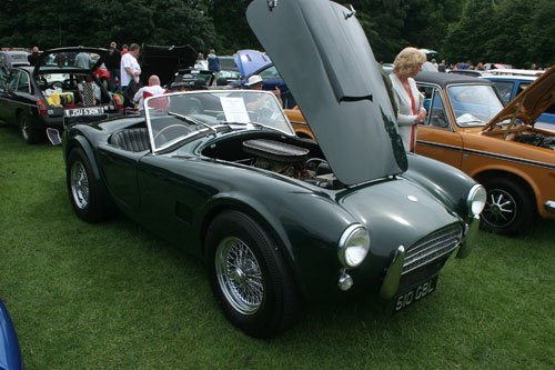

Had the car out today at a local classic car show, alas i did not put it on show as i was too late to register so parked up with every body else and had a walk around, car's from my past on display but none of the Italian exotic cars which was a disappointment had hoped to see maybe a Lancia Spider or Fiat 124 spider, me thinks one of these could be the next project, just need to find a suitable one which at the minute is like looking for hens teeth.
Cars from the late fifties through to the sixty's have similarities in body shape, this i was led to believe was a genuine AC and not a kit. What i found surprising was the huge size of the wheels and tyres compared to whats on the navigator but they certainly did not look out of place.

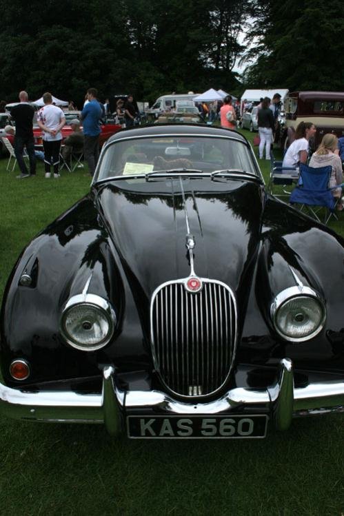

The XK150 is one of my favorite old jags, this one was in great shape both internal and external. Triumph TR3, great example.

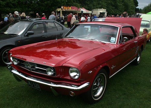

Mint american classic.
Left the best till last. Car shot with what is becoming the obligatory castle in back ground.
Even though it was parked in amongest every day cars it still drew attention, when i arrived back at the car there was a father and son debating as to what it was, the son was taken pictures to check the reg out to see what information he could find on the web, so i decided to put them out of their misery and tell them what it is, which surprised both of them. They said they had seen the car passing through the show area and decided to walk through the parking fields to find it.
Even on the way home i was stopped by a guy in an MGB who wanted to find out what it was, may be it was because i over took him so wanted to know what it had under the bonnet, plus he commented on the popping exhaust noise, music to the ears i never get tired of lifting off and hearing the pops and crackles.

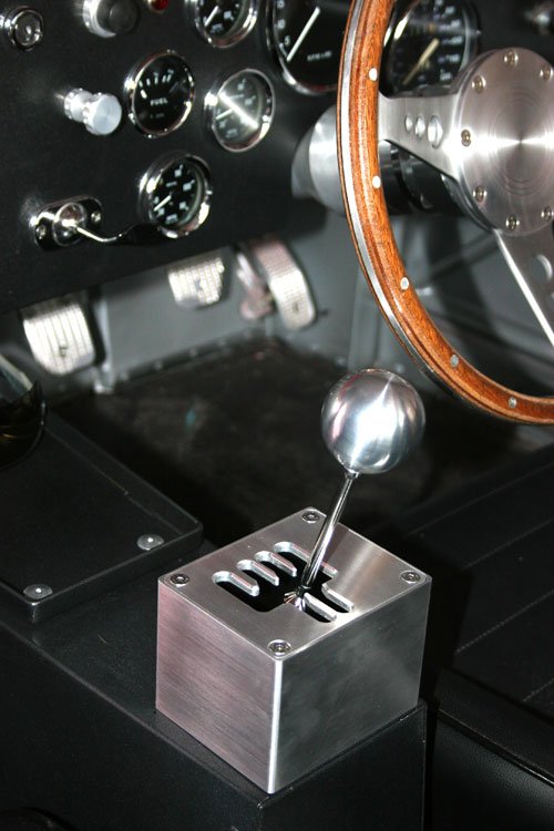

Finished the round gear knob and also made another gear stick this time slightly longer to see which length suits the car.
Short stick. Long stick.

Definitely the longer gear stick, it suits it much better. Nice work.
21 Jun 2016, 8:33pm
I prefer the long stick
The gear knob looks perfect, it must feel better to shift
21 Jun 2016, 9:07pm
Surprised Towed didn't mention the size of your knob, does that fit comfortable to hand?
21 Jun 2016, 9:11pm
It's not the length of your stick that counts.
It's the smoothness of your knob that matters
That said I like long stick and round knob
