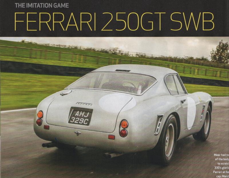

The march 2015 issue of Classic & Sports Car has a feature on replicas including a 250swb.
Beautiful work, but as I don't have a spare 10 years or £100,000 I'll stick with my Tribute order.
