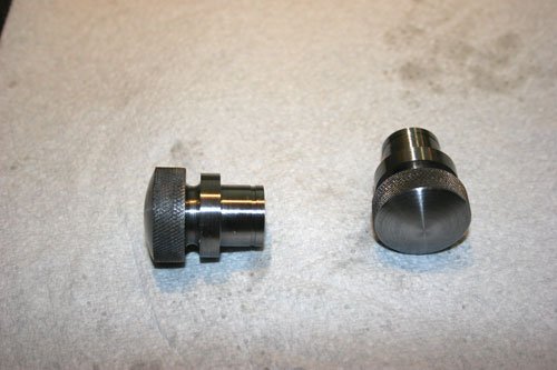

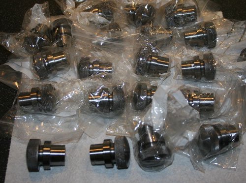

Mac i thought you would like to see these.
20 Dec 2014, 4:57pm
Tony,
Nice one! they look spot on mate, ill get them off to the chromers as soon as they pitch up.
Mac
