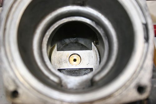

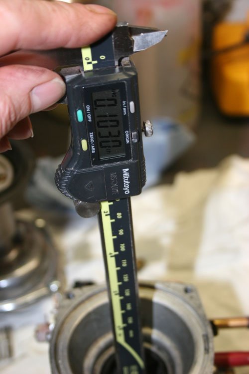

Stripped the carbs off the car to check the float heights which were slightly to high, this would give a lower fuel level in the float chamber so adjusted to 17mm high. Then turned my attention to both fixed jet height's which were sitting too high, both jets were 75 th (1.9 mm) down in the carb body this would give a leaner mixture on start up. Knocked the jets down to 100 th (2.54 mm).
Took the car out for a blast (any excuses to drive her) returned home switched the engine off for 10 mins then started again flooring the throttle and hey presto the engine started, i must confess not as quick as when cold but after three to four revolutions so without tempting fate i think i may be getting to the bottom of the hot start problem.
Picture shows the fixed jet which is the small round brass fitting sitting in the center of the ally carb body. The dash pot followed by the air valve with diaphragm attached is removed to gain access to the fixed jet.
Checking jet height in relation to the carb bridge with a vernier caliper, this jet is 103 th, the extra 3 th in not a problem.
Something else i noticed after adjusting the fixed jet's was the exhaust does not pop as much on over run plus the idle mixture can be set correctly, prior to doing this adjustment the needle adjusters were screwed fully in (clock wise giving a richer mixture), were as now they are in a mid way position, this all adds up to being correct with the adjustments ive just done.

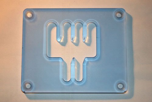

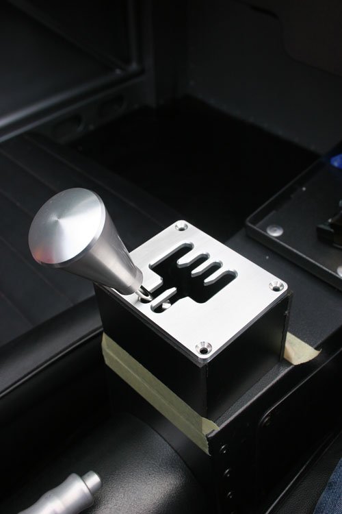

Spent some time today figuring out the program for a gate type gear change.

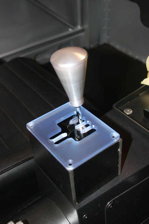

Started with the top plate, made a trial plate out of acrylic sheet which is easy to machine and cheap.
Trial fitted to the mock housing to make sure the gear slot positions are correct so now will make the final plate out of ally then start on the housing which hopefully ill make out of a solid piece of ally.
Trial gate plate in position, will also turn a new gear knob to suit the gate type change.

25 May 2016, 7:13pm
I really like it in the plastic as well :)
25 May 2016, 7:17pm
It does look good in plastic but i am trying to keep it looking period. One of the lads said it would look good with a blue led in the housing but again not period.

Psycho pops Fitted a type 9 gearbox specifically for the fifth gear plus i felt the ford box is stronger than the triumph, its out of a 2.8 capri which has the longer input shaft to suit the gt6 engine and different ratio's to a type 9 in the smaller ford engine cars, i was led to believe a 2.8 type 9 would suit the triumph 1:89 diff which it does.
One down side is the position of the reverse right next to first, you don't have to lift or push down on the gear stick to engage reverse, there has been a few occasions Ive thought it was in first only to find out it was in reverse, this is one of the reasons Ive started making a gate shift to remove this error before i smash the rear end in.

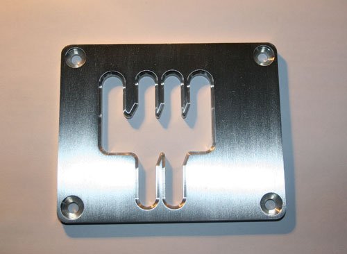

Made the gear gate top plate in ally today so now have the main body to machine.

You won't get any flack from classic enthusiasts Swifty, jealousy maybe, but no flack.
Just loiter near your car and earwig the discussions about it and you'll see what I mean. With mine, the main topic of conversation from classic buffs has been whether or not it's been restored. Some say it has to have been because there's no rust, and this is met with the argument that it's clearly aluminium so won't rust, while the imperfect paint can only have been applied decades ago. I haven't heard anybody question whether it's real or not in three years of classic shows.
Enjoy your car, it's a credit to you. One very small observation though: I know you probably machined your gearknob yourself, but an aluminium ball would just 'fit' the look of your car so much better I think...
Oh, and if you were to take commissions to make aluminium gear gates like yours, what sort of price would we be talking about. PM me if talking money on the forum seems a bit vulgar. ;)

MrT My intentions are to machine a golf ball size gear knob as i agree the one fitted now looks out of place.
Cost for a gear gate plate, how much would you pay, the one thing that differs is the slot positions and size depending on the gear box.

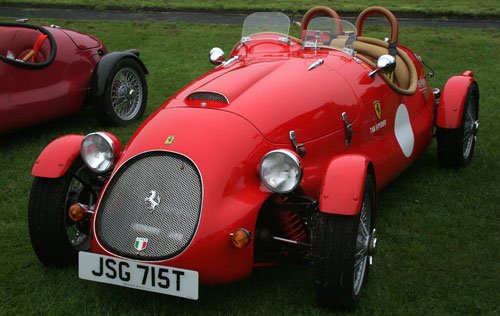

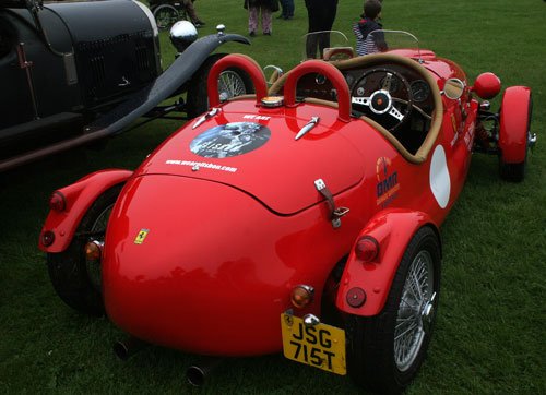

Payed a local car show a visit today and came across this kit based on a triumph chassis.
12 Jun 2016, 8:44pm
I'd seen that too but not in the flesh. A fiorano or something.
