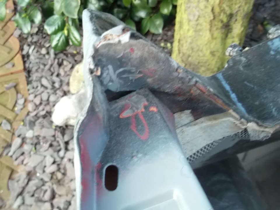

I did the final trimming around the edge of the battery box hole in the bulkhead.
I then needed to make a few fine tuning "adjustments" to the box itself to ensure it fitted into the hole.
( In other words using my small lump hammer, not the big one. :icon_wink: )
Finally I was left with this gap in front of the battery box.
This gap will make painting this area on the inside much easier to do.
But I wanted to provide a bit of extra support, so I welded in a section of small box section.
Then I marked up where the battery box met this bar & bent the front tab to match.
I just need to hammer out the left & right side edges until they touch the bulkhead before they are welded in place.
I will start welding from the bulkhead and work my way forward.
That way I can trim the front edge when I know how it all fits in place.

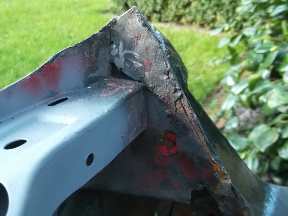

I've started preparing the battery box for the small rust repairs I need to make.
I also welded up a small slit in the bulkhead where I was a little too enthusiastic with the grinder cutting the old box out. :rolleyes:

Still, I patched another surplus hole in the bulkhead.
I also added two overside repair panels to the battery box.
By putting the panels on the outside, I can keep the drainage channels on the inside.
Then I drilled a hole and welded on my drainage pipe.
Now I need to work out the best place for this to drain out of the bulkhead.
Then I can weld a corresponding piece of pipe through the bulkhead and join them with some surplus heater hose.
Then the battery box was given the anti-rust treatment inside & out.

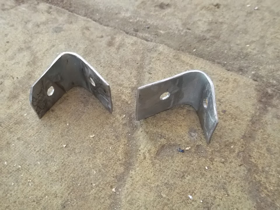

These are the brackets to hold the metal dash in place.
Plus two brackets for the speedo trip reset button (one from my original donor & one from the 2nd hand shell).

So I made a small bracket like this.
Now the choke cable can be tightened up against the bracket.
And the mounting screws will go into the original switch locating holes.

Instead I turned my attention to the ends of the metal dash board.
I made two small brackets to weld in & fix the ends of the dash in place.
I then welded in these brackets to the bottom edge, perpendicular to the dash board "face".
I was also able to put a bit of extra welding in a few places to help add strength.
Then it was time to apply some Kurust on all the bare metal.
Next job will be to apply some fibre glass filler to tidy up the welding and seal off any gaps.
I also applied some more Kurust on the inside of the hollow created when I cut off & sealed the windscreen posts.
