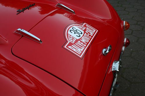

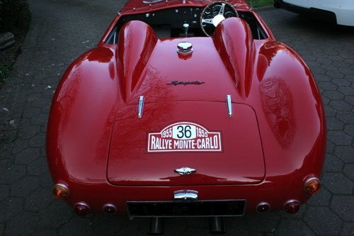

The final piece of the build was completed on Monday when the car was dropped off for the decals to be fitted.
Attachment “IMG_6701.jpg” from the original forum could not be reliably recovered.
Overall i am very pleased with the finish just need to put a badge below Pegasus near to the sill area. The guy who did the decals has used individual vinyl layers to make up the colours as he says this way last's longer than using printed designs which rub off after time with polish. It take's a little longer to make the decals this way and fit them as you have to be spot on with the alignment of the various layers but the end job is excellent.

The number 36 was Fangios number in a Lancia D24 in the 1953 2000 miles Carrera Panamericana which he won, cheers matey and i believe we have you to thank for the initial idea for these little cars.

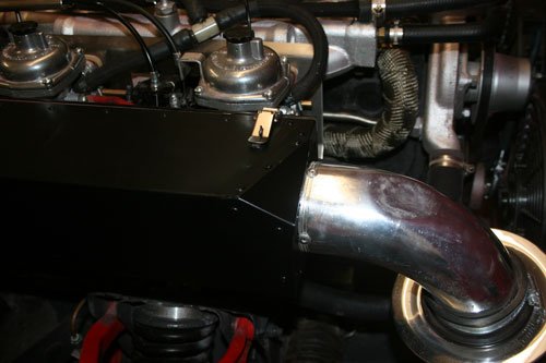

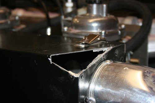

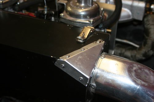

The air box i made has been catching the underside of the bonnet slightly so today Ive modified it.
Cut the corner away that was high and made an infill to cover the hole, sealed the inside with pu40
Job done and painted, one job off the list.

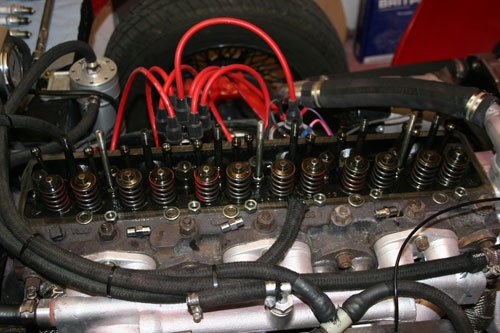

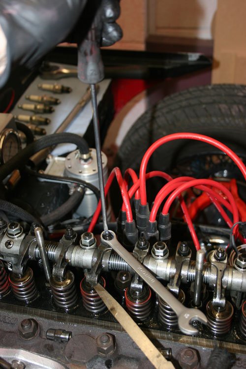

Next job was to re torque the head, had to remove the rocker shaft to get get access to one side of the head bolts, then refit the rocker shaft and adjust the tappets to 10th cold both inlet and exhaust.
A few tappets were 13-15th, the plugs are a light brown colour so mixture ok.

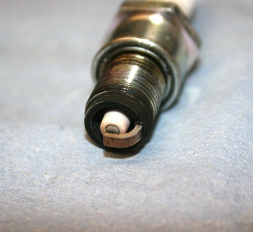

13 May 2016, 7:04pm
Picture of the spark plug for those that are not sure what the correct electrode colour is when the fuel mixture is ok, the last thread only let me add five pictures so had to add here.

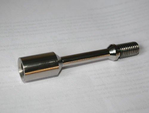

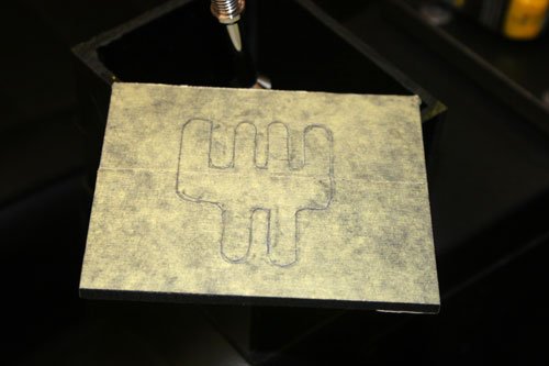

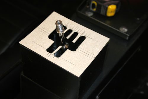

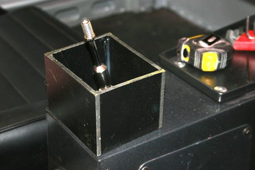

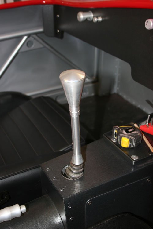

At the minute this gear stick is fitted which I've never been totally happy with so Ive decided to try and make a gate type shift, i think that's what it's called anyway, correct me if i am wrong.
First off i worked out the dimensions of a new gear stick, made out of stainless and polished with a mop wheel. Its shorter than the existing ally one i made many months ago about 90mm long plus due to being made from stainless has allowed the shaft diameter to be 7mm where as the ally shaft is 12mm diameter.
Next was to work out the dimensions of a box that will mount the gear selector plate to, made out of plastic for now to gauge the size. My intentions are to make the final box out of a billet of ally and leave the ally finish on display.
Made a cardboard template for the gear selector plate to trial fit with slight adjustments to suit gear stick movement.
Next the outline of the cardboard template was transferred onto a piece of the black plastic which i will machine out on the miller tomorrow to make sure it's correct before setting up to machine the final ally plate gear selector.
Well that's it for now see you all soon.

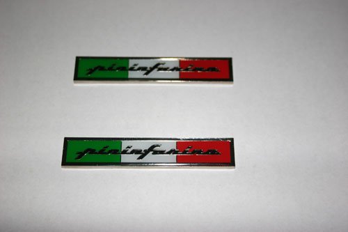

Two enamel badges arrived today, these will be the final finishing touch to the look of the car.
Very pleased with the quality, metal back with coloured enamel front with a clear glaze surface.

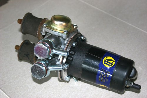

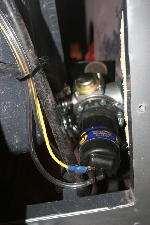

The SU fuel pump arrived end of week so i decided to fit it to the car and see if the hot start problem is fixed.
SU fuel pump, same as the one fitted to a stag.
Attachment “IMG_6724.jpg” from the original forum could not be reliably recovered.
Made a bracket to mount the fuel pump to the petrol tank sub frame, ive deliberately mounted the pump next to the tank where it will be cooler than if mounted under the bonnet.
Pump fitted and piped in ready to go.
Well after all the work involved (3 hrs) the engine was ran up to temperature then stopped for 5 mins with the bonnet closed then cranked the engine over only to find the hot start issue was still there, so back to the drawing board.
Next i intend to remove both carbs to check the float height and also the fixed jet height in relation to the carb bridge as i fitted new jets when overhauling the carbs, i believe this measurement to be 100 th or 2.54 mm give or take a little LOL. The fixed jets in the strombergs are a push fit in the carb body which means they can potentially give a rich or lean mixture, the needle can be adjusted slightly to enrich or weaken the mixture but this is a very small adjustment so if the fixed jet is a mile out then problems will occur, may have to see if i can purchase a second hand emissions meter just to see what the CO reading is.
All in all not the result i was wanting.

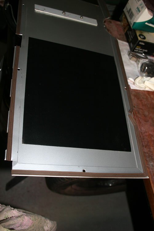

One thing that was a result was the panel deadening i used to combat the drumming and vibrating of the rear panel fitted behind the seats, i bought a box of smart price vinyl floor tiles with glue already applied from B&Q for £6, they work a treat and are a lot less money than the sound deadening stuff you can buy.
Black vinyl floor tile stuck to the back of an ally panel to stop the rattling.

Sorry to hear about your ongoing vapour lock issues.
I've read that bio-ethanol petrol can be more prone to cause vapour lock in older cars with carbs.
I also believe that super unleaded (98 octane) is less likely to have any ethanol.
It might be worth trying a can of super unleaded? Maybe run a fuel line from a 'temp fuel tank' just to try it, if draining your fuel tank is too daunting.
Just an idea to try.........
cheers, Peter
23 May 2016, 6:12am
Swifty, sorry if you've already made this obvious somewhere in your thread, but whereabouts in the country are you?
I have a pair of (worn out) 150 Strombergs sitting in my garage that you're welcome to borrow to see if they work on your GT6 motor. They're jetted for a mk1 Vitesse engine but still ran ok when I put a mk2 cam in.
They won't allow the engine to rev above 4,000 but I never had a hot start problem with them so you may be able to eliminate the carbs as the problem if they'll start your engine from hot.
There's also the possibility that it's nothing to do with the fuel supply or carburation. A friend of mine has a Mk2 Jag that he's owned for thirty years and has recently recommissioned himself (very talented chap, a farmer who restores cars in what little 'spare' time he has, it's his full lift and Willys Jeep in some of the pictures I posted last year). The Jag had a terrible hot-start issue and would cut out while on the move then refuse to start almost every time he took it out. Once it cooled down it'd be alright for a while, then cut out again once hot.
After a year of head scratching he took advice from a Jag expert who recommended he have the distributor reconditioned. Since he had that done his Jag hasn't missed a beat. Just a thought...
Triumph also used two suppliers for their distributors, btw, Lucas and AC Delco. I have Lucas and haven't had a problem, Phil J swears by AC Delco, in fact he couldn't get his bike carb'd motor to run at all with the Lucas version so fitted an AC Delco one in its place and the engine started no problem. I have one of those in my garage too...
