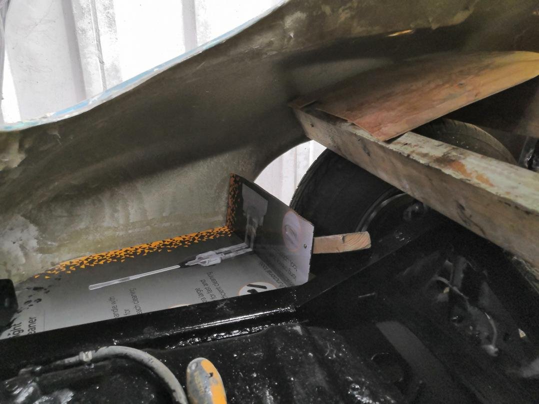

I can now also see how you'll be able to fit your seats with your centre outrigger where it is. on my shell, the rear 4" of the space you have your seats in is occupied by the front edge of the rear seat/luggage area, which is shaped to give that part of the shell some strength. Hopefully you can just about see what I mean in this pic -

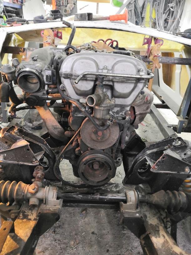

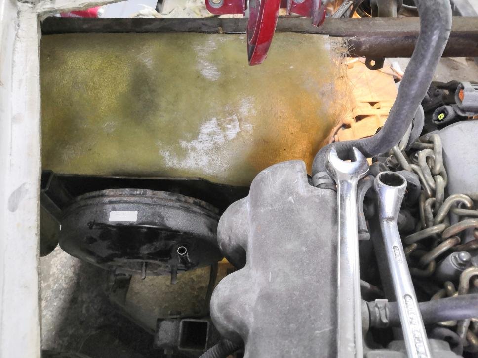

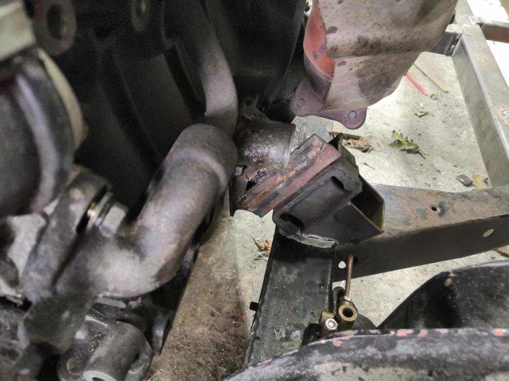

quick update we have an engine what a bugger to get in fouled on everything but its in and sat on engine mounts. Need to refit the alternator it will need ether a belt tensioner at the other side or fab a new bracket. more to follow latter
5 Jul 2020, 9:07am
Looks to be a good fit, should give it some serious go.

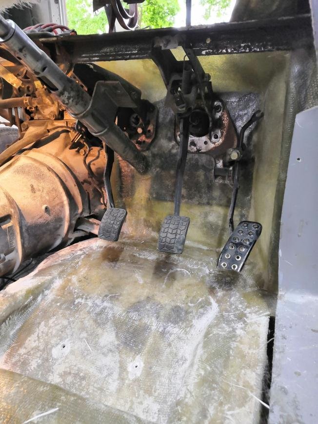

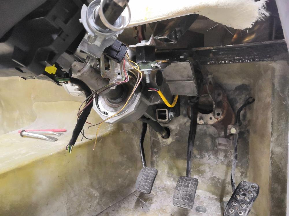

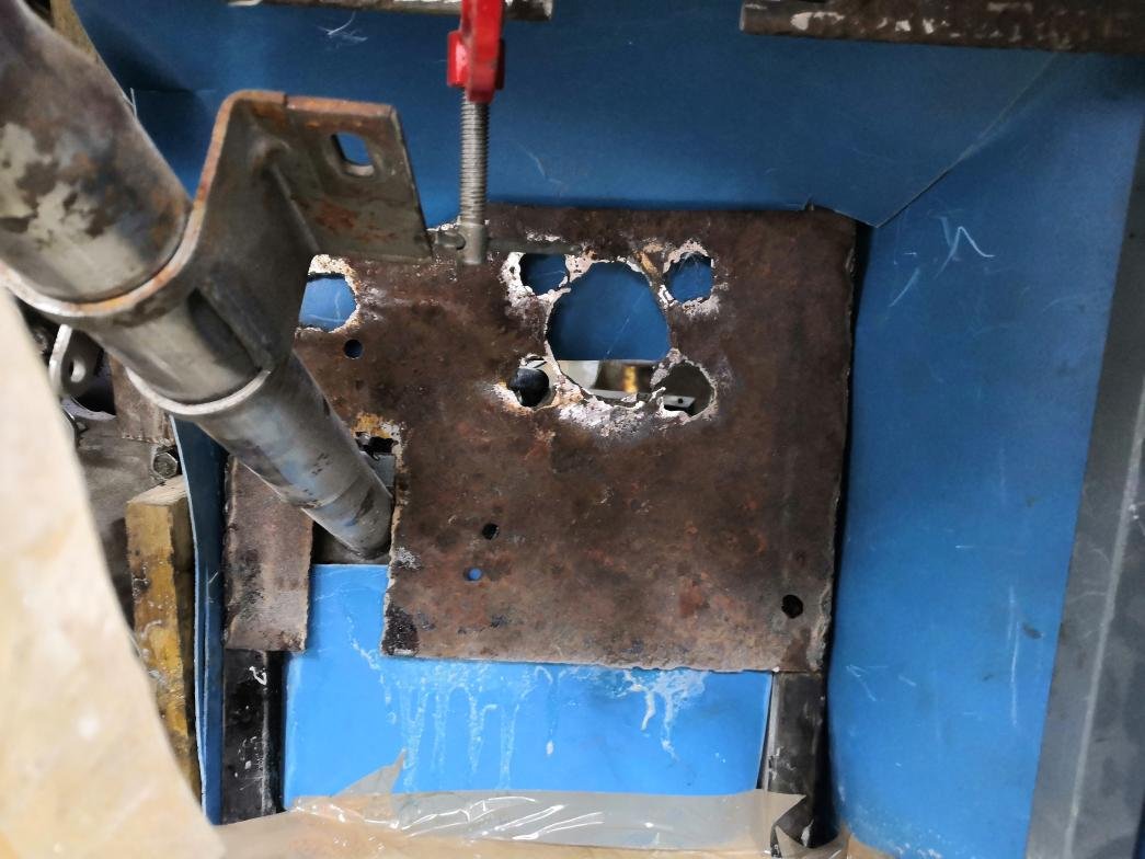

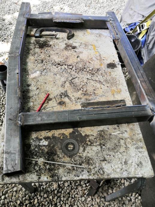

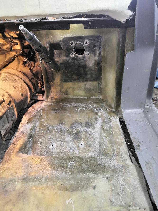

bit of progress this week foot pedals fitted, I've cut some steel plate out with the plasma cutter to hold everything in place welded some 30mm box section to it and in turn welded that to the chassis then fibreglass it in so its going nowhere. when the engine is next out I will glass it in from the back and make everything pretty on the engine fire wall side. after setting the pedals I dint like the foot potions so I have also sloped the floor off in the foot well that works better. also fitted the handbrake and steering column.back of the passenger fire wall has loads of room none at all on drivers side so I will make up a shelf for the battery etc. need to find a petrol tank so I can Finnish the boot off. next weeks job after fishing weekend.

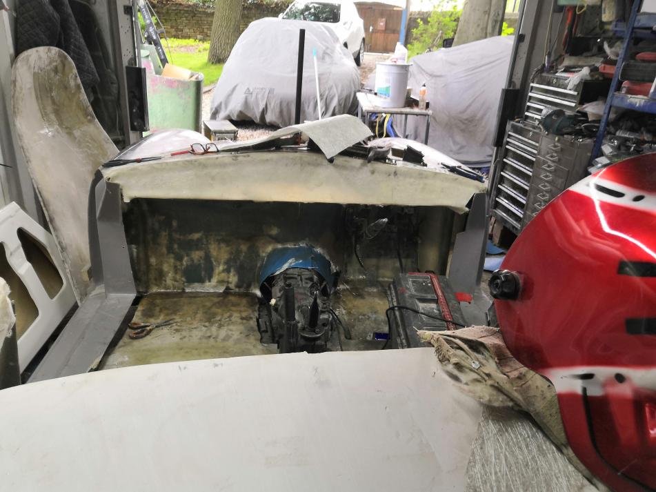

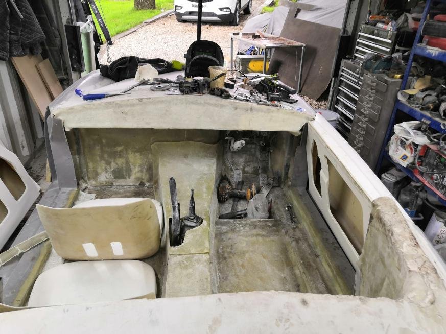

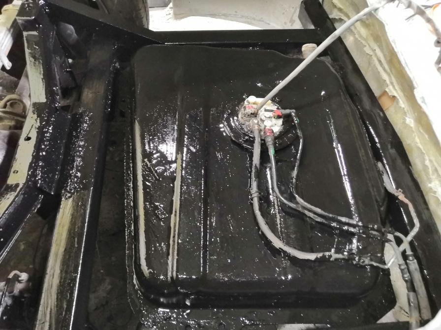

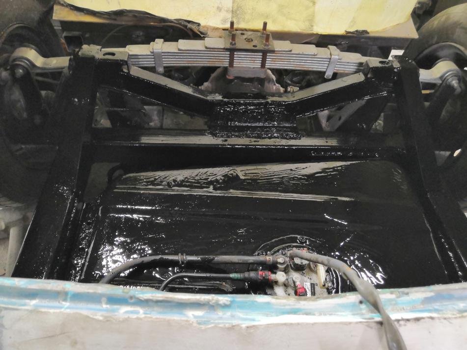

finally got a petrol tank so set about making a cradle to hold it in while trying to keep it low in the boot. the boot is a good size in these because it should be the engine and I want to keep as much of it as possible.
Now the tank is in I can start forming the boot floor and walls, from the inside its starting to look like a car.

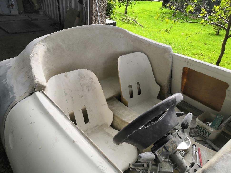

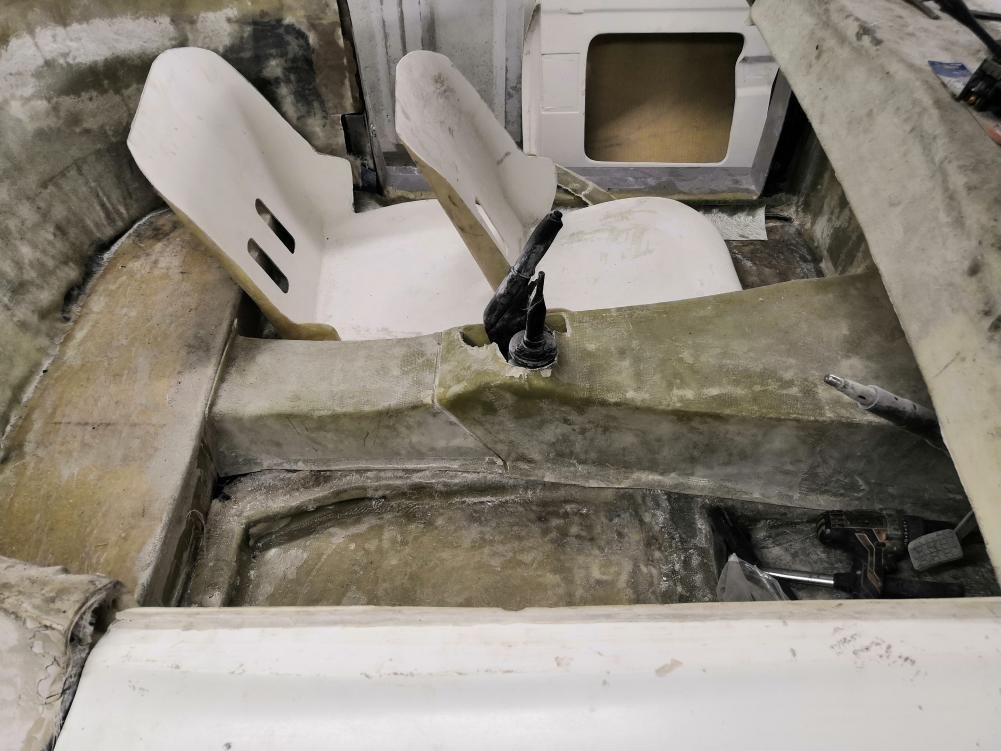

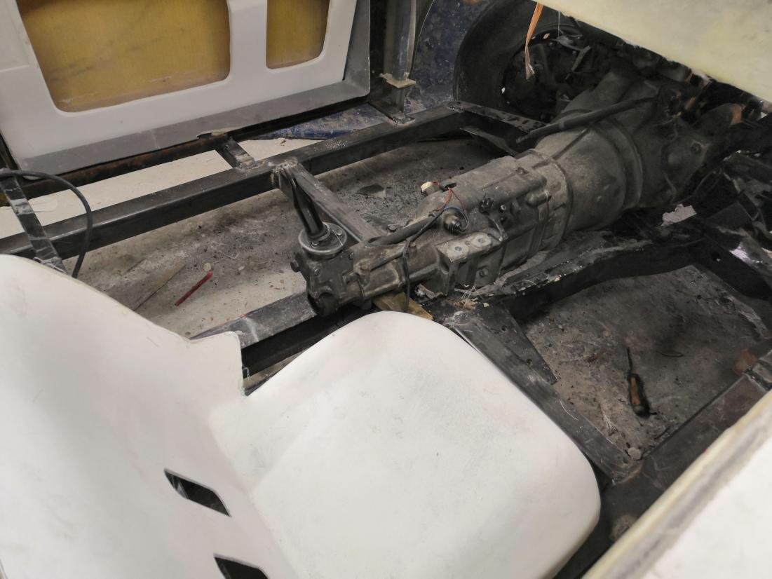

made a center tunnel to cover the gearbox and split it so it easily comes out easy also formed the rear seat still needs a lot of work . and yep I do need some more fiberglass :laugh:

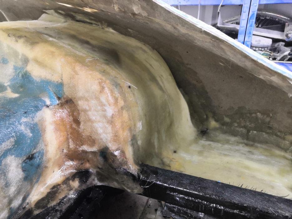

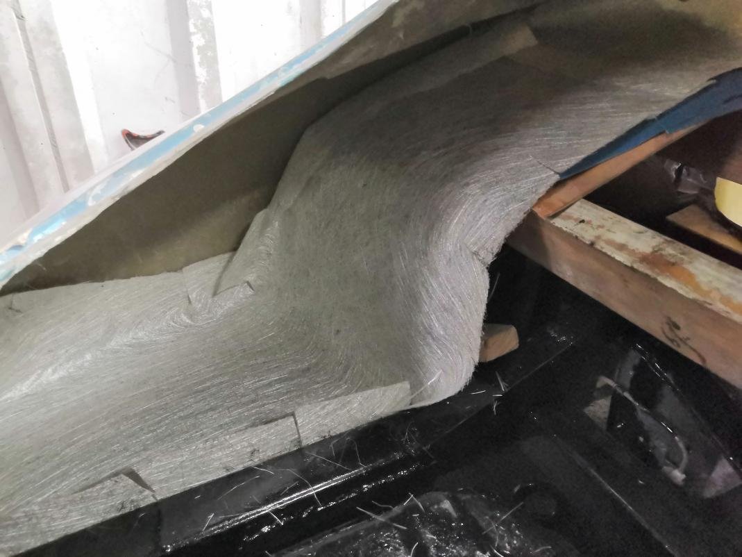

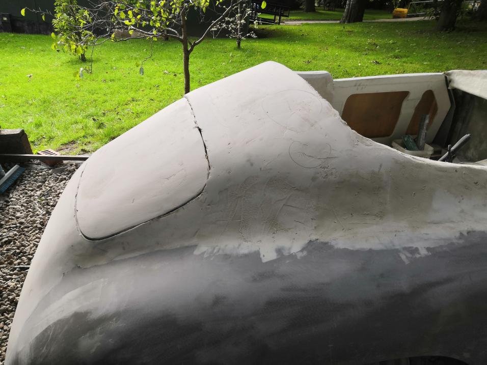

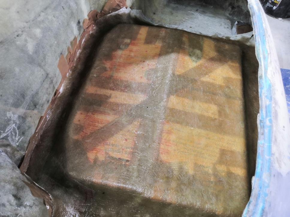

Cardboard and lino are out so it must be time to start on the boot,the hover box has a glossy wax coating brill for glassing it dose not stick. bit of very basic framework to hold it all in place 3 lairs of 600 csm and a lair of woven and we have part of a boot and wheel arches.
I am going to run out of resin already used my 5th tin this year, plan is to get as much as I can in with just one lair of csm then when I have more resin thicken it all in one hit:painkiller:

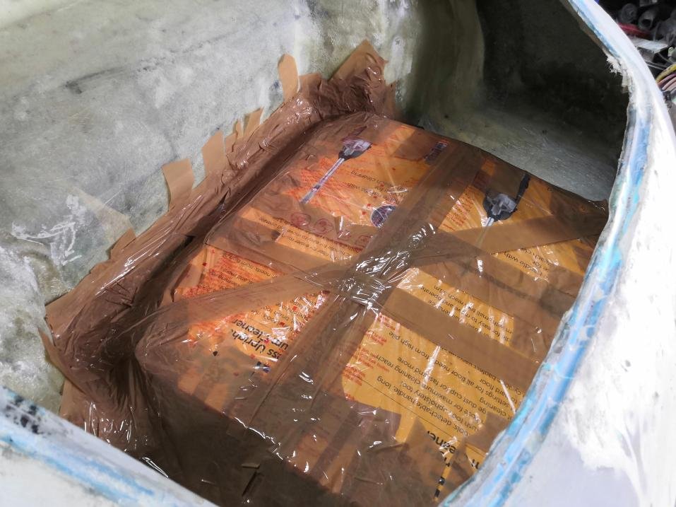

I have made a fiberglass cover for the tank to protect all the vitals loads of tape and cardboard should just pull off when its all hard. just need to trim it down and tech screw it in place so I can always get at the tank.
car will have a lovely rear end when its all finished lol;

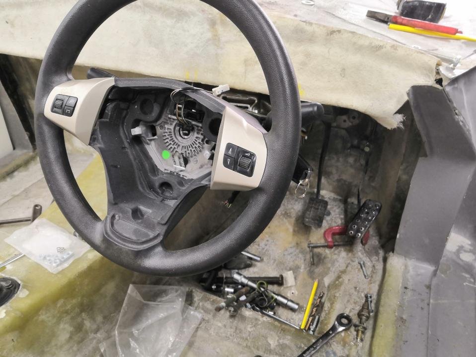

I needed an ignition switch but it was just as cheap to buy a complete power steering column off a corsa so we now have power steering. Need to change the steering wheel but not sure stock bug or chrome and wood.

Wow, such fast progress is making me dizzy! I take it the Corsa column has electric power assistance rather than hydraulic? Would be a nice mod for a six-pot car on wide tyres, are there any issues connecting it to the rack?
27 Jul 2020, 8:02am
yep electric power assistance they sell controllers on flebay around £15 from memory its like a volume button more power more assistance. all lines up bang on using part mx5 in the middle. I fitted one on my Chevy they work a treat and are as cheap as chips

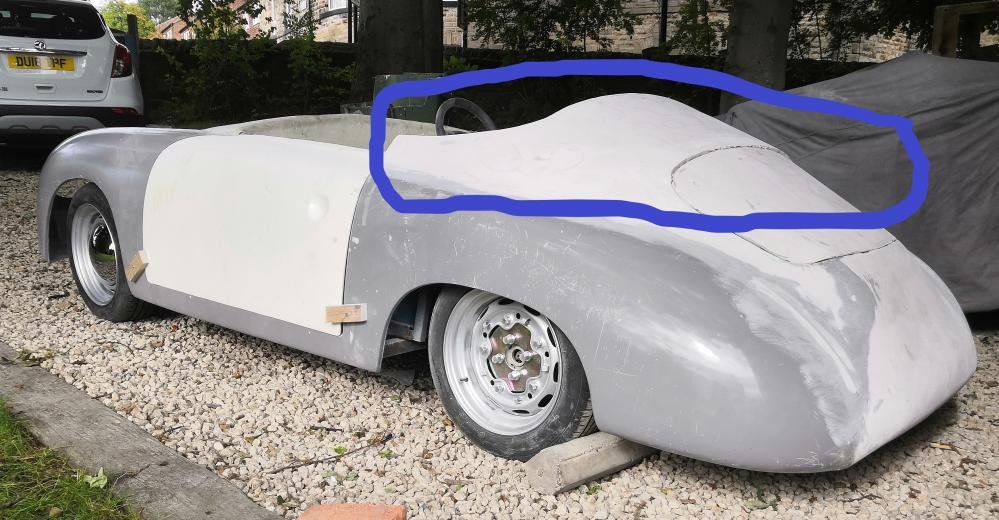

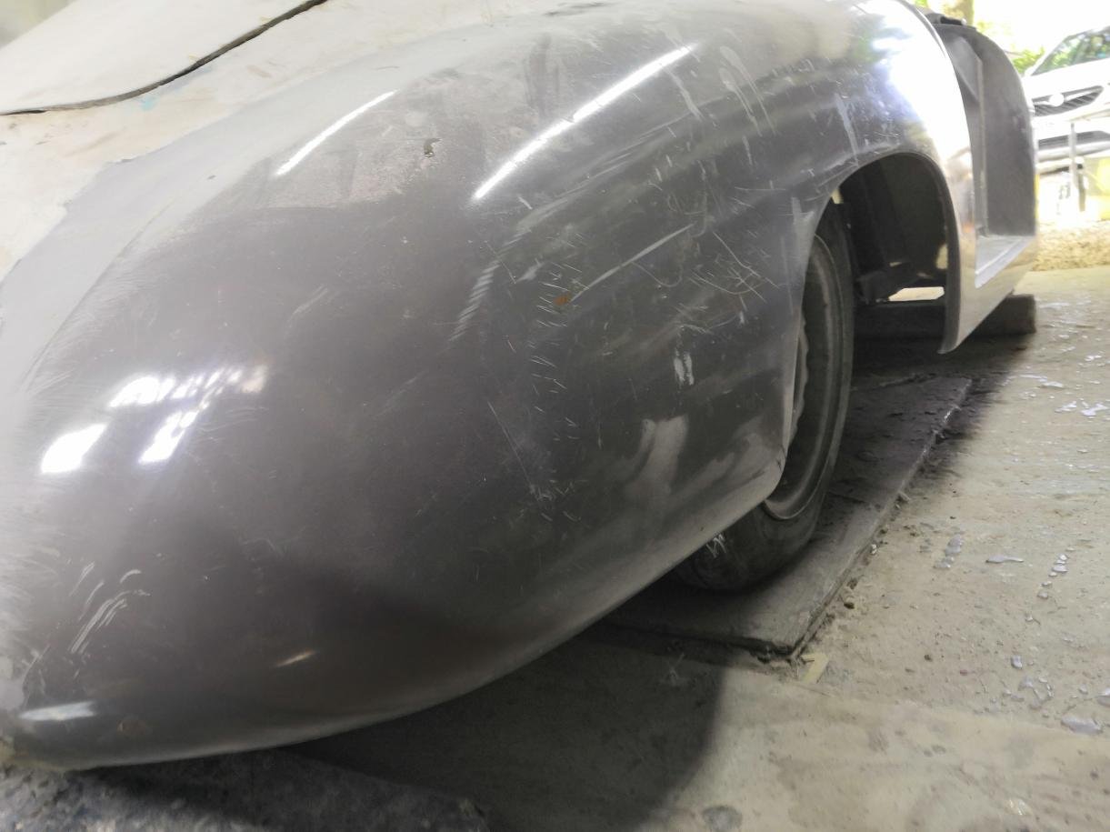

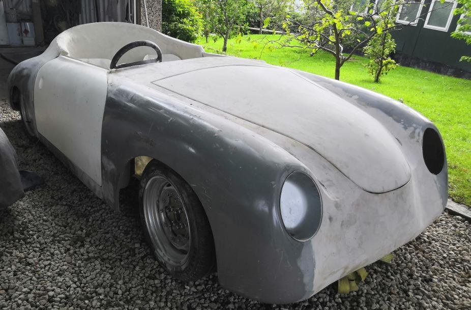

evening all well I am back off my hols my Zgt is going to be a while yet so some more time on the speedster. wheel spacers have arrived so I fitted the wheels I must have done something right they are bang on for distance from the arch both sides. I am not 100% happy with the area in blue I made it flatter first. Then changed it to what you see still not 100%
so now wondering should I go whole hog and put a roof on it. it would make it more usable and they are just as cool with a roof ,,,any thoughts anyone
31 Aug 2020, 9:58pm
My vote goes for the coupe. Speedster windscreen won't work with it though.
1 Sep 2020, 6:14am
Wheels look great, the rear 'hump' does look closer to the 911 cabriolet than the 356 but, based on what you've achieved so far, it shouldn't take too much work to flatten its curve.
Coupe would look great but sourcing and matching all the side glass and rear screen with frames and trim could become an expensive pain.
Keep up the good work!
