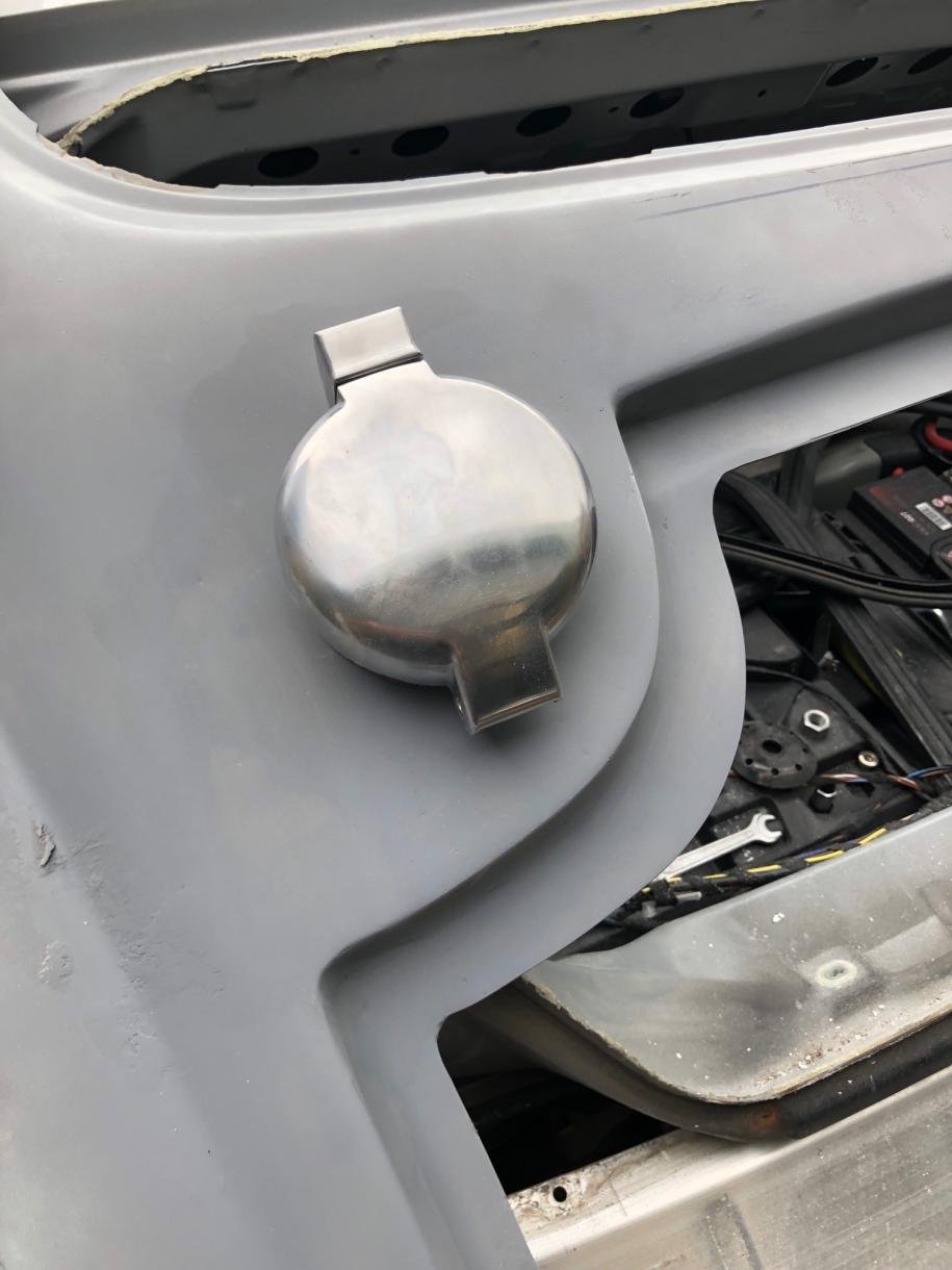

Ben at Classic Coachworks has been working his magic during the week....
We've deliberately not recessed the filler below the body line at all so as not to create a well in which spilt fuel might collect. Still a work in progress but I'm really pleased with the result so far and it keeps the line of the wings clean having the filler here!
20 Jul 2019, 7:17pm
looks great!
20 Jul 2019, 7:37pm
Fair dinkum, that's a good bit of modding. Looks fab.
Is the cap meant to the way round, hinge front side? Less drag at light speed and all that.
20 Jul 2019, 7:45pm
To be honest we just placed it in to check positioning and it's not fully fitted as yet, the hard part is working out the filler pipe run!
Looking at it now you've highlighted this though, you have a point, although at least this way around the flap will stay open...two schools of thought and a decision that'll be deferred to another day! :icon_smile:
20 Jul 2019, 7:53pm
I don't envy you with the filler pipe run. I'd be tempted to drop the tank, and fit a hole on the passenger side (and seal the stock hole). Otherwise, filling the tank is going to be 'click ... click ... click' at the pump.
20 Jul 2019, 8:20pm
Trying to avoid that at all costs! Ace reckons his solution works OK having tried it (see his build thread!) and so we've looked at a similar route, plus we have a plan B, both of which appear to give a continuous fall to the BMW filler neck.
Won't know for sure of course until we test it with a fill but taking the tank out and modifying it would be a very big deal!
20 Jul 2019, 8:52pm
Yes, already saw that a while back. Even with mine (Kobra) and a 50cm extension/30 degree downward angle, it isn't the best when filling.
Good luck, be interested to know how it works out.

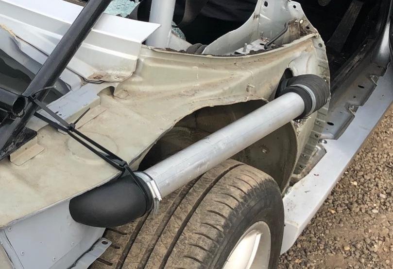

Ben & Ian of Classic Coachworks have been working on the fuel filler in the past week, extending the BMW neck up into the boot space...
Temporary cable-ties until all connections are worked out....more on this in a future post!

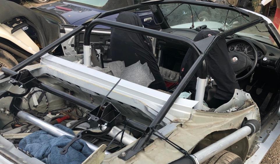

Classic Coachworks usually have SWB roll cages powder coated by a local specialist and having had the left hand boot hinge moved over, mine has been similarly treated and now permanently fitted...

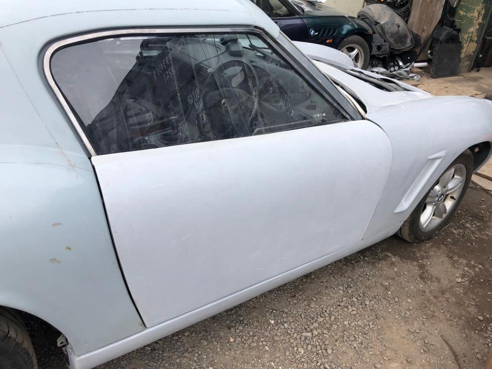

And the windows and door skins had their first trial fit finally today too, all OK and no issues apparent!

Great progress there, Gary. Well done. You must be chuffed.
Good to see the fuel filler pipe in. From the photo, it looks like it cuts through the boot space. Or is there still more to do?
The roll cage and doors look great. Tidy fit.
Keep up the good work, and the progress update :)
Chris.
Thanks Chris, yes really very pleased with progress! Classic have lots on their plate at the moment but are doing the business for me whilst also allowing me to get stuck in when time allows!
The fuel pipe does indeed enter, or rather exit the boot area, but it’s still a work in progress to make it work whilst still keeping the boot space practical. More will be posted in a couple of weeks on this I’m sure!
