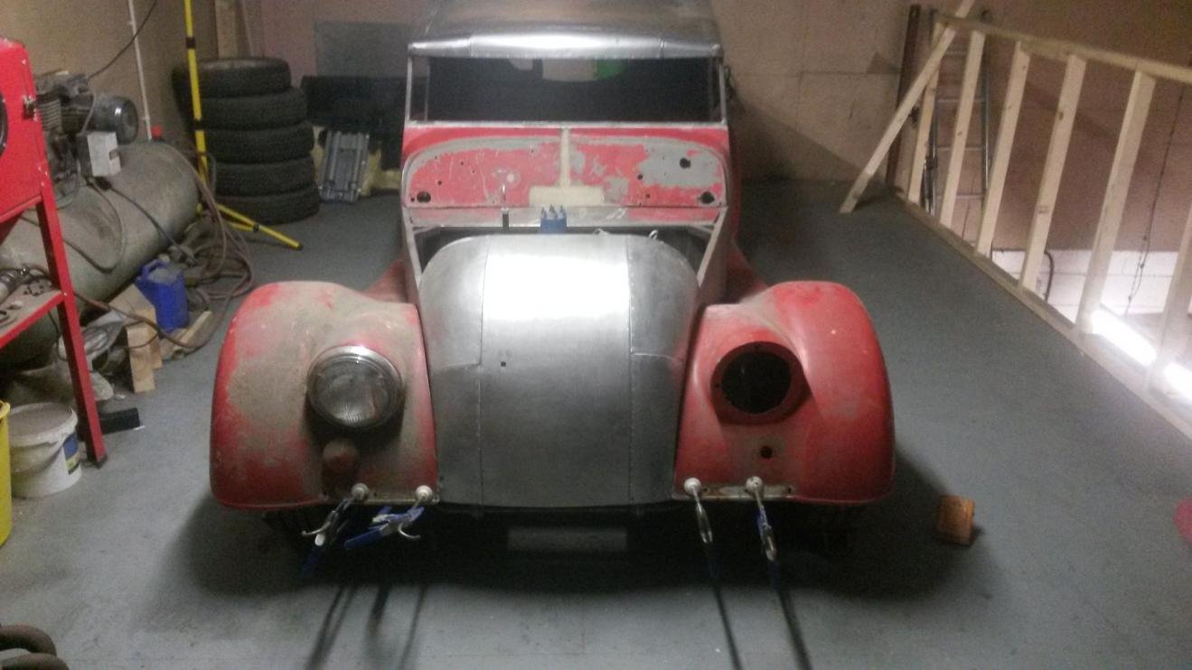

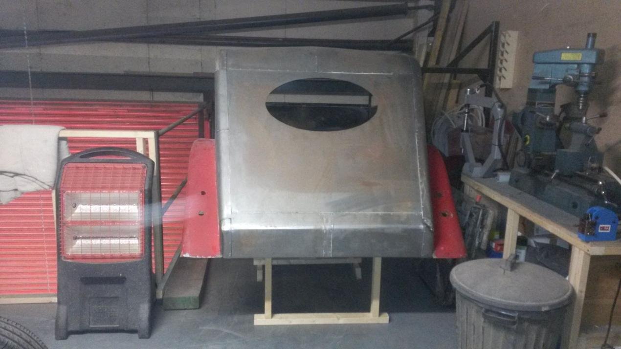

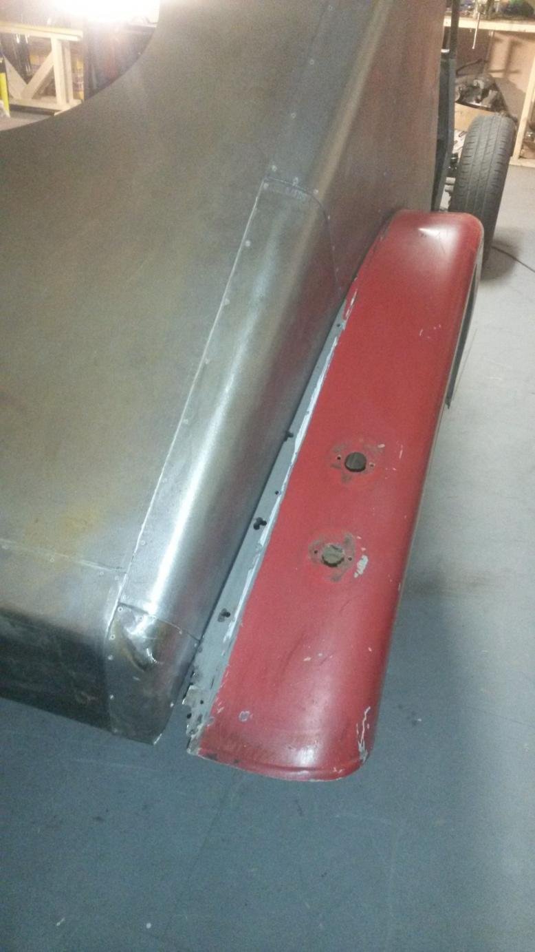

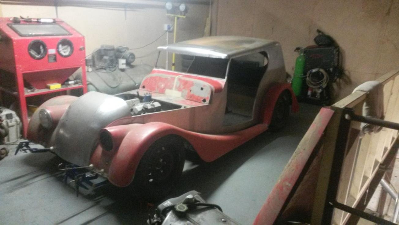

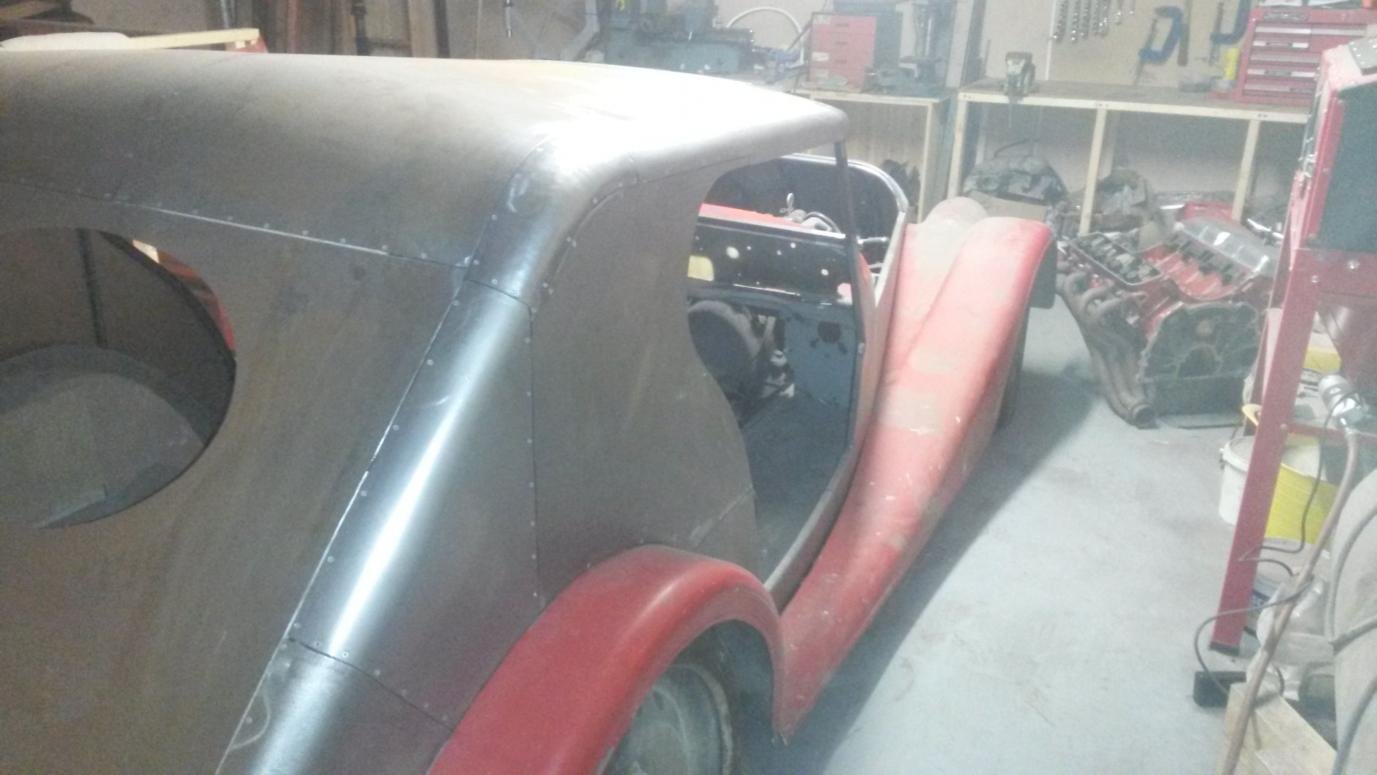

Hi been a bit slow over the last few weeks with work and home, but have now finished all the body panels. I have the doors to make yet but they will be left till later after I have removed the engine and mocked up the rover v8. So have removed the body and put it aside for now, so it does feel a big step.

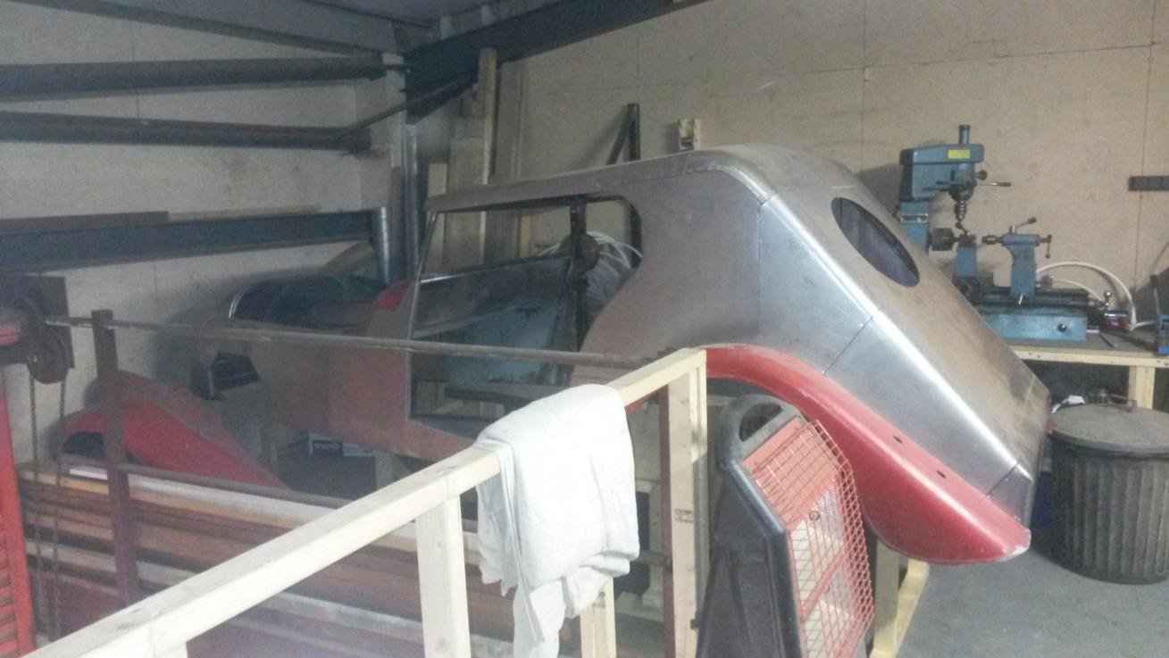

The photos show where I and building the car on the mezzanine floor above my workshop only way up is a ladder at the moment and a friend has a fork lift for heavy bits, but the best place I have to build.

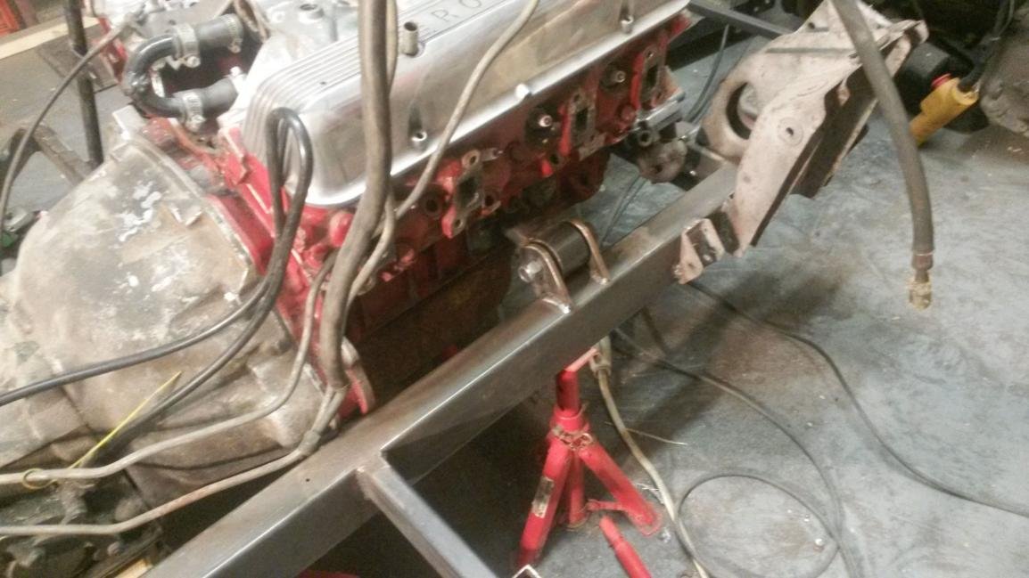

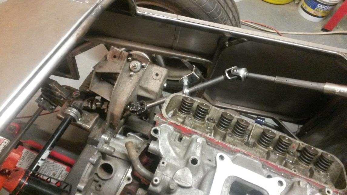

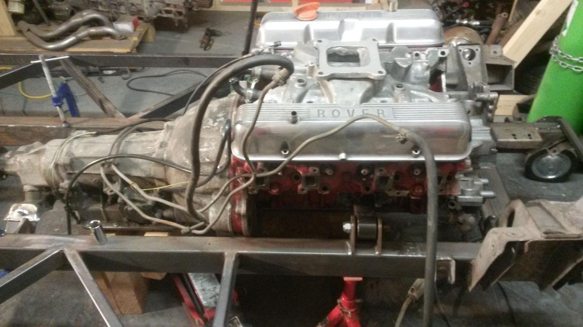

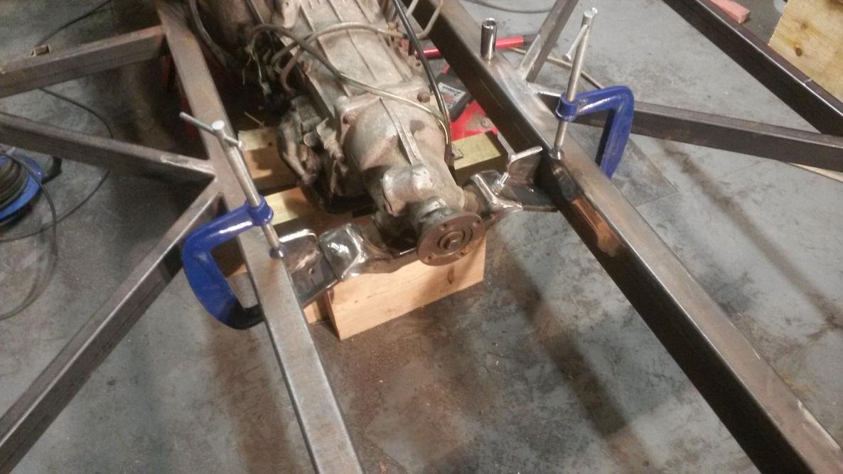

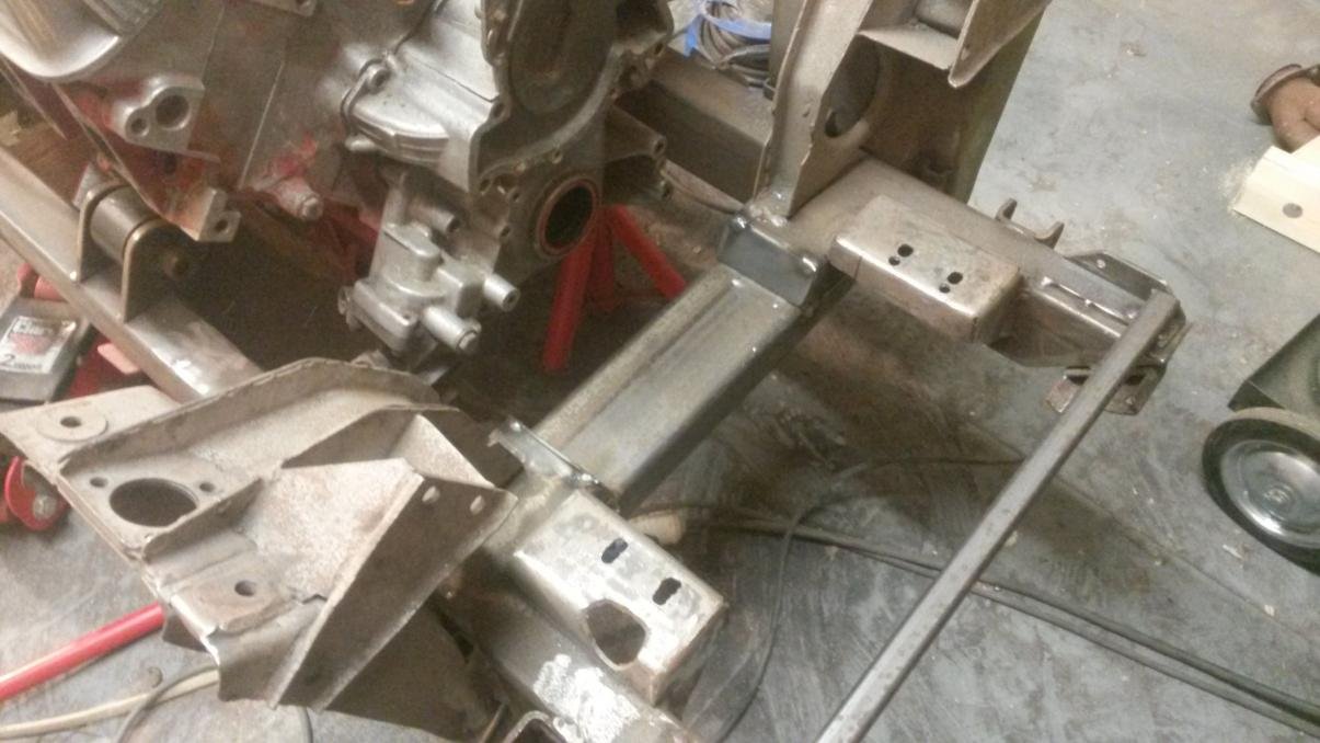

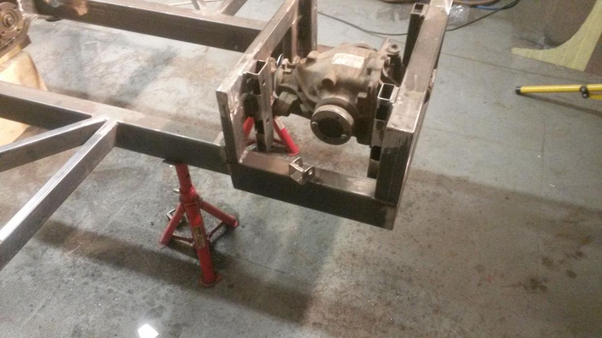

Have had a bit of time so have mocked up the Rover v8 and box, and dropped the diff frame down by 2" to get the prop shaft below the floor to give a bit moor room for the seats. So all tacked up for now and will get fully welded when I strip and get ready to paint.

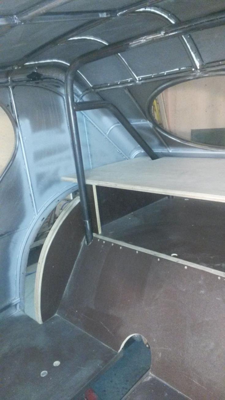

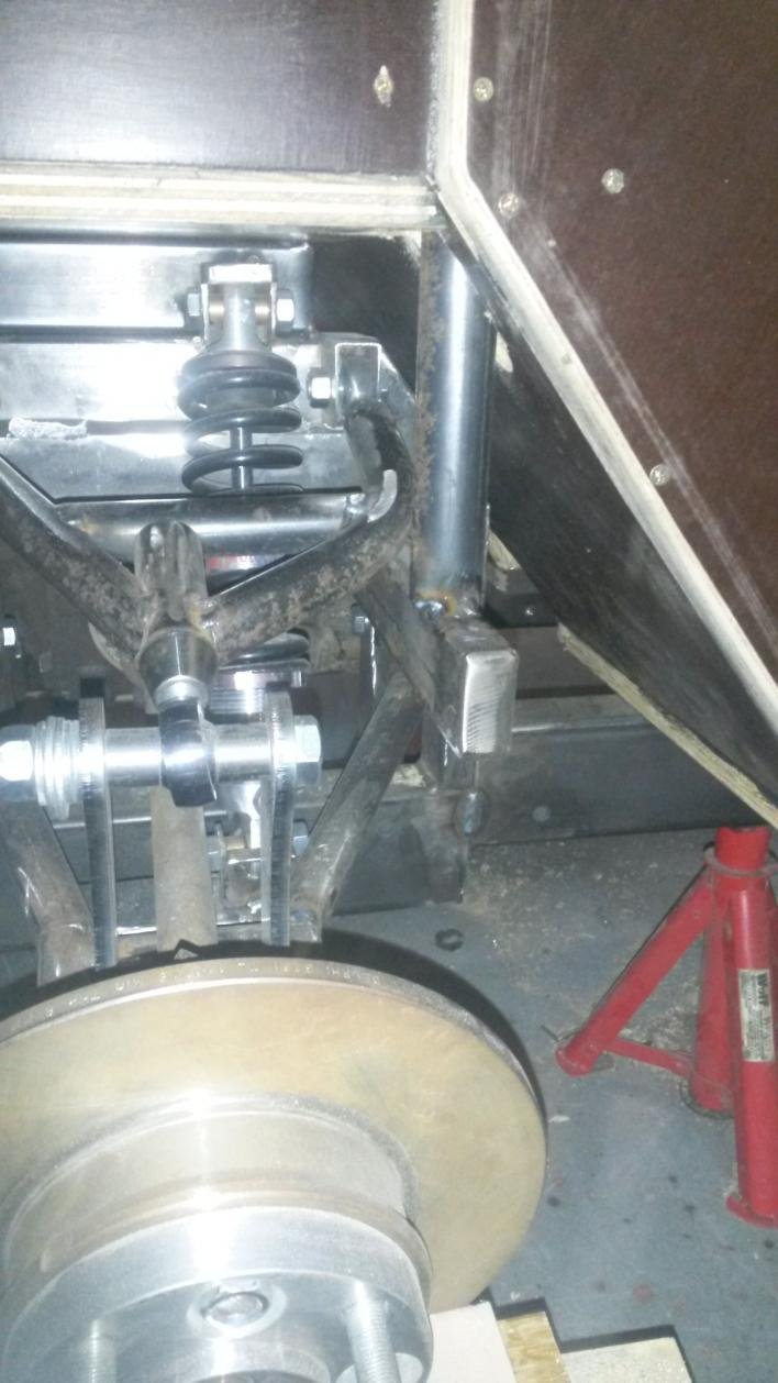

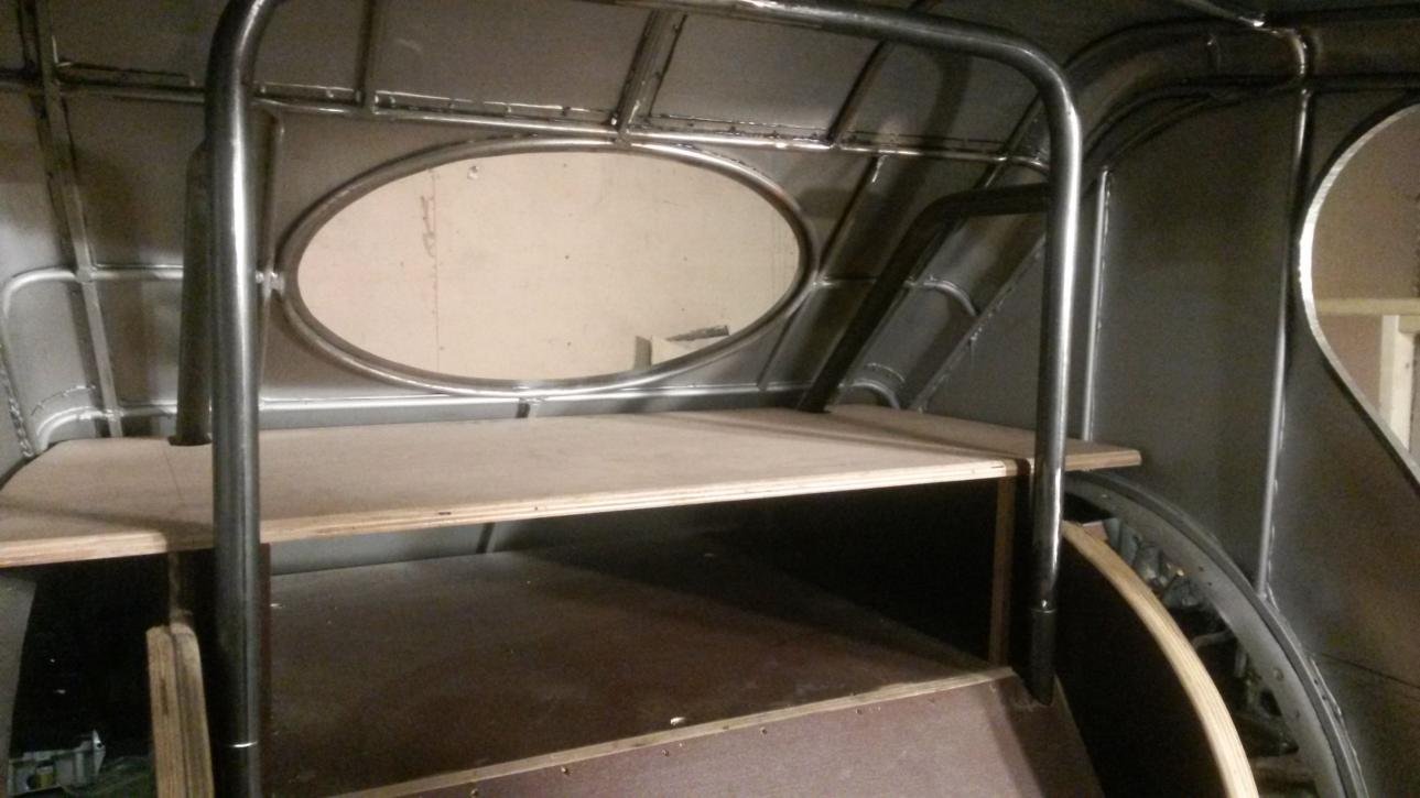

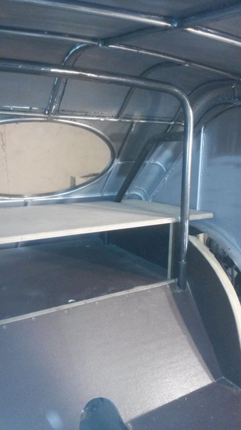

Well 12 months has come and past since I started work on the car, in the last month or so seems I have gone more back than forward. Taken out all the floors inner wheel arches, but this has allowed me to move out the rear wheel arches so they are parallel to the wheels now. Re fitted the floors and made a boot space to go behind the seats will have a fold down door fitted latter. I have also made a role cage this will help with seat belt mounts etc.

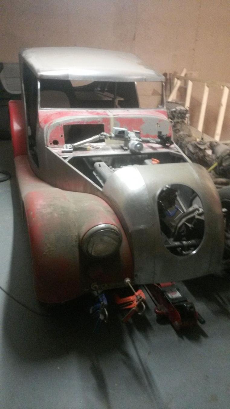

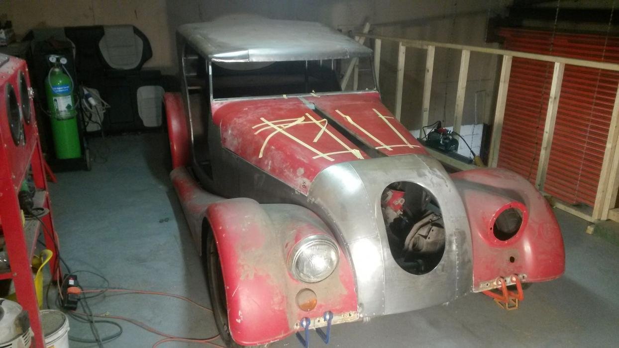

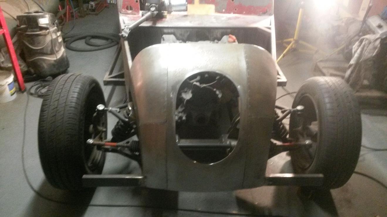

Managed to get the hole cut out for the front grill, been putting it off for to long so had a go will decide how to make the grill later.

14 Feb 2019, 9:41pm

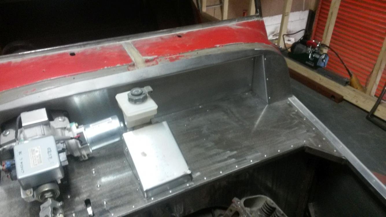

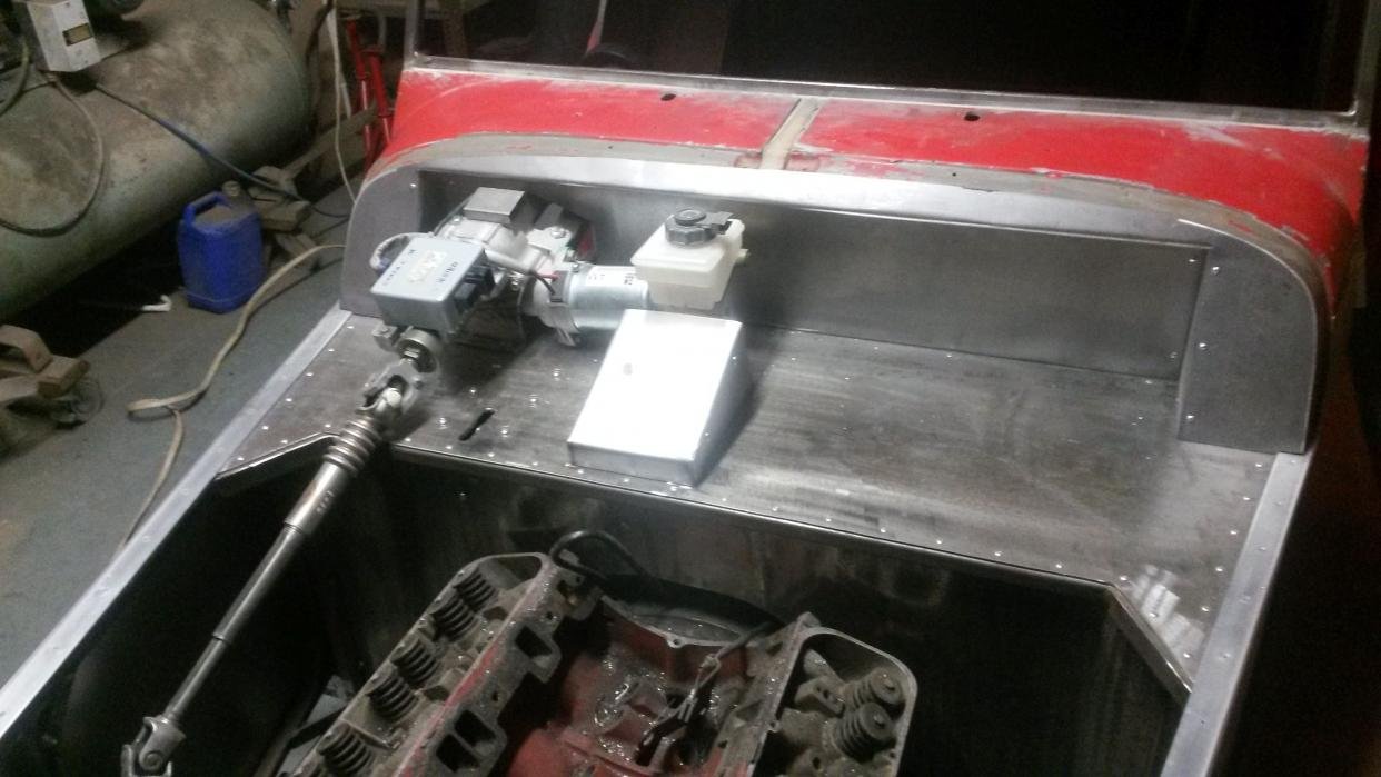

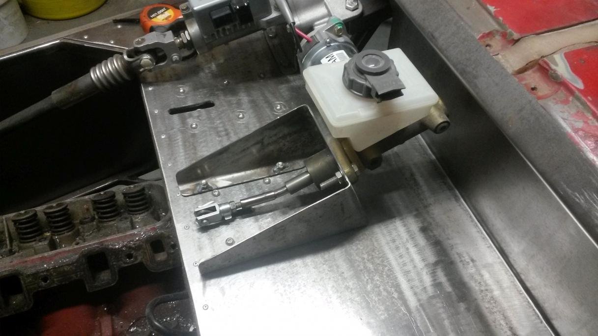

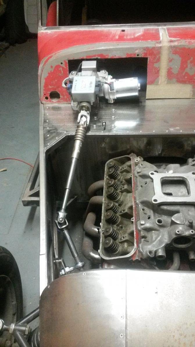

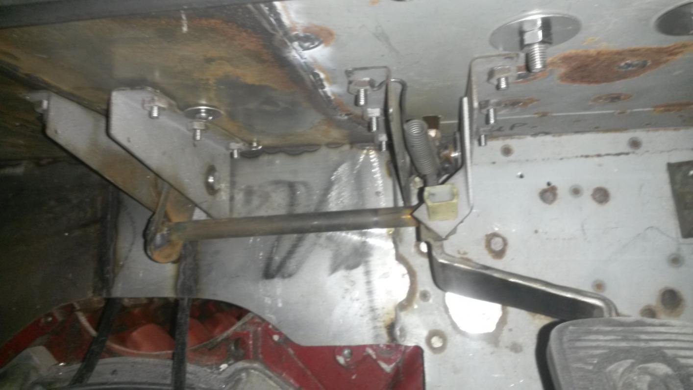

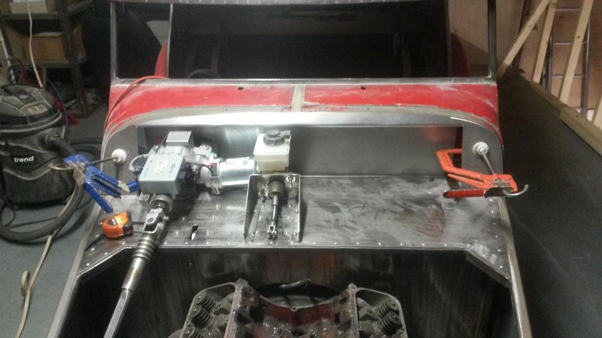

Been slow progress over the last month but have fitted the top to the front bulkhead and have installed the steering column, from a Corsa and other bits all works nice and smoothly and have fitted the brake pedal and brake master cylinder. Had to move this over to miss the steering column motor, as it is going to be an automatic gear box I linked the brake and clutch pedal together and moved it over enough, small steps but going forwards.

15 Feb 2019, 7:26pm
This makes me feel humble. Respect!
15 Feb 2019, 8:49pm
Thank you much appreciated. I am trying to do this build as best I can on a small budget so having to pick up a mix and match of parts, so takes a bit to think out side of the box to get round problems. But get there in the end if not on the first try.

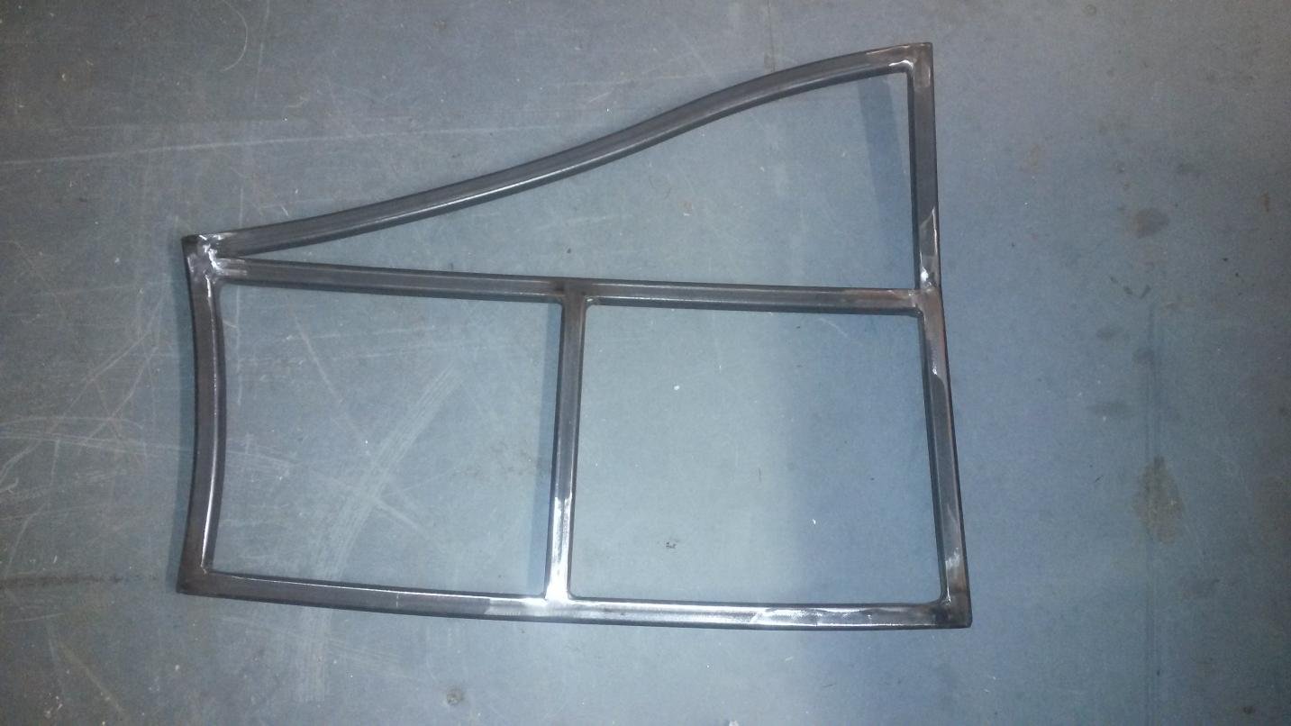

Have managed to get a bit done this week, made the lid for the brake master cylinder and box in the ends of the bulk head and have also made one of the door frames so going Ok.

3 Mar 2019, 8:13pm
Door frames look great, as a novice welder, i am envious.
3 Mar 2019, 9:11pm
Very well done!
4 Mar 2019, 8:11am
Thank you I am only learning to weld as I go along I got a welder when I started this project had a friend weld up the chassis and all the important bits and I have played and done bits as I have gone along.

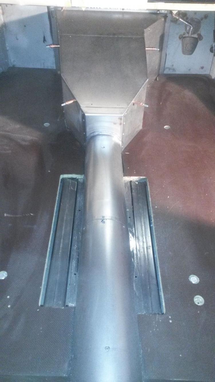

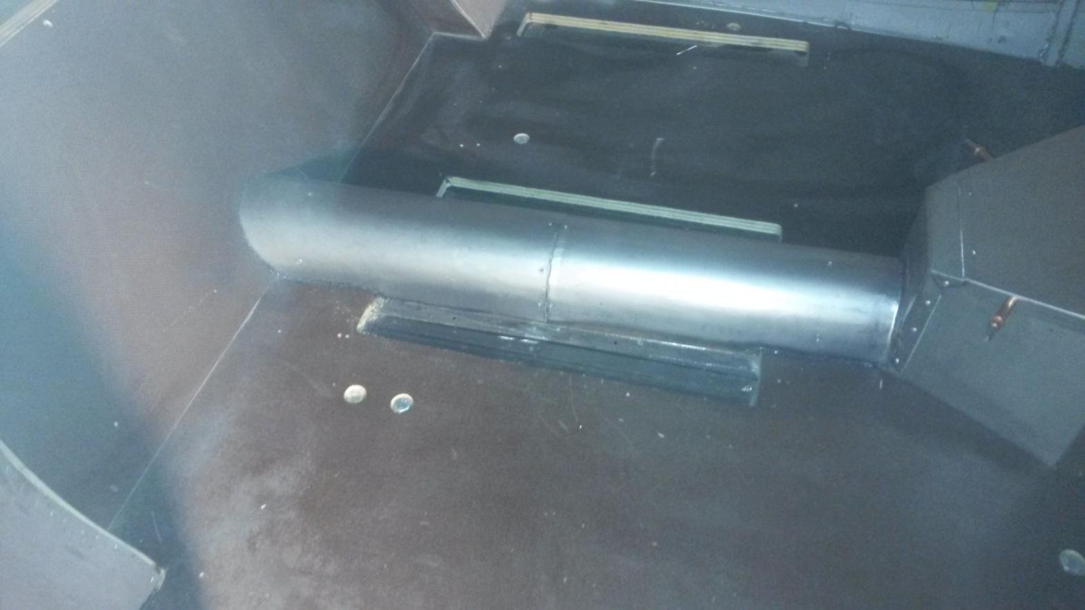

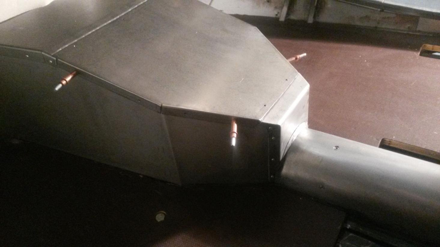

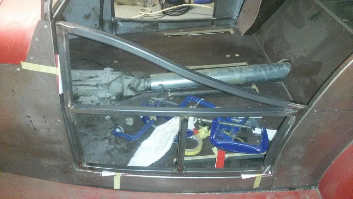

Looking good. A minor point, would having restraint straps for the prop shaft be a good idea?
4 Mar 2019, 8:24pm
Yes I will be putting a prop catcher in the ducting is just to give me an idea of size so I can mock up the tunnel, as the car is quite narrow I would like to keep it as small as possible thanks

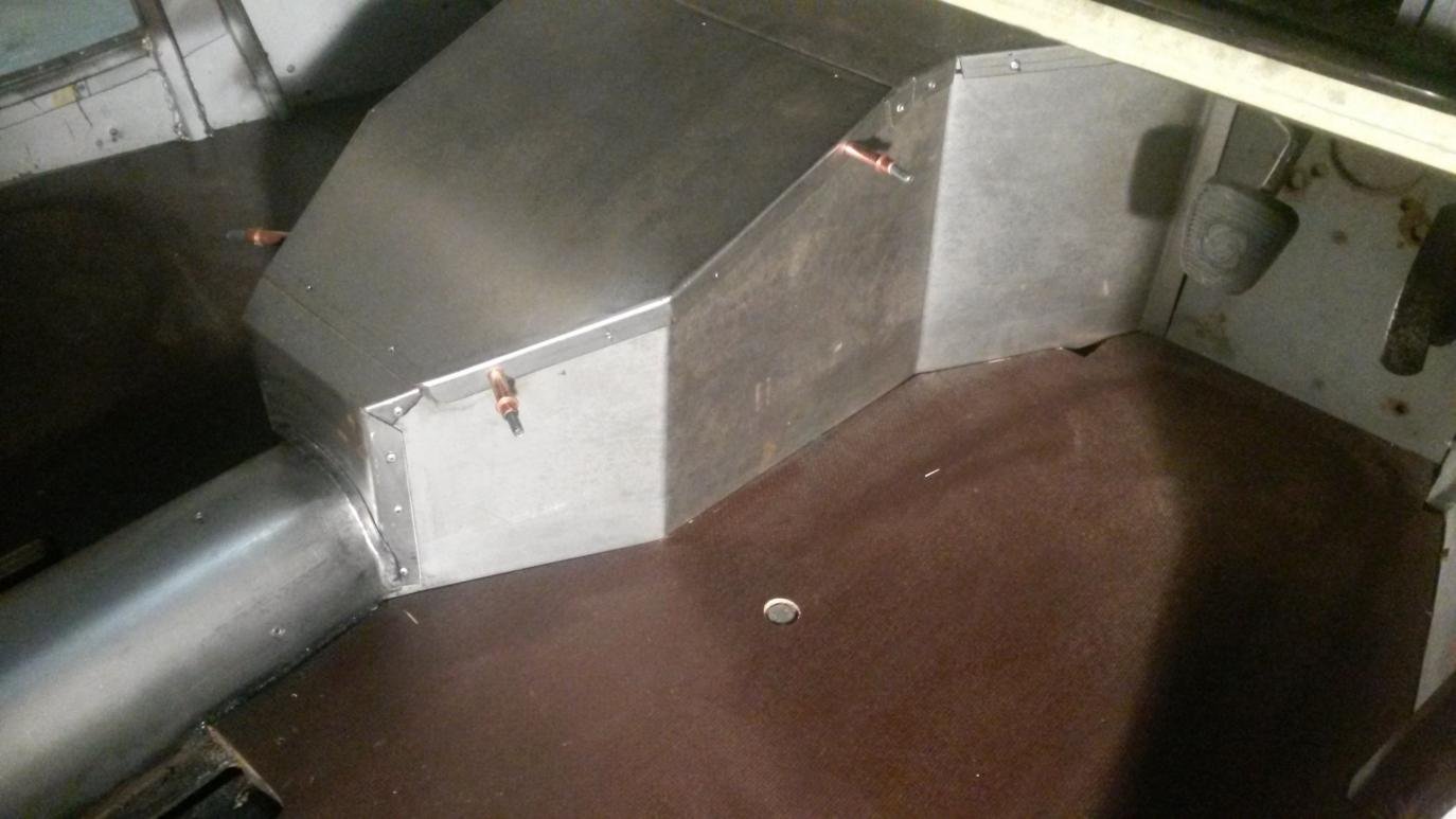

Managed to get some time today on the car bad weather love it. so have made the gearbox cover and prop shaft cover so moving on and can see some good progress, and in the week I have made the second door frame. The next job is to join the two half of the bonnet together.
