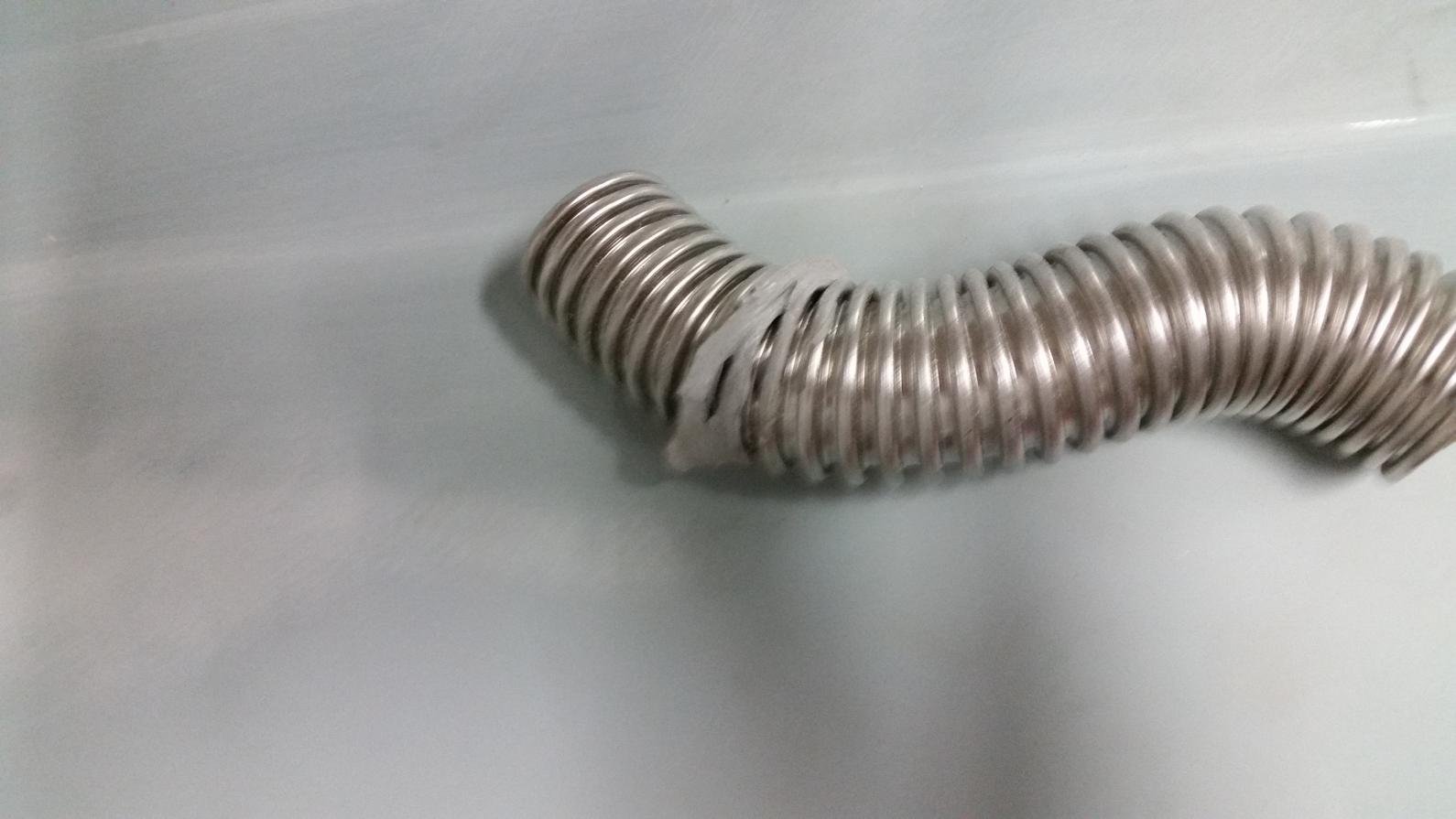

Cut a large section of the rear fender out to access the badly done fuel fill system of radiator hose and aluminum flex hose, all bonded with the adhesive (soft from gasoline fumes). Need to completely rethink this one.

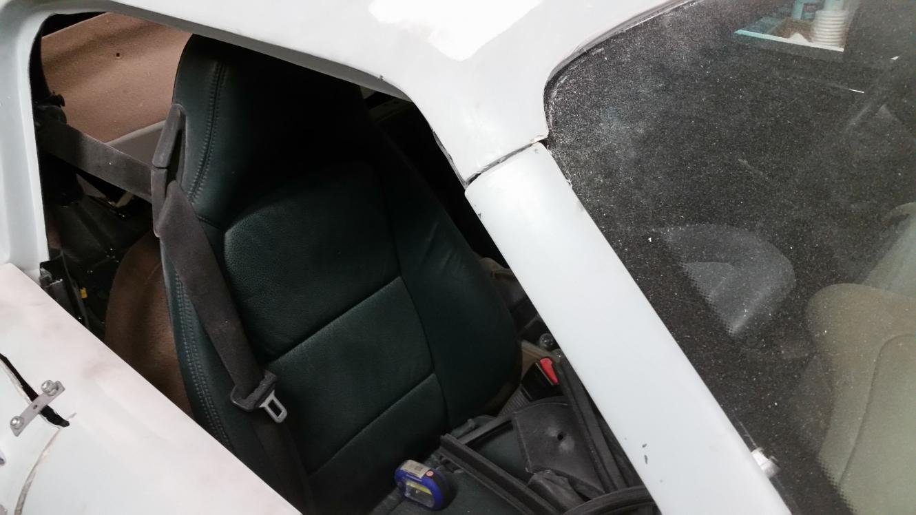

10 Aug 2018, 4:05pm
Here you go, without comment.
Attachment “20180810_113816.jpg” from the original forum could not be reliably recovered.
10 Aug 2018, 4:08pm
Thanks, good to see what can be dealt with

and another 1.25 inch aluminum radiator hose... jammed in with rubber hose and adhesive.
10 Aug 2018, 4:21pm
Did I mention that I need to mould a new small bonnet? Hadn't planned on rebuilding the body.
"Get a little help from your friends" as the song goes...
