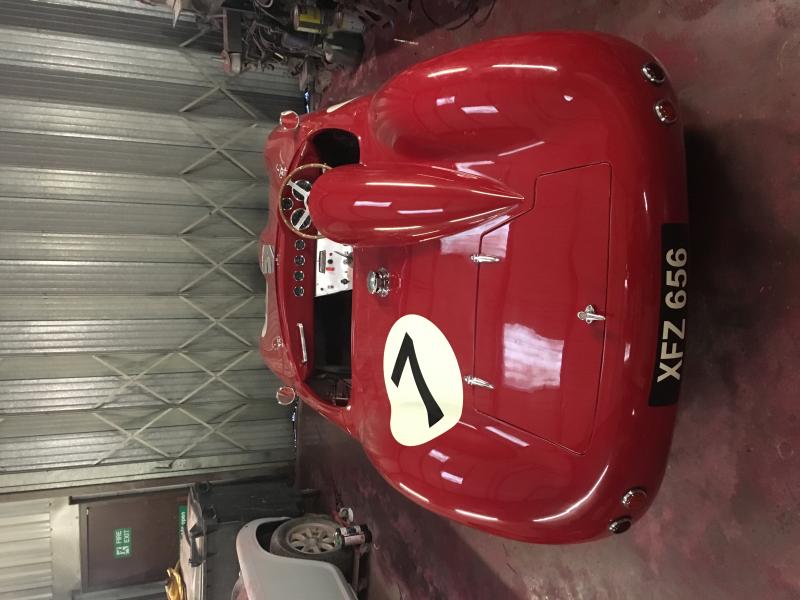

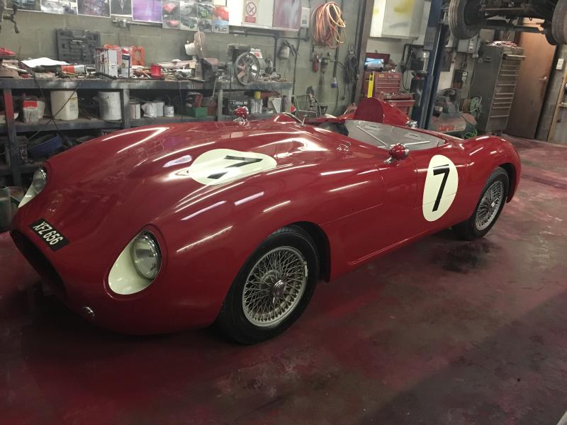

Good Progress now being made by Dave Thickins. I'm trying to work out how to post photos so hopefully this will work !
5 Dec 2018, 9:17am
I think it did ! Here's another...
5 Dec 2018, 12:11pm
Another well finished example, looks really smart. I like the old period number plate too, I wish I had something similar on my car. I suppose I can get some show plates made but that's not the same.
Is the paint Barchetta Rossa, looks like a darker red, good choice.
5 Dec 2018, 12:33pm
Still not finished, loom to complete, interior to fit, safety checking and tuning, MOT, etc etc all still to be done.
Yes, the colour is Rosso Barchetta. Hard to photograph as it looks a different shade in virtually every light.
