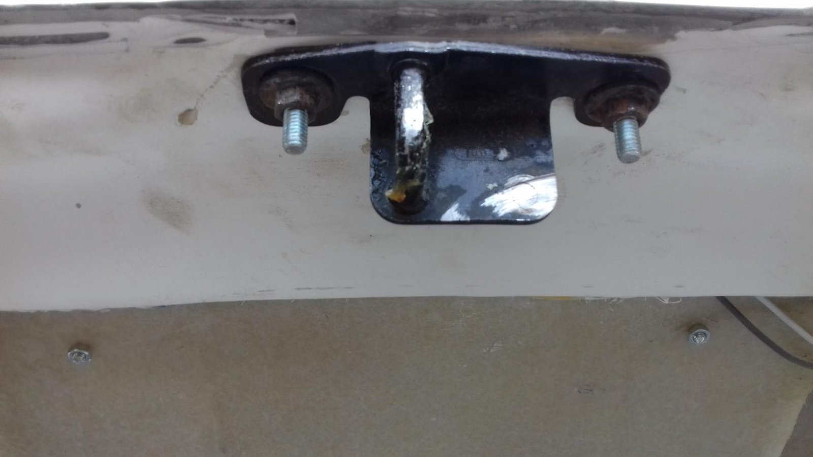

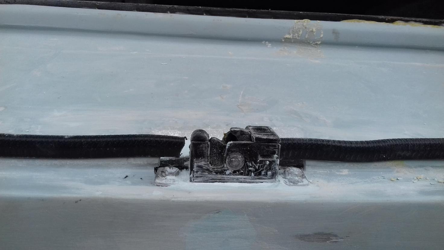

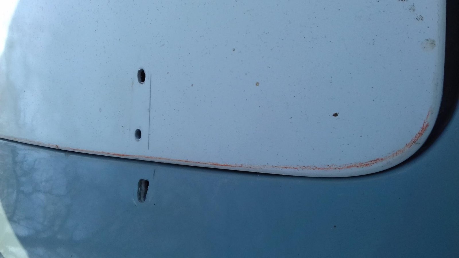

only difference using the z3 catch is its triggered from the new boot handle rather than a bar pulling it on the z3. The latch needed to be moved back when I set the boot lid back still needs sanding off but all works again

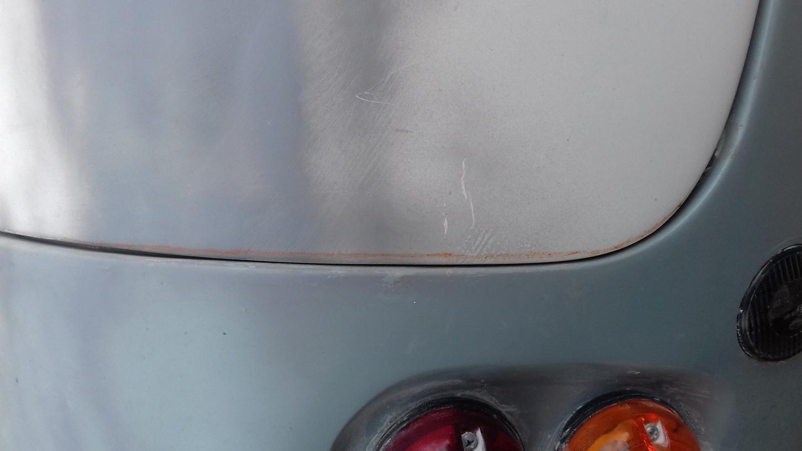

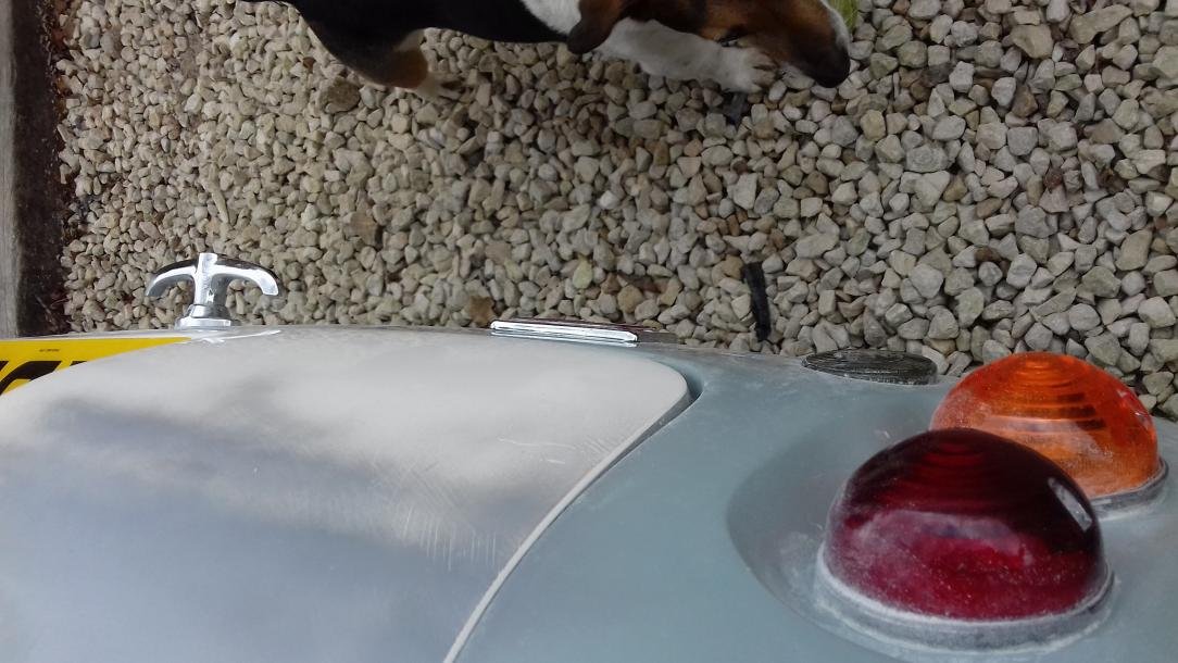

boot sorted
to be fair to Chris I will say that there is a lot that can make panels not line up it only takes one thing to be out 2mm when you bolting it up.

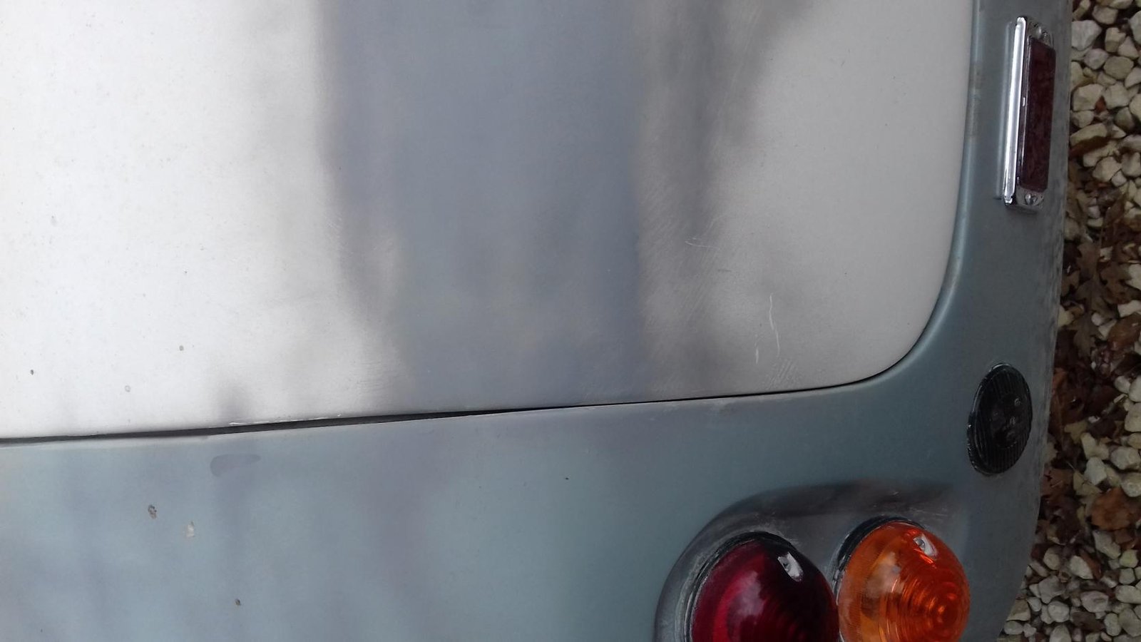

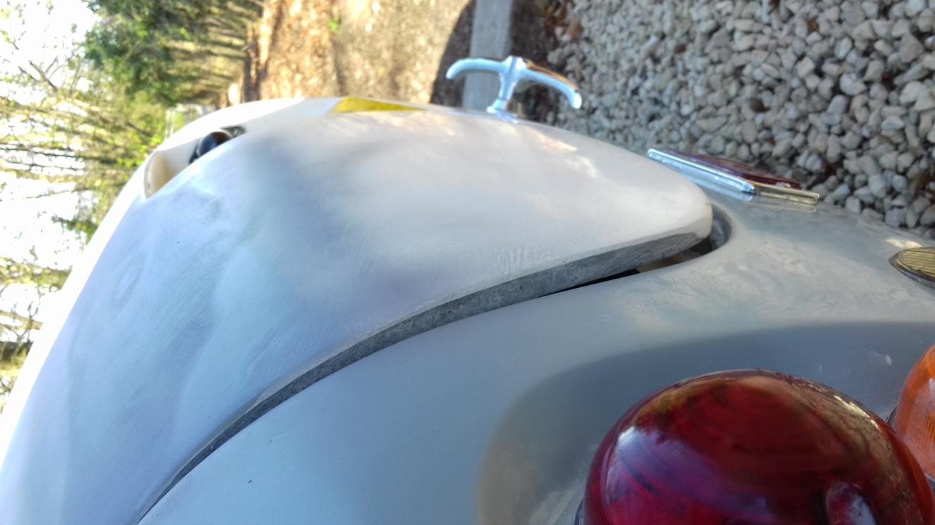

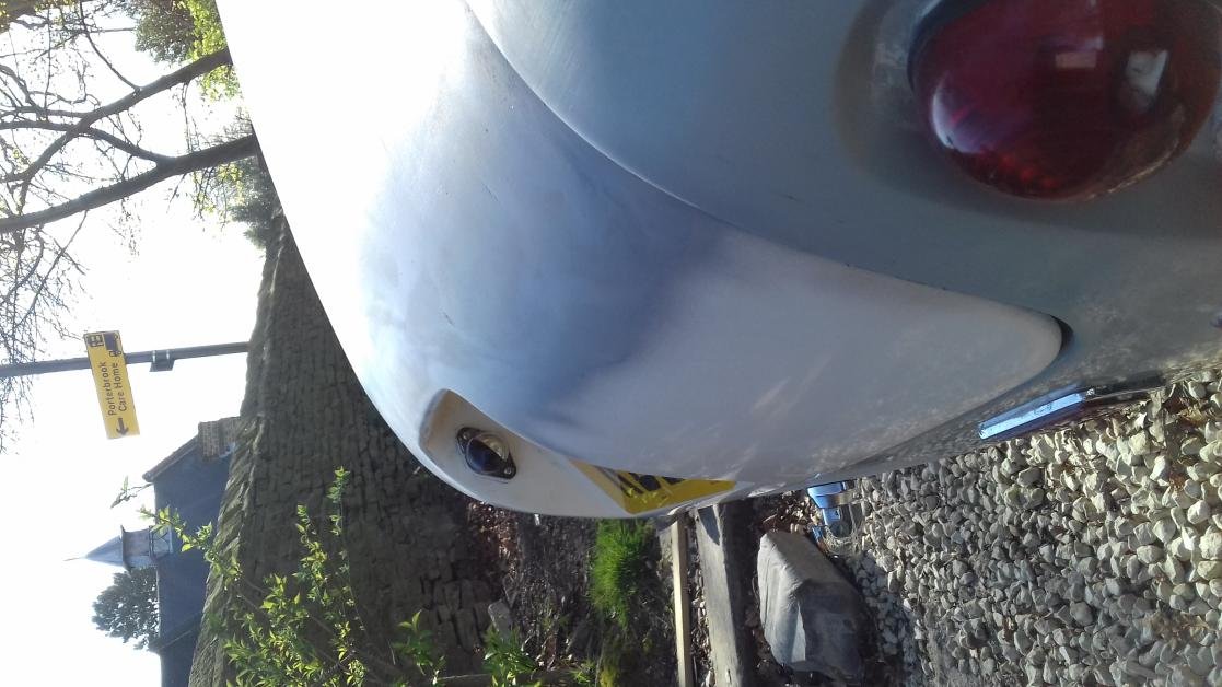

some before and after pics this is how much the boot lid stuck out only on the passenger side
I ended up taking about 10mm off in the end along the top hinge line the pencil line on the boot was only the first of two cuts.
this is down the passenger side
apologises the pics are not loading up as I see them on my lap top
10 Apr 2017, 5:33pm
we now have this good size gap all round the biggest problem was moving the lock in and getting it to line up again
more pencil lines to sand to
Attachment “20170410_152326.jpg” from the original forum could not be reliably recovered.
I changed the gaskets on the hinges they were made from like a card to rubber from an old inner tube. they come in handy when you need a rubber gasket I also filled the gap around the blots after refitting with body filler so it can not move again. this is how it now sits without a rubber seal I have it just not fitting it till after the paint

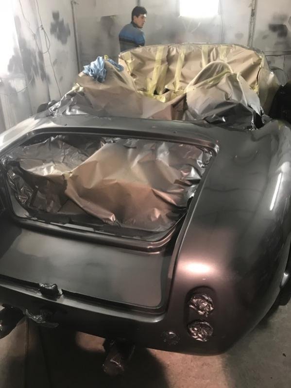

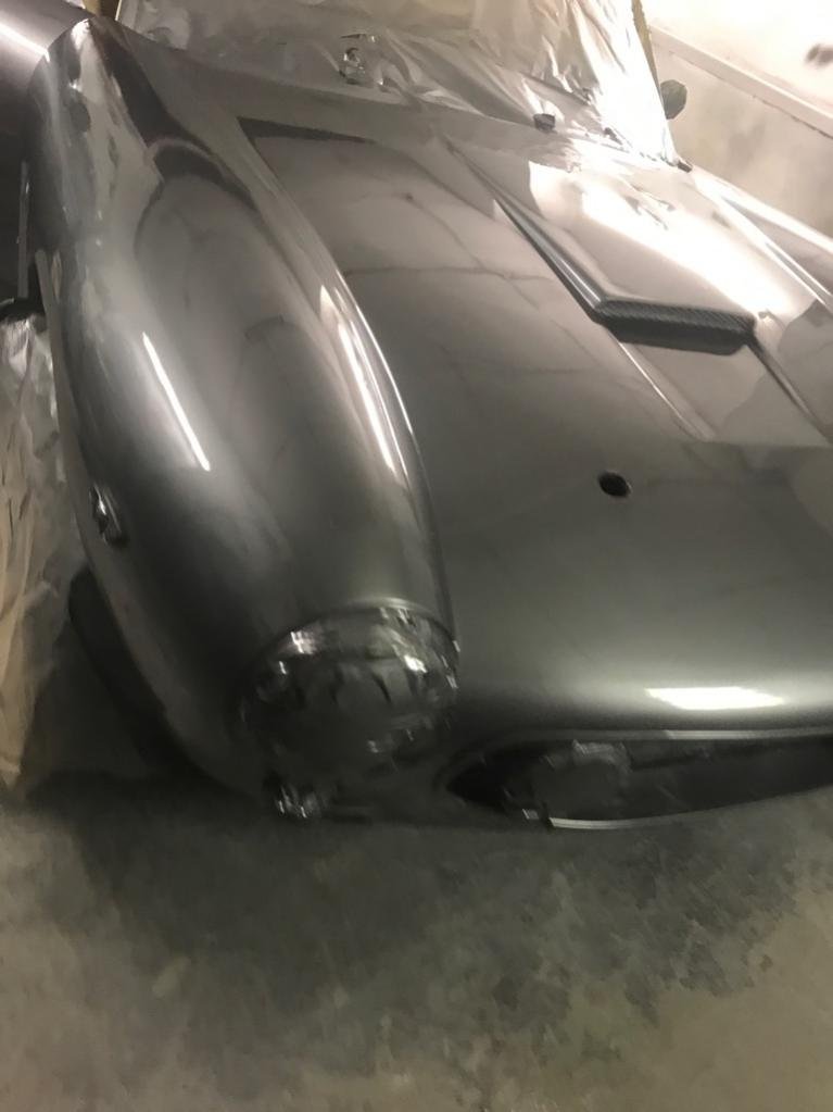

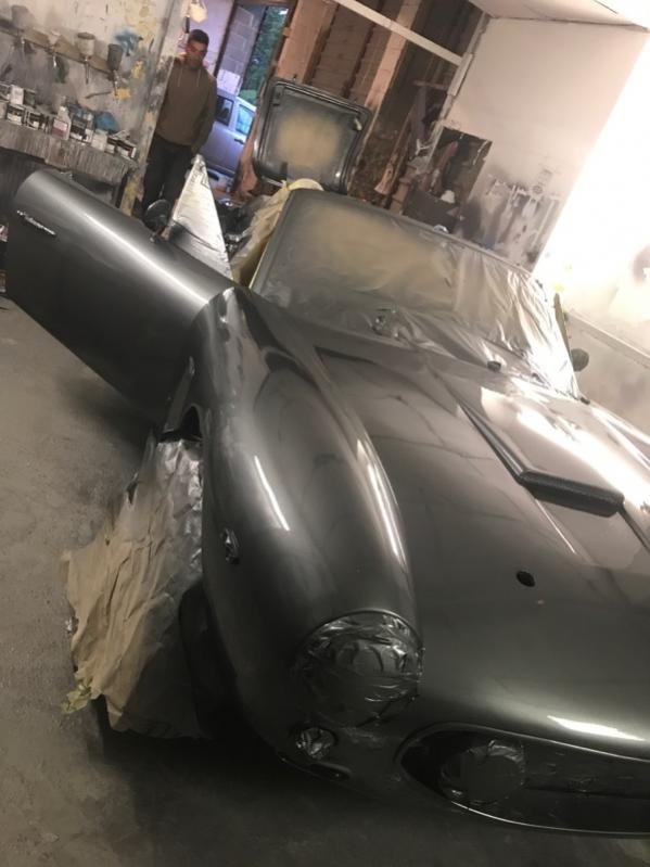

ok so finaly gone for paint
just had a message from paint shop will be ready Monday
23 Jul 2017, 2:26pm

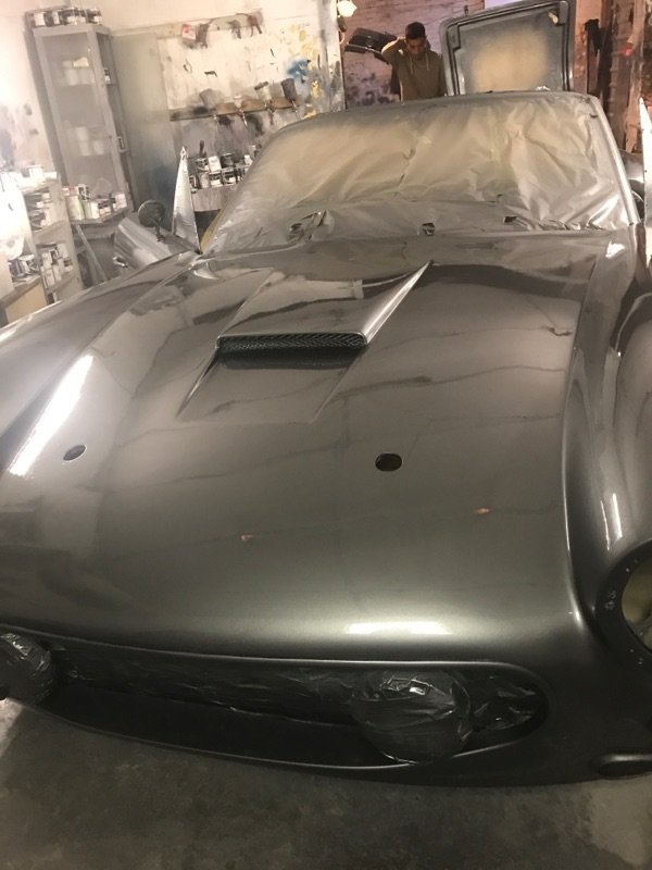

Looking good, nice colour. What are the holes in the bonnet for?
I still think the low door handles will limit its resale, although Peter Dinklage should have a few quid spare from his Game of Thrones money.
24 Jul 2017, 9:23am
nice colour it will go well with the red hood , any progress on the pick up ?

What are the holes in the bonnet ??

I think the holes are to fit the nipple rings :icon_eek:(well they are fasteners of a sort) shown earlier. As the bonnet is one piece, presumably they are for show?

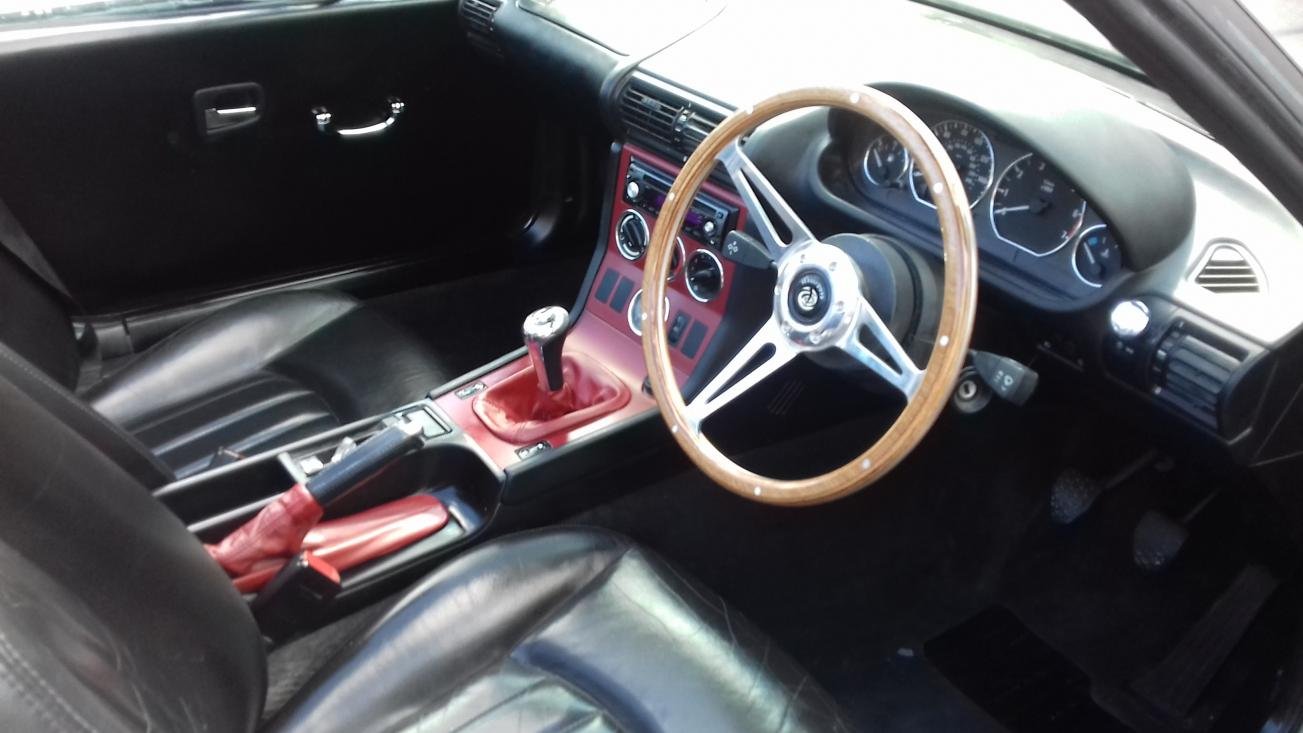

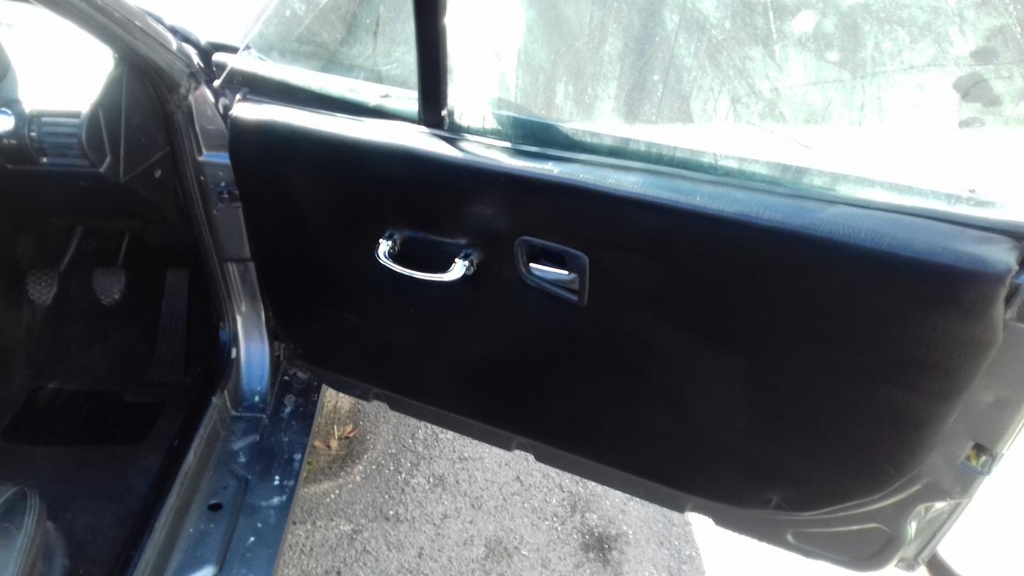

I hate washing cars
apologies guys I dont seem to be getting any reply's from the thread. holes in the bonnet are for the poppers that hold it down . finally got around to giving it a clean and fitted the door cards.
alternator is playing up intermittently so need to get one sorted then shes up for sale. start looking for another as you do.

Andy, can you post up how you did the doorcards?
think they are on page 2 , bit of card make a template for the top I used a bit of square drain pipe cut down to give me the corner .
