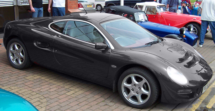

Back from the painters...
4 Dec 2006, 11:49pm
Yep, very nice :thumb: Graphite coloured wheels or normal?

5 Dec 2006, 10:55am
I'm going to stick with the standard wheels for now as they are, will look better once the ride height is set properly. I'd like some colour coded centres and polished rim 19" split rims but my budget can't stretch to that right now! There isn't much room on the phantom for wheels, they need a big offset and that awkward 4x114.3mm bolt pattern unless you change the hubs...

5 Dec 2006, 11:04am
Looks really nice :D

Nearly finished, I plan to have screen in and get it MOT'd in the next week or so. Headlights are now finished and I'm very pleased with the result! After MOT I'll get it over to the trimmers to do the carpets, dash and centre console and then that's it, daily hack duties will commence!
I've been doing some of the trim myself:
