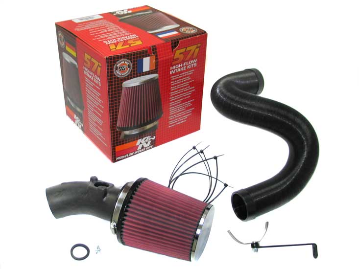

Sat with a beer and thought I might make a start on a Cold Air induction System.
Not altogether sure what that is but it does involve flower pots apparently.
First, examine the situation
identify the air box
Find the two bolts that hold it in place and remove them
Undo a couple of spring clips
and the box pulls out easily
Leaving a flange to attach whatever I build and a big space to fit it
Direct feed of cold air from the front
That is perfe3ctly lined up with the Z300S vent
I will not extend the system to the front as I intend to use it with both the Z300S and the SWB bonnets and the SWB is noticeably shorter.
More updates tomorrow after I have slept off the Duval

I think you should- isn't that the front bumper shock housing? Can it be used as a duct up to the MAF???
7 Aug 2015, 7:50pm
Someone PM'd me to see if I could use the bumper shock as an air feed. I replied
It is the bumper shock but is closed. I don't want to use it as a duct as I am not yet sure of how my SWB bonnet will fit.
I am thinking of a ram air feed going to a shrouded cone air filter.
Air filter gives great induction noise and ducting gives cold air. If it needs different ducting for the different bonnets that is easier to change.

Nick, your new K&N filter uses oil to help trap particles effectively. Following a web search you'll find many people complain that over time this oil contaminates the hot wire in the MAF making it U/S. I've fitted K&Ns to many cars without problem, but just in case you might, you could remove the MAF and temporarily fit the filter, do a few miles using wide open throttles to suck excessive oil from the filter, then refit the MAF and filter assembly. A problem, is that this could make the CEL to come on, though I believe the correct signal received by the ECU when restarting the ignition with the MAF reinstalled will extinguish the light.
I suppose an alternative would be a quick puff of compressed air to blow out the excess oil before fitting the filter. Careful, Not too much!!
Looking forward to the how to guide and hope the bill hook will make a reappearance :smile:
Steve
8 Aug 2015, 5:03pm
i have seen the warnings about the MAF wire. Check out this video and the garage guy says it can be particularly bad for turbos as it makes the engine run lean
https://www.youtube.com/watch?v=PAIxeQUSg-Q
I found somewhere else (can't find the link now) that cleaning the MAF wire with a squirt of alcohol and a cotton bud about once a year solves the problem.
I will fit the filter, take the car out for a thrash and then try to clear the MAF wire to see how bad it gets.
I will post a video on my YouTube channel.
8 Aug 2015, 5:21pm
Prevention is better than cure :wink:
