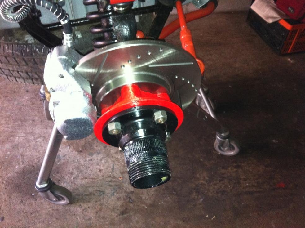

Humpty Dumpty with Wires

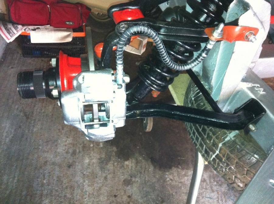

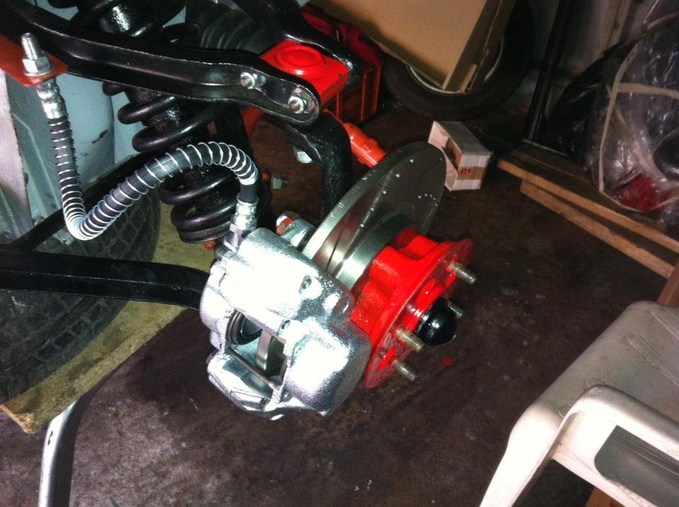

Got a great deal on the Hubs and spinners but have found them to be the short type.
The add did not say for 13" wheels only. I have 15" which need the longer hubs. Not to worry that all part of doing your own build, making mistakes and making them good. So they will be back on ebay soon and replacements ordered.
17 May 2015, 5:02pm
Chassis looks nice and fresh. The short splined hubs are a lot cheaper than the long ones but like you say, will only take the 13" wires. It's a common mistake which has also been made by the seller of the Miglia that's ending this evening on ebay.

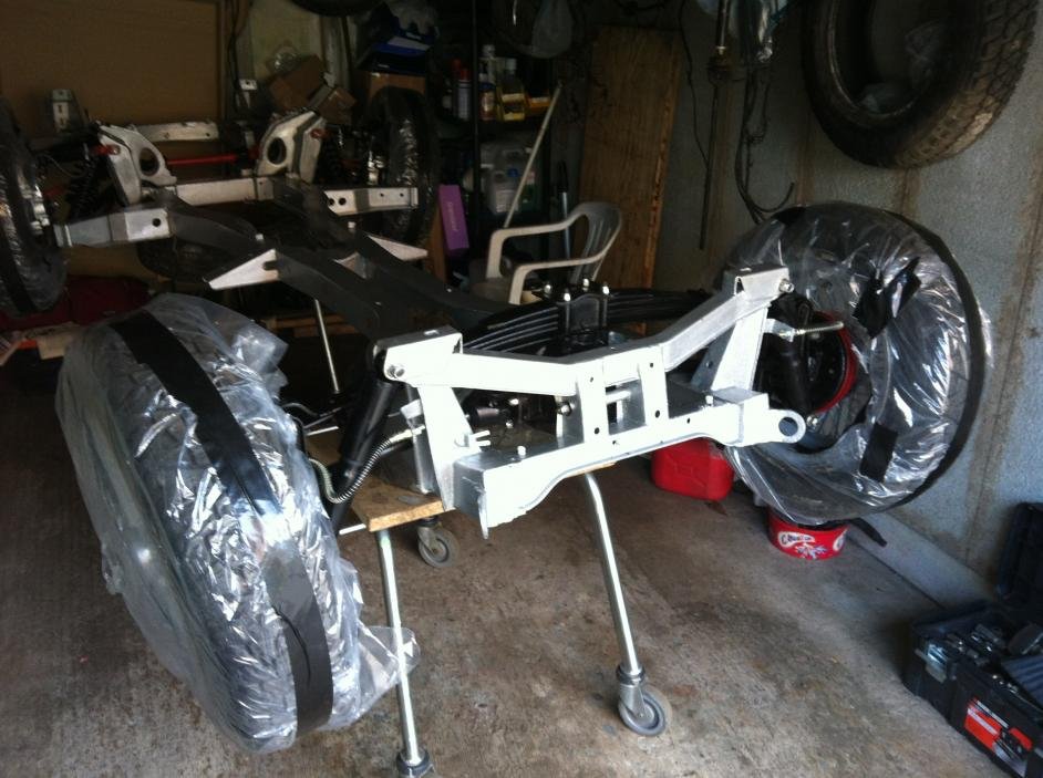

17 May 2015, 6:27pm
the build continues
With the chassis on hold till I get my subframe, its time to look at the electrics and wiring of the engine.

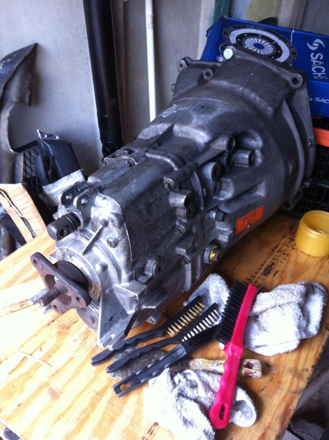

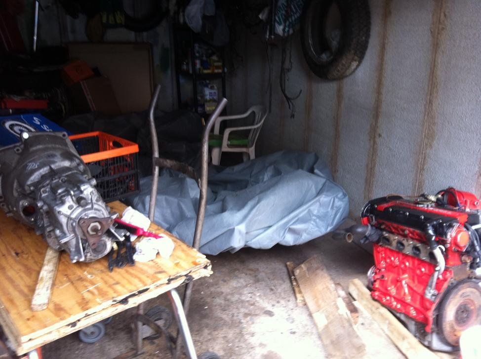

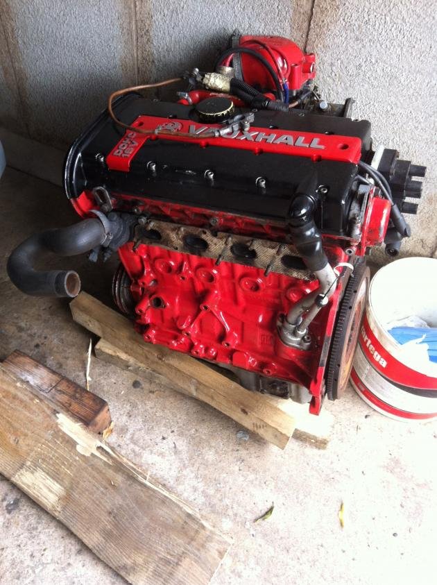

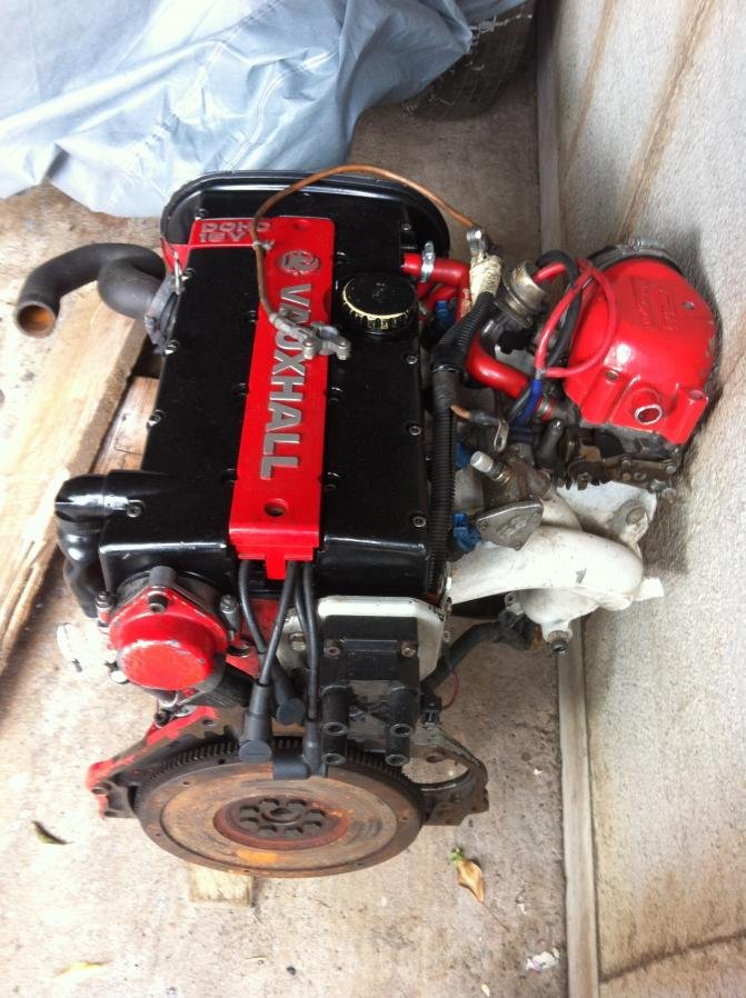

Ok I have this race prepared Redtop engine with a BMW E36 five speed box.
I need to get them cleaned and joined together and tested ready to drop onto my extended chassis.
A few days off this week, rain is forecast so no reason to go driving.
Anyone ever done this combination?
I had intended to use a ford type 9 box but the racing boys are grabbing them off ebay for stupid money.
This should do the trick at a fraction of the cost and the bell housing matches without ordering from racing specialist.

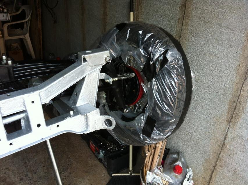

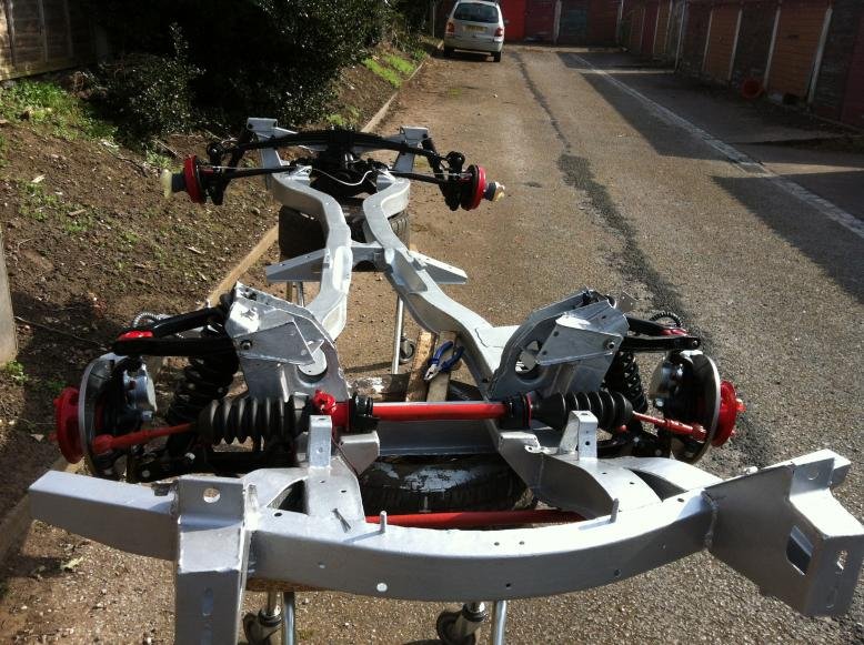

clean chassis
Yes Towed, I'm really pleased with the final look of the rolling chassis. Only wish I had given the extension more thought previously. All is not lost, I will set up my engine and gearbox ready this week. I also have to build the engine mounts, reshape a standard exhaust to compensate for the front wheel drive engine being used as a rear wheel drive unit.
All been done before so I'm not creating anything new, but using the best ideas of whats been done previously.

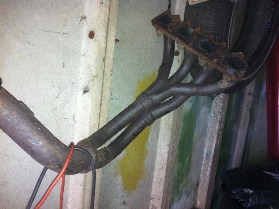

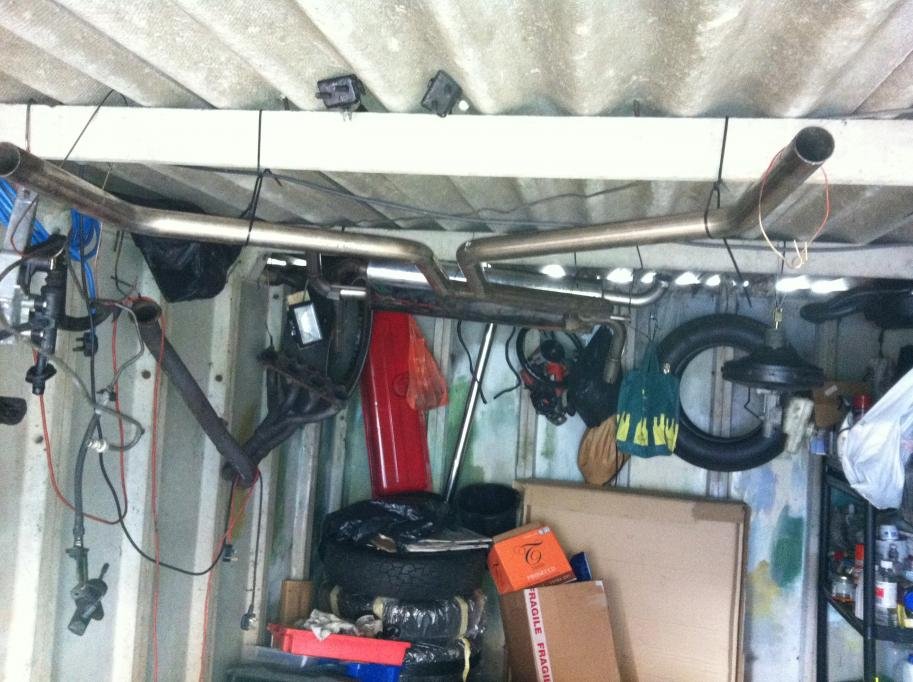

The roof of my lockup is filled with wire, stainless steel exhaust units, the walls have ECU units and wires, steering columns, lots of everything.
The good thing is I've been buying lots of bits on Ebay for the past nine months so I have most of what I need, just have to put it all together.

Mate your engine makes mine want to scurry back to the museum where it belongs

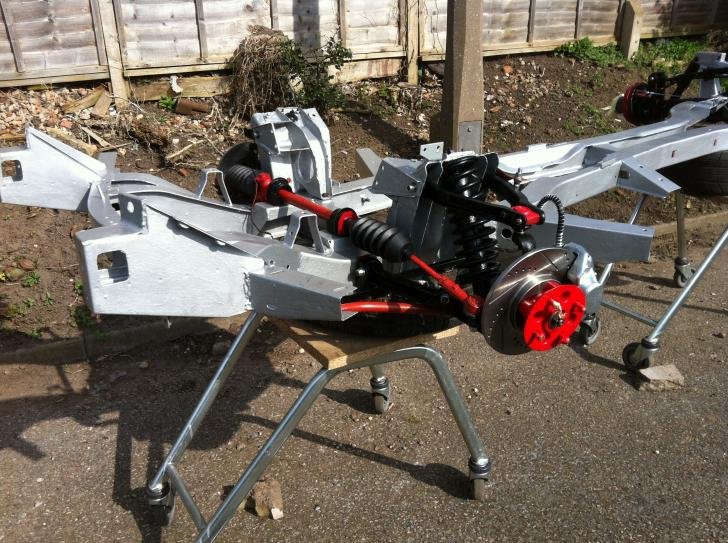

So after a long absence, when other projects were completed, my tools being stolen again, then there was Covid 19 lock down, I am back with my build.
This time I have replaced my Spitfire Chassis with a Vitesse Chassis which had been dry stored for thirty years. In great condition as my picture will show.
I had to exchange all my previously renovated parts in order to get this great chassis so the strip down, clean and replace worn out areas has begun.

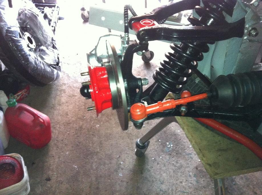

So Chassis bare metal and painted, suspension and running gear cleaned and uprated.
So the build which should have taken two/three years continues.

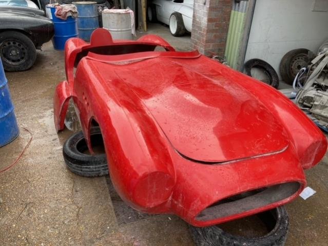

HELP !!!!
Can anyone help with my pictures posting? Also some picture format uploads on some of the other threads I can't open? I have tried both my PC and Apple laptops. Do I need to switch on an extension? HELP !!!!!
