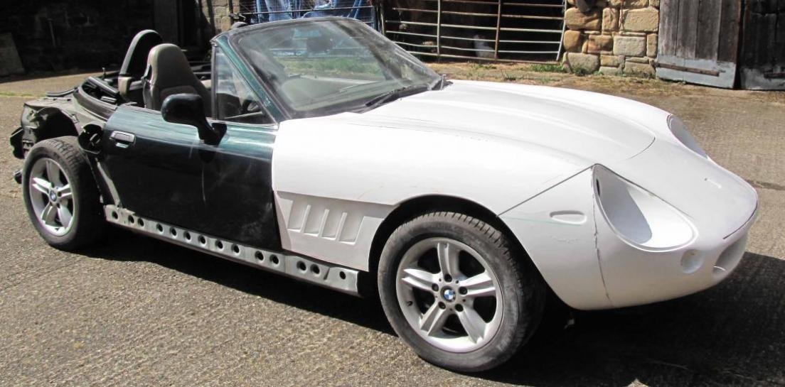

Here is a review of how things are looking:
[/ATTACH]

275 / Z3 return to progress
Hi All,
First of all, a big thank you to all those who sent me PMs and emails wishing a speedy return to full health. I haven't been idle while being laid up and have done a lot of thinking.
So, Plan B: I have abandoned the concept of retaining the Z3 one piece lift up bonnet and wings because I thought it deviated too much from the spirit of the 275. It does mean that some maintenance points (brake fluid, windscreen washer etc) will have to be accessed via fuel filler type flaps unfortunately. I will post photos when I have got something to show.
In answer to a specific question, I also thought it appropriate to post a photoshop comparison of the Mercedes SLK and the 275 profiles to show why I abandoned the SLK as a donor. Although It has the right wheelbase (in R170 model years) and the configuration looked about right, I was daunted by the prospect of removing the screen and surround and fabricating a replacement. (A replacement screen for the 275 is available for the the 275 - if you don't mind the £1500 price tag.) When Bertini and Tribute Automotive showed how easy it was to remove the Z3 body panels and avoid the IVA, I decided to follow their lead. Maybe next time....?
3 Sep 2015, 9:32pm
Fibreglass and sticky tape
Hi All,
I have been doing a fair bit of fibreglass hacking with an angle grinder and sticking the panels back onto my denuded Z3 with parcel tape. There is still much to do to get it right but it looks like this is the way to go. Sadly, the characteristic long bonnet of the 275 has had to go and the rear quarter has been extended forward. I did this by laminating an extra sail(?) panel - the bit above the rear wing and behind the door - and just sticking it in place for the photo. Compare img3495 with the standard wing IMG3496 which will need a piece of Lexan to the rear of the side window. She who must be obeyed says she prefers the more stubby look of 3495. If there is anyone who wants an authentic 275 shape, AutoMirage are making their own chassis for a 250GTO and the 275 body will probably fit. Maybe next time?

11 Dec 2015, 5:26pm
(A little) Progress
These pictures (which I can't upload at the moment) may not look much different from earlier ones but I have been doing a lot of cutting and adjusting to get to this stage. My big "Aha" moment came when I realised that the only place where the Z3 panels met the 275 panels was at the sill. I had to extend the Z3 sill outwards as the it is "waisted" but the 275 doors have a straight bottom. (Ooh er!). This meant I had to make a mould for a new horizontal part of the sill from thin ply but I did not know that oil based paint reacts with cellulose paints and had to repeat it several times until a friend told me. DOH!
All the panels are held together with metal straps or tape at present to check the fit and appearance. There is still a lot of cutting and sticking together to be done but all my guesses seem to be working out so far.

16 Jan 2016, 11:03am
275GTB/Z3 side panel
Happy new year everyone! I have been concentrating on the panel behind the side window and have decided against an infill with either a fibreglass panel or an extra window.
Instead, I have chosen to make a copy of the side panel incorporating the gills and move it forward to the door opening. At the same time, I was able to adjust the angle very slightly to match the angle of a new side window which I hope to make from PolyCarbonate. Does anyone know if you have to get it E marked for road use?
