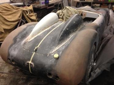

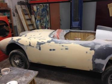

Fixing last problems on body :
- Widening rear fenders (standard body is too narrow for wire wheels for 2CV)
- front fenders are curved inwards
- hood needed adjustment of the curve in order to follow the headboard curve
- roundness of wheel arches
And also constructed and fitted the scoop - made from the mould which I borrowed from Michiel which was his wife's vase I believe..
I was pleased with the result. The scoop was needed as I would not be able to close the bonnet..
Cheers,
Marcel

some more body adjustments..
These adjustments have caused a lot of time (=delay), many liters of resin and $$$$$..
If I had known, would not have bought the body...
stitches at rear fender
Attachment “IMG_2591.jpg” from the original forum could not be reliably recovered.
fender not straight - bends to inside..
preview in the body shop
cutting the bonnet will allow me better access to the engine

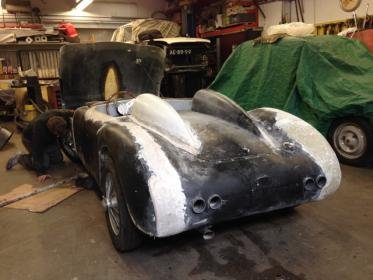

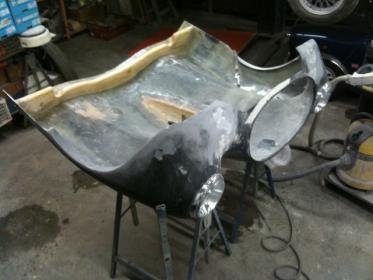

19 Jul 2015, 2:16am
finally to body shop!
Some further serious modifications were needed to get a straight and solid bonnet.This needed to be done by a pro and he braced the bonnet very good and it feels very solid now. did add a few kg's...
He mounted the bonnet on the body and completely filled the gap and recut it in a very straight way.
Again also much filler necessary for straightening sides..

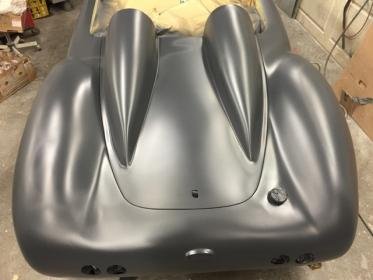

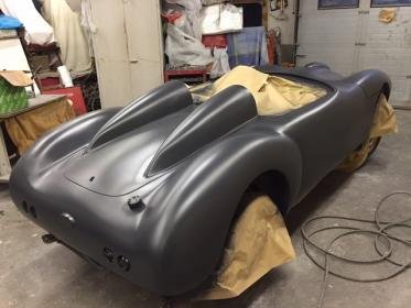

19 Jul 2015, 2:24am
Batmobile 2CV?
When the first coats of matt black were applied I started to doubt the color I had chosen and maybe I just should leave it that way... it looked fantastic and also the body was super straight.
Attachment “IMG_4882.jpg” from the original forum could not be reliably recovered.
Attachment “IMG_4966.jpg” from the original forum could not be reliably recovered.
I
could not have imagined that the bodyshop was able to get such a great smooth and straight finish.

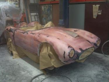

19 Jul 2015, 2:40am
2 CV in body shop
Now it really started to come together all that hard (and invisible) work. Still a lot of new filler and grinding, grinding and grinding...
The body shop did not have a professional paint booth but for sure a creative and smart painter and made his own paint booth!
To me this was most exiting part of the build.
Color is RAL 3004

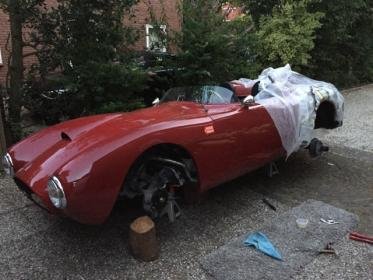

19 Jul 2015, 2:51am
final assembly!
Attachment “IMG_5045.jpg” from the original forum could not be reliably recovered.
Attachment “IMG_5293.jpg” from the original forum could not be reliably recovered.
Attachment “IMG_5417.jpg” from the original forum could not be reliably recovered.

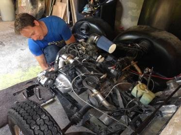

Back in my garage I finally could start on the last jobs.
Still plenty of work to do - basically the whole interior had to be installed.
Also some electrical work still needs to be done as the turn signals do not yet work..
But it is really coming together and I'm very please with the color. My wife warned me not to paint it "midlife crisis red" and she was pleased to see this sort of 50ties era dark red.
I used a rubber profile (normally used on stairs steps) for the cockpit edges and mounted most of the chrome pieces.

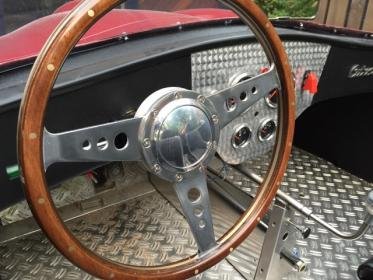

Final assembly 2cv Sammio
I made a new grill from aluminum(which I still have to cut to size and install) which weighs less then half of the "doormat" that was provided originally with the kit.
Also had to paint the inside of the wheel arches and many other small jobs:
- Had a steering wheel adapter made for better steering position
- relocate the exhaust mounting point at the rear
- Test fit of first decalls
- mount the wire wheel adapters and wheels
- install anti roll bar on the rear
still lots of stuff to do before it is roadworthy..
New grill on the scale!
Attachment “IMG_4689.jpg” from the original forum could not be reliably recovered.
Painting wheel arches
finished steering wheel
installed main electrical switch
Attachment “IMG_5420.jpg” from the original forum could not be reliably recovered.

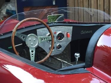

final pics of sammio 2cv
Here are the last pictures, taken last week before I went on vacation. Sorry but I just can't make 'm bigger. One size bigger and they go over the allowed max size. Must be a MAC problem..
Attachment “IMG_5421.jpg” from the original forum could not be reliably recovered.
Attachment “IMG_5422.jpg” from the original forum could not be reliably recovered.
Attachment “IMG_5423.jpg” from the original forum could not be reliably recovered.
Attachment “D24.jpg” from the original forum could not be reliably recovered.

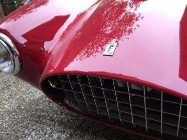

Pininfarina was body supplier /designer of the original Lancia D24 on which the Sammio design was based on and decided to use their badge
I have some roundels with the number 77 as this was the body number Gary Janes told me it is.
I'm not sure if I want to put them on as the car looks nice as is..
