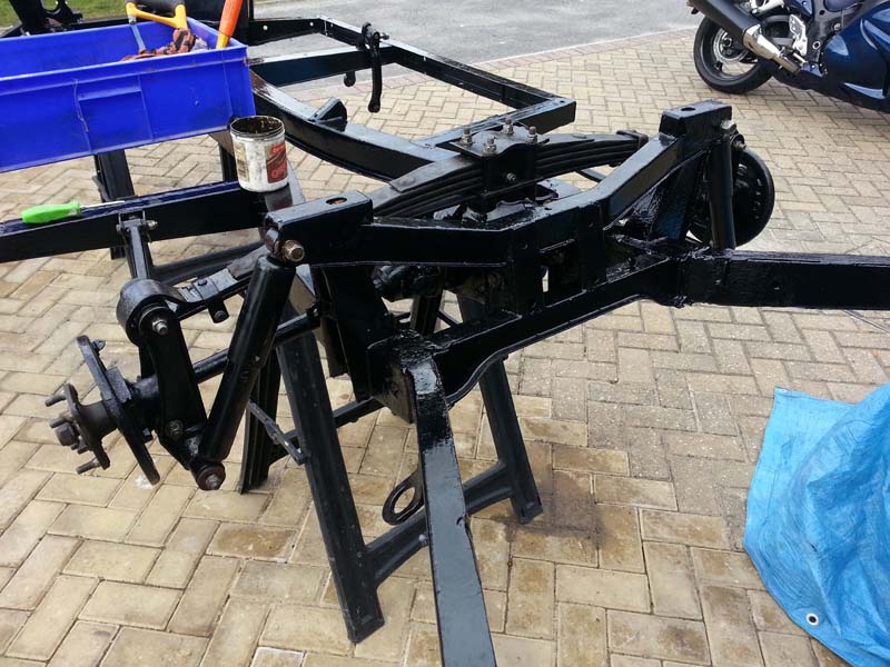

Anyway, small update as I managed to get some time in between the rain showers this weekend to strip the chassis down, clean it up and get a first coat of chassis black on it in the back garden!
[IMG]http://www.mymigliaspeedster.co.uk/build/2013-03-17 - Chassis/2013-03-17%2017.06.54.jpg[/IMG]
The bits stripped off the chassis were dunked in the parts washer, dried off, and then given a coat of chassis black too. A feeling of deja vu as it was about this time last year I had the same picture for the chassis of my sammio spyder!

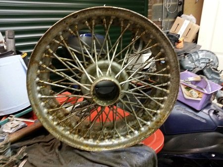

I did pick up my wheels today. I bought six 15" wires off ebay for £100, and sent four away for blasting and powder coating.
This is the before...

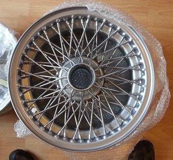

I went for the standard silver wheels this time - my last Sammio had black wires. So this is what they are like now... At £35 per wheel, I thought that was a good deal.
23 Mar 2013, 5:03pm
wheels look fab. Do they fit the MG splined hubs?
Yep, they fit the longer adaptors.
I will get them from MWS in Slough as they are just round the corner from my office.

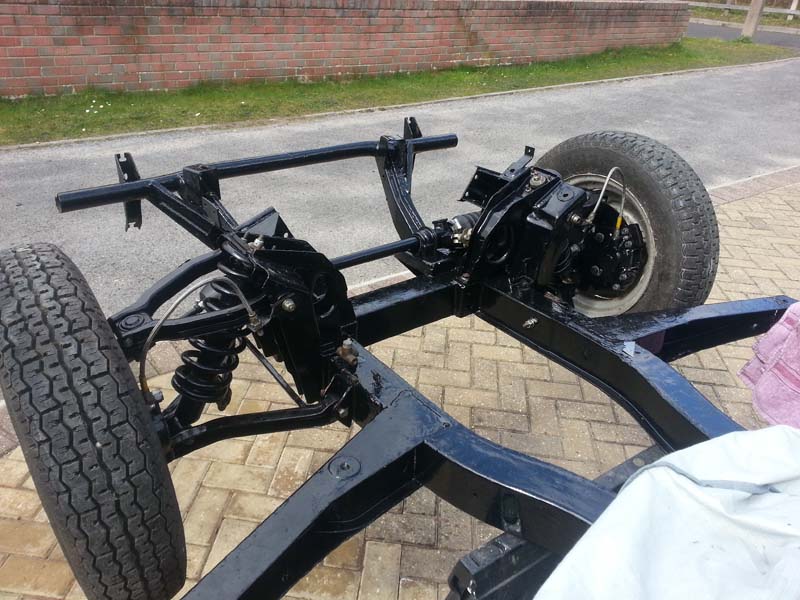

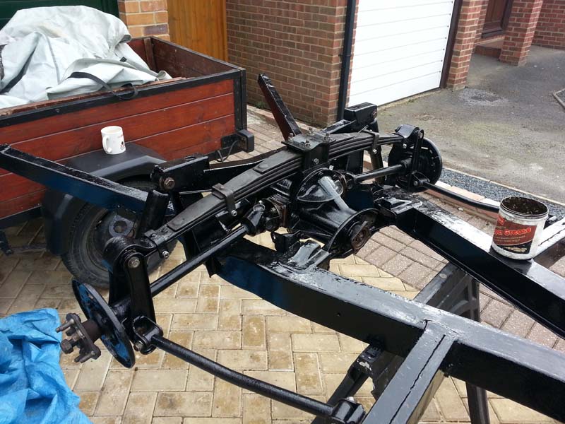

Got the rear end together.....
As you can see I have put a swing spring in and I haven't got my lowering block yet, so that will go in next week. I am going for a 1" block as that was my sammio was with 15" wheels. May need to go more, but I will wait and see. It is relatively easy to get to when it is built up anyway (my sammio took about 4 attempts to get the ride height sorted!)

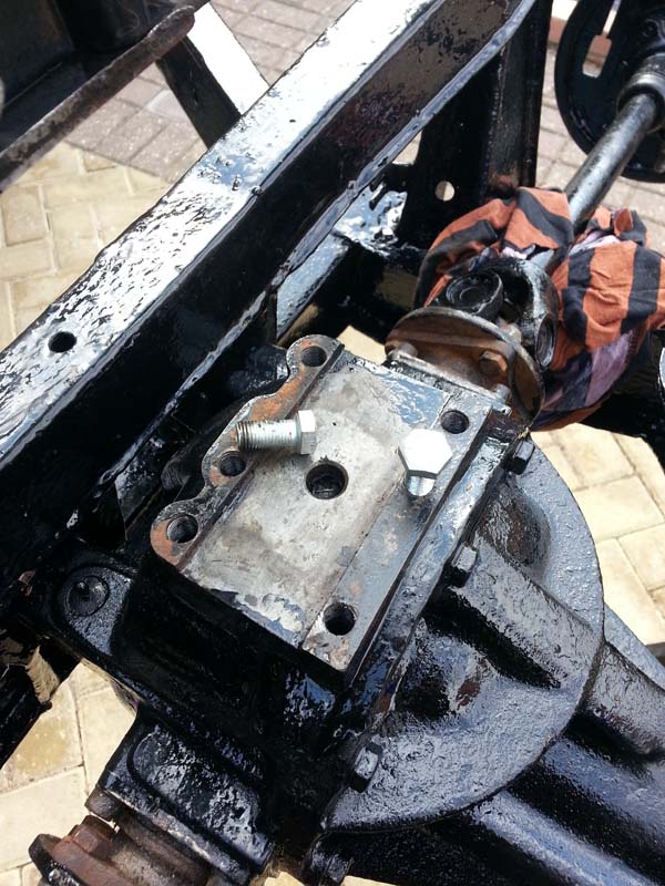

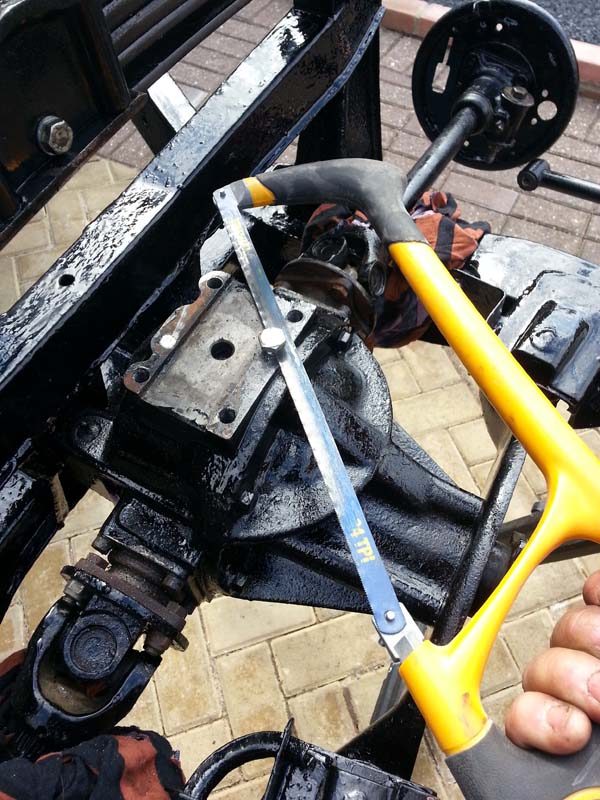

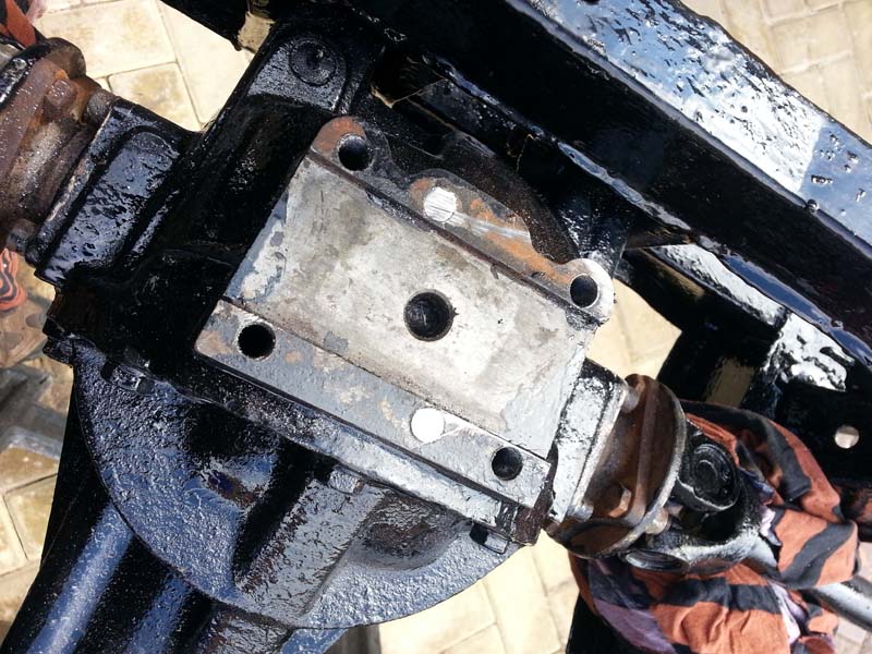

Anyway, one thing to remember if you are going to convert to a Swing Spring and that is to block up the 2 holes that are not used in the diff as the Swing spring only has 4 bolts and not 6.
I used a standard bolt which I crimped the thread a bit with a hammer. this causes a friction fit with no chance of it undoing and dropping into the diff!
Wind the bolts in and then hacksaw off the head flush with the diff casing.....
And viola - two blocked holes! :rockon:

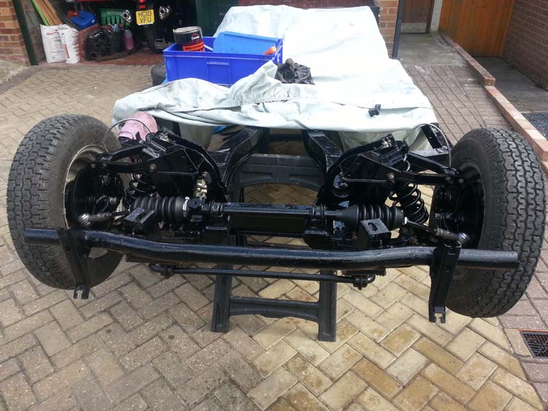

A little further today, just had a couple of hours before I had some other stuff to do, so I finished off the front end...
Got the rear brakes to sort tomorrow morning and then it will be rolling! :eusa_dance:
It's got the standard wheels on at the moment as I need to get tyres and adapters for the wires..
Brake pipes and fuel pipe on Monday, along with the engine and gearbox I hope.
