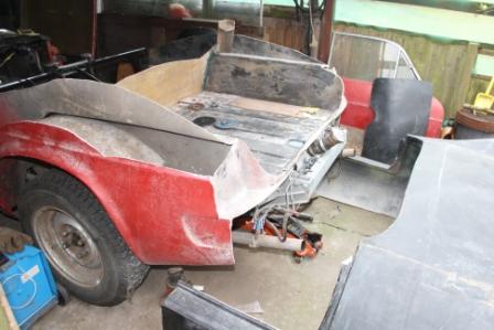

23 Aug 2013, 9:05am
August update
Guys,
I have swapped a holiday in Greece for a week at home on th G46.

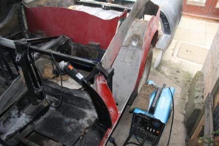

Like mike I have had starter problems so it has been stripped and all the rust and corrosion removed and reassembled so it works on the bench.
I will fit it today, so hopefully can get the motor going and move it out into the sun.

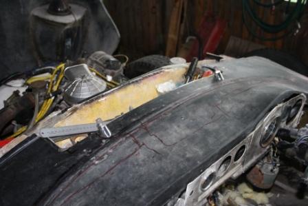

However, I managed to get the bonnet to hinge on the headlight pods, but not sure if the gatehinge is strong enough quality.
I worry about a flutering bonnet at 70mph. Before I glass over it should I get a more robust item?
The final plan is a lift off bonnet with a pin through the headlight pod, but this will give me access and make moving the car a lots easier.

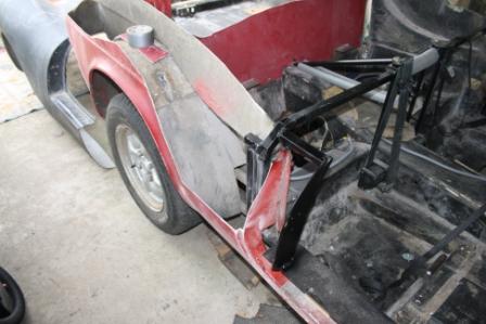

I was not happy with the proved frame simple bolting to fibreglass with no actual contact to the main chasis.
So I have managed to weld the old roll over bars to the supplied frame.
I will do simiar with the A posts. I am also thinking of a race to the rear chasis. is think over kill?
I now need to think about seat belt mounts.
I do like the solution used by Mr Towed where the passenger and driver inertia belts are swapped and mounted centrally.
This stops them getting stuck in doors and requires only 1 strengthened point high up in the frame.
Do you have any photos or that area?
I have manged to make use of the old a frames and scimitar hinges.
However I need to find a way to mount the door to the hinge.
Ideally I want a steel beam through the door to the door catch, similar to the TVR.
I hope to use the old scimitar door lock/catches.
However I believe special burst free catches are required on open top cars.
Aa a pot hole on a high speed corner could cause the door to open and the body twists.
Has anyone experience this?
Cheers HM

I made a small sub frame to hold my belts and mount them centrally. I wanted to make it IVA compliant, even though I didn't need one as I took my sons out in the car! Here's some pics of how I did it on a Spyder in case they can provide inspiration?
23 Aug 2013, 1:13pm
seatbelts
Dave,
Thank you very much a photo explains so much.
I like the way you have introduced stand off on the top bar to raise the hight of the shoulder straps.
It apears there is no need to trianglate the point where they attach in the middle.
I presume this is because the square frame has enough strength and that if the forces are strong enough
to bend the frame you internal organs would not survive anyway.
I was getting carried away with lots of cross braces compromising my luggage space.
when a couple of piece of flat bar from the floor to the anchor point will survice to mount the reel.
HM

I have still added a brace bar to take the forward backward loads from the top sqare section frame.
There was about 1/2 of flex in the middle before I added the brace bar.
Totally solid now, although it would strengthen up when the top bar is bonded to body.

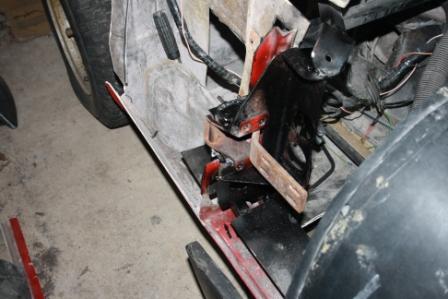

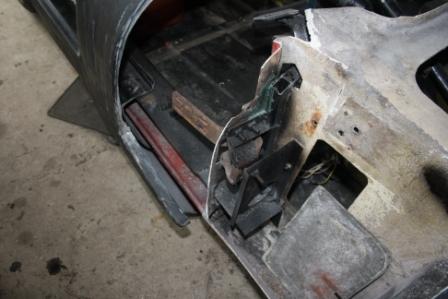

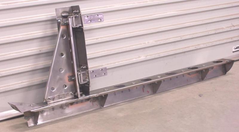

16 Mar 2014, 9:14pm
door hinges

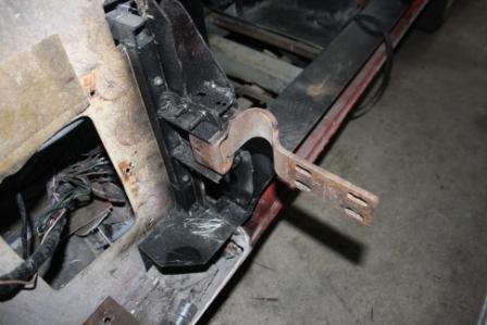

Work to date has been fabricating the doot hinges for the passenger side, which is a full 2 inches different in position to the Drivers side.
I would have liked to have had the skill to produce something like this:
However my skills and tooling are limited so I have only been able to produce this:
Passenger
Drivers
The reinforcing plates for the door catch have now been welded in place.
I am planning to use the old scimitar catches, but it will remain to see if they are anti bust catches, when i finally get on the road and hit a few potholes on a sharp bend.
I have not yet figured out how I am going to fit a beam in the door and mount fasten it to the hinges, door and lock/catch.
HM

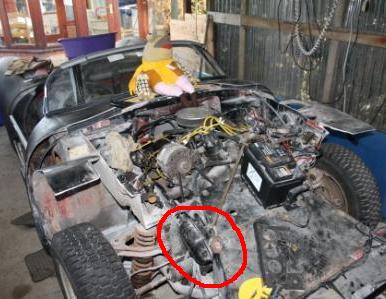

Thermostat

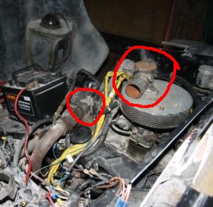

The expansion bottle from the standard scimitar needsto be higher than the thermostat housing, but the shape of the bonnet does not permit this easily.
Having seen Mr towed arangement with the modern 2 stage pressure cap.
I considered an addition of a length of piping with a cap.
However, ford provided a more elegant solution in the form of a modified thermostat housing.
The expansion bottle can now be fitted low behind the front wheel arch.
onto the nex problem, relocating the battery.

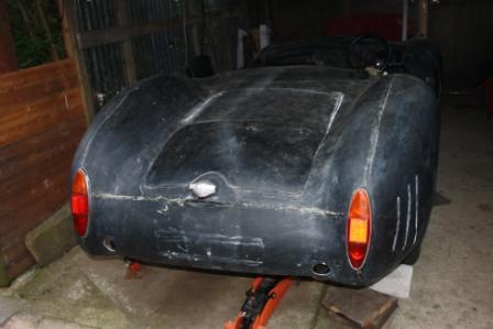

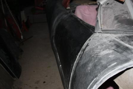

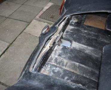

Rear lights
Following on from Micky Jaguar rear lights, i was hoping to kep a relian theme, with units similar to the early sabre
However, I ended up with these sunbeam units as they seemed to fir the body profile better.
However, I had to cut the rear of the old scimitar body even more to give clearance for the bulb holders and wiring
But it did enable me to finish the rear of the boot area and have somewhere to attach a catch.
I am going for the use lots of the old body theme in this build
HM

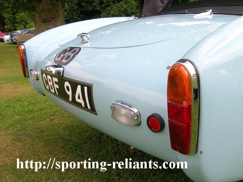

I'v been thinking of rear lights for my Pilot and have been looing at what I believe is Austin 1800 rear lights. :icon_question:

I'v been thinking of rear lights for my Pilot and have been looing at what I believe is Austin 1800 rear lights. :icon_question:[/QUOTE]
Micky,
Austin 1800 horizontal or vertical?
I think horizontal rear lights gives the rear of a car a sportier look.
They seem to give a low and wide look.
The alternative vertical lights seem to made the rear look tall and thin.
I see lots on modern estste and high roof cars.
So my preference is always for horizontal.
However the G46 does not allow it as it has curved rear haunches like the cobra.
So we end up with No1 twin lights, your Jag clusters and my sunbeam units all vertical.
Chairman has remodelled his rear end to get the horizontal look.
I wonder what Andrew Hush, and Nike have in mind
The Pilot rear seems a little flatter giving you more options.
Have you taken bluewhale out for a spin yet? :party:

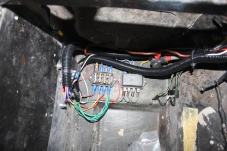

4 Jan 2015, 8:12pm
2015 Jan update
New years resolution to update the thread at least once this year.
The car has become a cat home.
My mistake by only fiting 1 door before giving up in frustration.

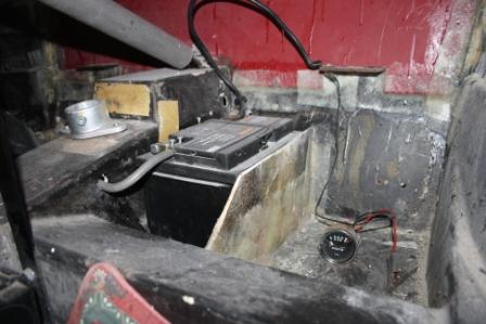

However, the battery has a nice new location behind the passenger seat and is earthed to the rear chasis.
The fuse boxes have moved to the back of passenger foot well.
All the lights, horn, heater, wipers, wahers, guages work
However, the windscreen has wipers, but no washer jets yet and the fuel sender is not wrking.

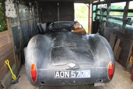

And Finally here is a picture from the summer when my nephew started her up. It really needs a video as it does sound good.
HM :smile:
