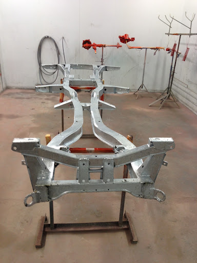

On a lighter note delivered my chassis to the galvanisers today, total weight of a clean unmolested MKIII spitfire chassis is 40KG!!!
So light they have had to charge me the minimum of £97 inc VAT so no complaints from me on that score really. Should be ready Monday morning and is booked into the paint shop Monday evening so will be done and ready for collection Wednesday.

Interesting that you are going to paint the galvanised chassis. Here in the marine trade we have always had problems bonding to freshly galvanised steel, and usually allow it to weather first. We mainly use Bradite EU96 as a barrier primer to the zinc, and thats usually just for decorative coatings as galv steel will last 30+ years in the marine environment anyway.
What do you plan to coat your chassis with 9
12 Feb 2013, 3:00pm
Cant remember the brand but its an epoxy etch primer, amongst its specific properties is the ability to etch/bond well to galv, have used it in the past and it seems to stay where its put! It will also get a further coat of epoxy topcoat and a dose of waxoyl so i fully expect it to outlast judegement day :-)

Well chassis is back from the galvanisers, a day late but a good job, it's in the booth tonight to thoroughly dry out and then will get a wire Brush over it tomorrow to remove any loos tags and then paint so should be back to me for a marathon tap and die session by Thursday.
19 Feb 2013, 8:42pm
That is as good as it gets! Stunning foundation to your build Mac.
19 Feb 2013, 10:05pm
Yep, looks great. Wish I'd thought of having mine galvanised now. :(
How much was it if you don't mind me asking?
19 Feb 2013, 10:26pm
Little more than I expected but still not too bad at £180 inc vat. But it will outlast me now!
