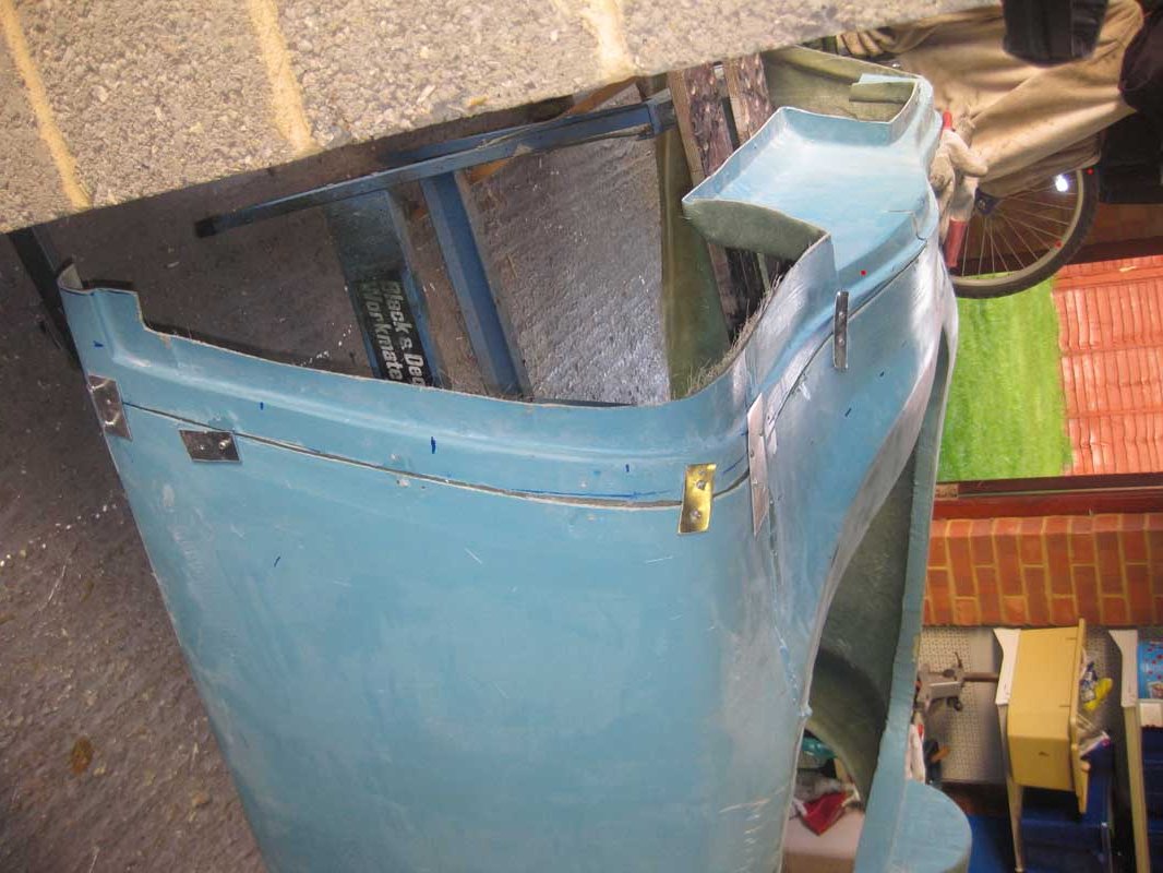

Just finished adjusting the bodyshell so that the two sides are roughly in the same position at the front of the bulhead and also to give a bit more 'fold under' at the front of the driver's side sill.

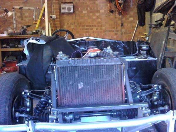

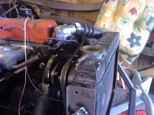

Not made much progress over the summer for one reason or another. But had a good day in the garage today.
I have decided to stick with the existing Herald radiator and spent a few hours making-up a suitable mounting arrangement which I have tack welded in place.
Whilst admiring my handywork I thought back to Mr T's thread and remembered that he had lowered his radiator to prevent it fouling the bonnet. I have concentrated in getting my radiator in the same place as it would be on the Herald. So will it foul the bonnet? Cannot recall any of the other build threads talking about the Herald radiator?

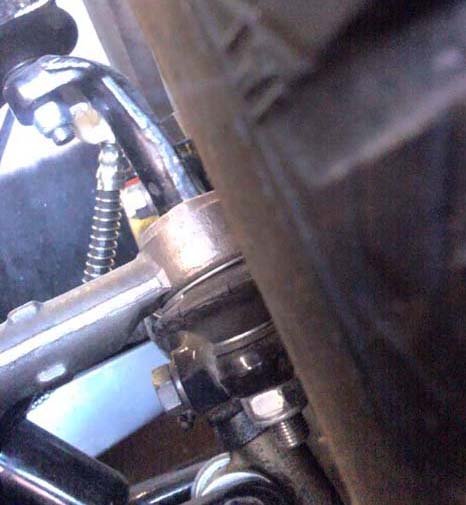

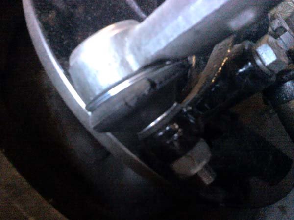

Whilst under the car, I noticed the the gaitors on both track-rod ends had split as shown in the following photos:
Can this be anything other than faulty parts?
Chris
14 Oct 2012, 4:42pm
Yes definitely poor quality rubber to perish that quick. As these rubbers will now under newish regulations fail the MOT, replacement rubbers are available and may be easier than getting them exchanged.
I used the herald radiator and yes it will foul the bonnet if left in the normal position. I think that I lowered it by about 3 inches but cant remember the exact figure, sorry. Once it is lowered, the cap will no longer be the highest point on the system so you will need some sort of expansion tank, which most people have placed where the heater used to be as it is convenient although as with all things Sammio, there is no right or wrong.

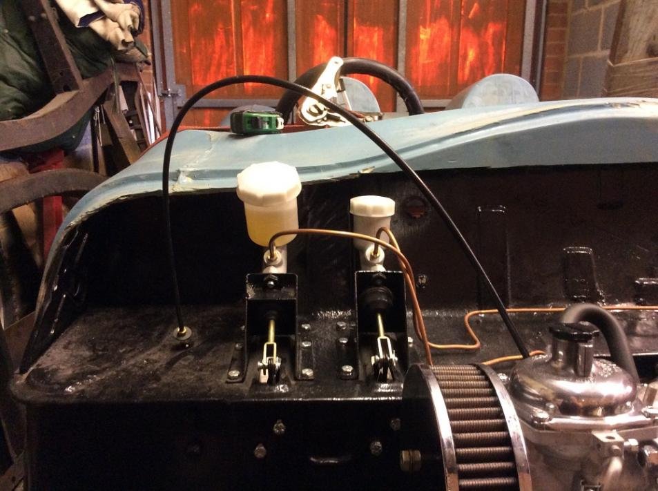

Have made little, if any, progress in 2013 my build is now back underway.
I decided to get to the chassis/frame running before fixing the body. Last couple of weeks have seen the engine running very sweetly and so I was planning to fix the body over the weekend. Then I found that the brake master cylinder is too tall - can't remember noting this on other build threads?
Anyone recommend a suitable remote master cylinder replacement?
