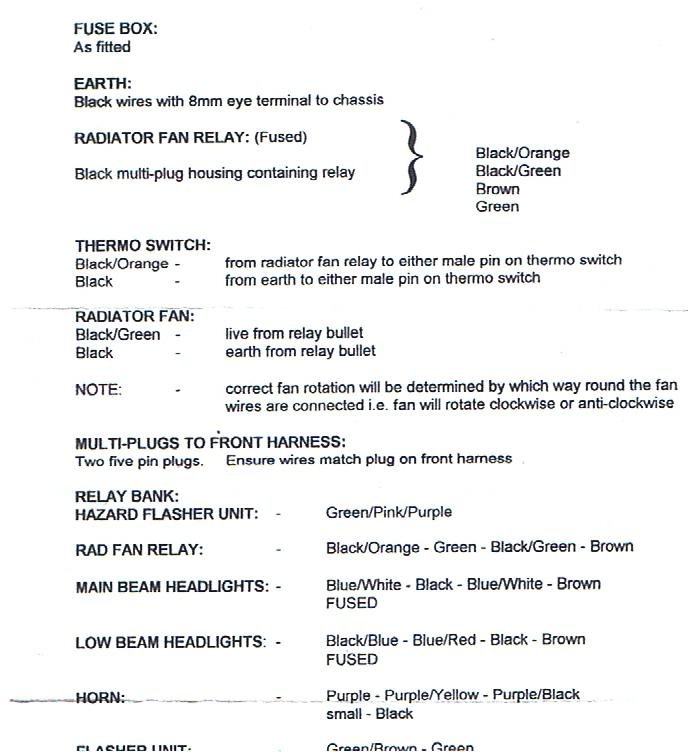

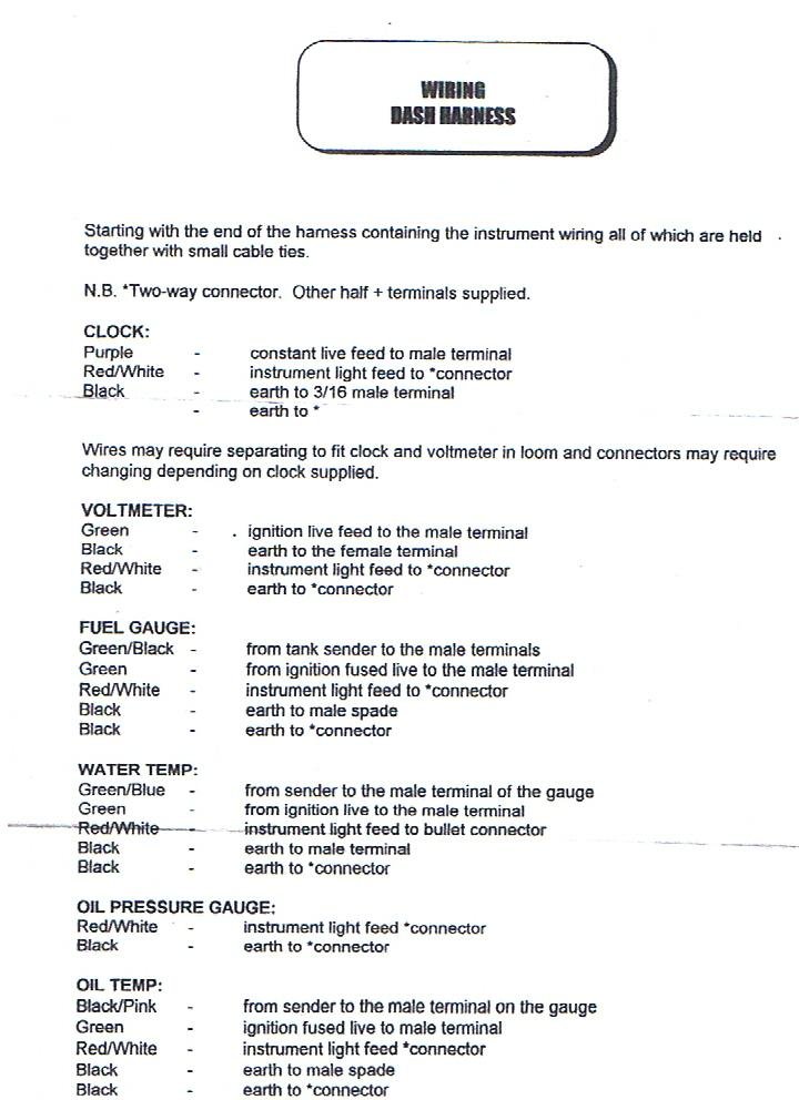

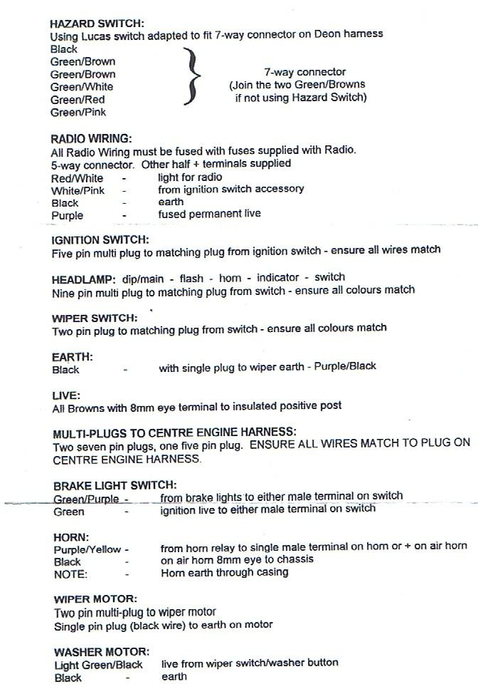

Dino Dashboard Wireing
Hi All, Hopefully attached is the wireing instructions that Ian kindly supplied.
Regards Mac.
