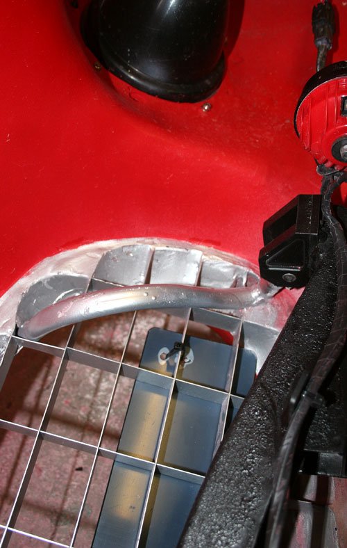

Paul Here's a few pictures of the bonnet brackets i made, they may be of no use to you as all the parts i have are bespoke.
Two taper pads were welded on to the front chassis rail to bring both bracket pivot bores in line with each other, if they were not in line then the bonnet would not pivot correctly if that makes sense, this pictures shows one bracket in place with the taper pad between the bracket and chassis rail.
Made a frame out of 20mm steel tube to sit inside the oval nose profile and bonded in place, two hinge brackets were welded to the tube frame before bonding in place. Second image is of the parts i made.

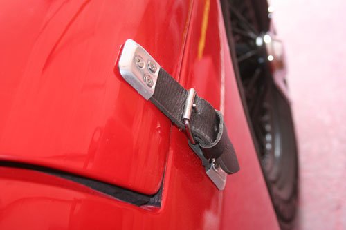

Oops, sorry, I meant the brackets/fixings for the leather straps holding the bonnet at the sides.

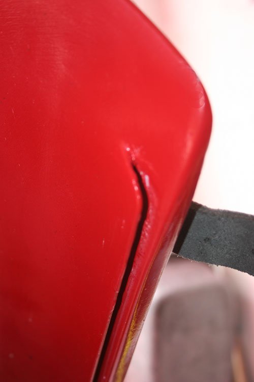

Paul Pictures as promised but to be honest they don't show a great deal.
The straps are fastened to some 3mm ally plate bonded to the inside of the bonnet, the plate acts as a alignment edge to keep the bonnet in line with the body, i tapped the 3mm ally plate for the top strap three screws to fasten to and the bottom strap is fastened to another ally plate bonded inside the lower body.
These pictures show the ally plate on the bonnet and the angle plate attached to the body which interconnect with each other when closing the bonnet.
Hope that is of help, basically it takes a little forward planning to place the ally plate in the correct position before finishing the body prep work.

Swifty - Thanks for posting that. :cool:
I think the way your bonnet "slots" into the body shell is a great idea.
So I will certainly be trying to do something similar when I finally tackle my own.

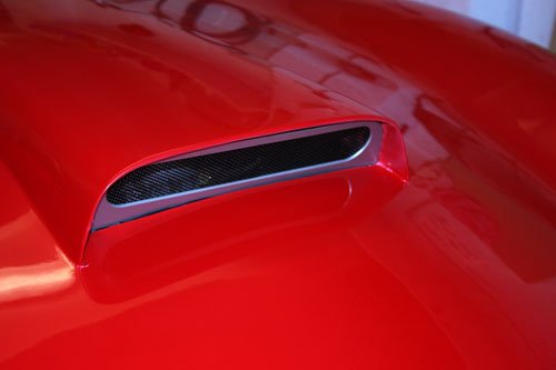

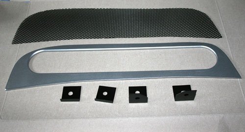

Finally made a grill to fit in the scoop opening, i had originally made the trim out of square punched sheet but it some how did not look correct so went back to the drawing board and came up with Mk2.
Made in two parts with four angled brackets. The silver outer was machined from 3mm ally sheet with mesh for the center infill. The slight miss shape in the outer frame is due to the misshape in the bonnet, one of those Ribble problems!
Scoop grill attached to the bonnet, its held in place with polyurethane sealant and the four angle brackets, all hidden inside the bonnet.

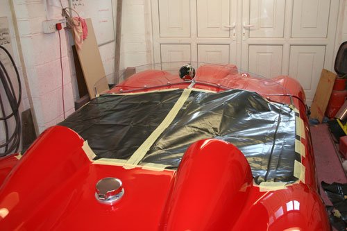

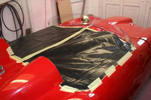

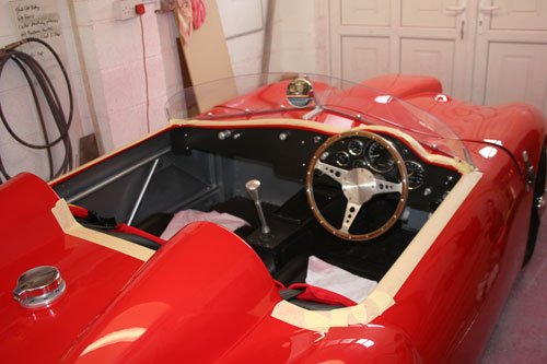

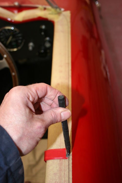

Today the tonneau cover fabric along with the fasteners arrived so after much thought on the best way to start i decided to mark out the area to use as a template.
Masked off the edges.
Made a small tool out of ally sheet to act as a guide marking out where the tonneaue cover edge will be, drilled a small hole in the guide tool for the pen nib to sit in then ran the tool around the cockpit edges to give an even overlap.
Cut the template out of thick polythene by first rough cutting to shape then taping it to the body then cutting to the correct shape following the pen lines previously marked out on the masking tape. The center tape is where the join will be.
I did try to find a piece of clear poly sheet as it would of been much easier to see the pen lines through clear sheet rather than working in the dark with black poly sheet.
Next job is to cut and stitch the cover fabric followed by fitting the fixings to the shell.

So far so good. You're probably aware already, but I believe the way you tackle the centre zip is to fit the whole cover as one piece secured in place with all its fasteners, then cut down the centre and tack the zip in place with the cover fitted to the car still.
Keep up the good work!
27 Apr 2016, 6:52am
Swifty - Good luck with this, I'm looking forward to seeing how it turns out.
Like Mr T, I'm sure you have this all under control, but just a gentle reminder of one of his earlier posts on your thread…
Mister Towed wrote:
...There's a fillet let into the driver's side which creates a bulge for the steering wheel to sit in -
It is not easy to tell with the black plastic, but your steering wheel appears to be "lifting" the cover in the middle.
Just a thought, Paul. :)
27 Apr 2016, 6:54am
Cheers Mr T good point on the center zip, i am going to make it as one first off and see how it rolls up in the center and if i can keep as one then thats the way ill go, only concern is how big the roll will be and if it fits between the dash and screen, then there's the storage in the car, will two rolls be easier to store than one large roll of cover.
27 Apr 2016, 7:02am
Cheers Paul we must of posted at the same time as i missed yours while answering MrT, my steering is removable for anti theft so car will be parked up minus steering wheel, the bump in the template is the dash eye brow which may or may not require a fillet sowing in which i will know once the fabric is roughly in position, my gut feeling is for it to look right a fillet will be required.
