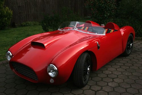

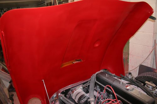

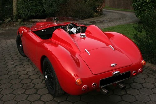

Swifty - Your paint looks very deep in those low light photos. :cool:
Given the high standard of the rest of your build, it makes sense to do the inside of the bonnet.
Although when I had a look at doing that to mine, I put it into the "come back to later" pile. :rolleyes:
Good luck with the last few jobs before the MOT.

26 Mar 2016, 8:41am
I just plastered a thick coat of a rubber type underseal paint on the underside of my bonnet and inside the rear wheel arches. Serves a dual purpose of giving the finish an 'I meant it' look and preventing stone chips as I never fitted arch liners. So far I haven't had a stone chip come through from underneath in almost 3 years and 8,000 miles driven so it seems to have done the trick.
That's the best picture I have I'm afraid. It was black when I put it on but it got a coating of fibreglass dust when I cut through the bonnet to add a clearance blister while it was still tacky. I've still got the tin somewhere, I'll dig it out and let you know what it was.
Paint looks superb btw, great job. Does it look as dark a red in daylight?
26 Mar 2016, 9:57am
Paul L The bonnet was also on my to do list later but as i haven't got the stick on number plate sorted just yet which means i am unable to book an MOT i thought i would make good use of the good weather plus once its on the road it will be hard to get round to doing jobs like rubbing the under side of the bonnet which i can definitely say was mind numbing and i did have a few moments of "why did i start this".
Mr T Spraying with a thick rubber coating was probably the way to go, less hassle plus good protection. I do intend on fitting front ally wheel arches to protect against stone crazing on the front arches but this is on my to do list.
The paint colour is lighter in normal light, the close up rear end shot was taken when the sun was going down plus the garden is surrounded by large trees hence a diffused moody light, before i started this car photography was my main hobby so i like to play around with the camera.

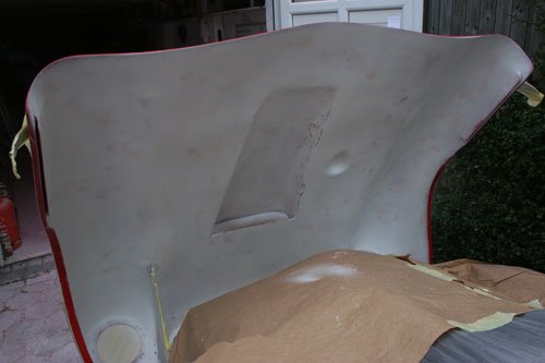

Today the bonnet under side was sprayed so one more job ticked off.
Under coat on which reveled a few small hollows so skimmed over with filler then a quick sand ready for the top coat.
Top coat on just need to cut the mask lines back in around the bonnet edge. Its not perfect but a far sight better than it was.

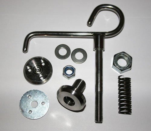

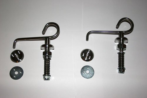

Been busy making a couple of bonnet catches.
Made from stainless, tig welded, cleaned with pickling paste then polished. The shaped bar was formed by heating to cherry red then placing in a jig i machined to be sure both were bent to the identical shape, the other parts were turned and threaded on a lathe.
This picture has the catches fitted to the bonnet in the top right hand corner.

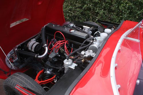

Cleaned up engine bay ready for this weekend outing.

Good luck with the MOT, the engine bay looks great. :cool:

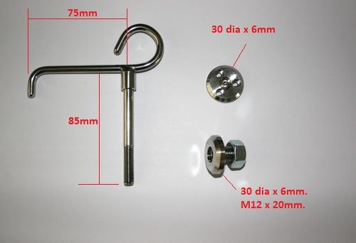

Been asked for dimensions of the bonnet catches so here they are, if any body is interested PM me for further info.

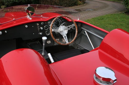

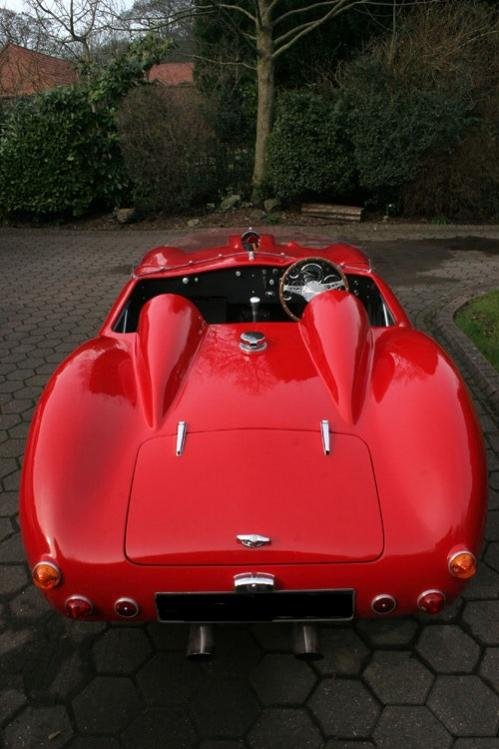

10 Apr 2016, 2:53pm

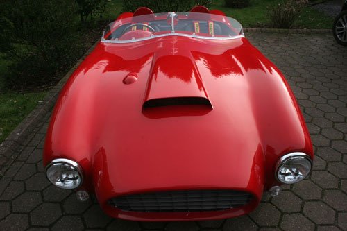

Final major hurdle completed yesterday, the car passed its MOT. Went for a quick spin and it certainly does turn heads plus we got a few smiles on the way.
Called into a local petrol station to fill up and two separate guys stopped to talk about the car so it looks like this will be the norm. Think i will need to add a little time on a journey just for the crack.
These are some photos of the car yesterday before it goes off for decal work, its been just over two years since i first posted on the forum, i did think that when i started the build would take me a year but due to the major body work required to get the car to a reasonable standard its taken two enjoyable years, now looking for my next project.
Next update will the decals, got a local company fitting them for me just have to wait a couple of weeks to arrange.
Finally opted for Adrian Flux for the insurance, £140 for the year which considering Ive no NCB to transfer over is not to bad.
Well that's it for now see you all soon.

Car looks fantasic , one of the best finished cars.
