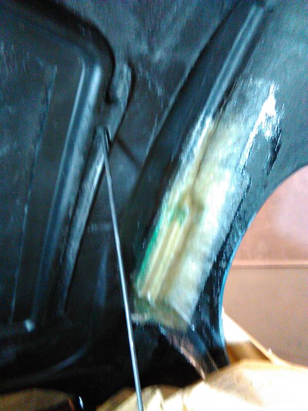

Whilst the front is being repainted Josh, the painter, is gaining to sort the slight sink marks where the bonnet pins once were and a few pin hole marks on one wing. I pop over tomorrow to photograph the under-wing strengthening.

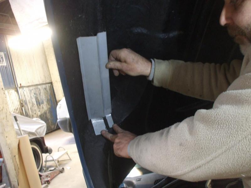

Anyway, I've been over to the workshop today and am impressed with the panels they are making to strengthen the area.
They will be screwed to the hinge box then the area behind filled with fibreglass paste. the panels will then be refitted with rivets and the whole area fibreglassed over the top so nobody would know that wasn't how the car was designed.
By the time that's all done and rubber pads mounted to stop the front vibrating, if it's still a problem, I'll blame my off road driving style.

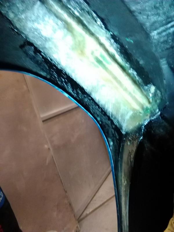

16 Jan 2017, 1:02pm
The strengthening panels are now fully fibreglassed in. The cracks on the outside of the wings are redone.
Primer this afternoon then paint this evening.
Polish on Tuesday and I should be able to refit on Wednesday.

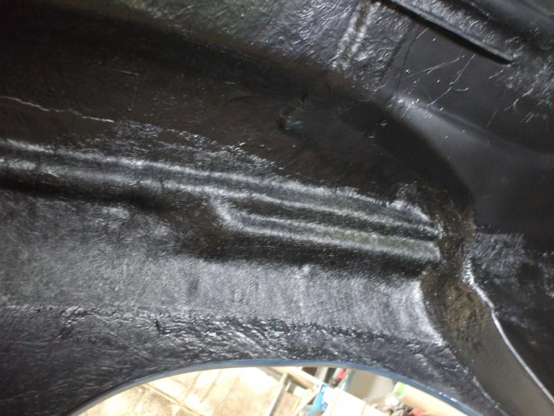

18 Jan 2017, 2:52pm

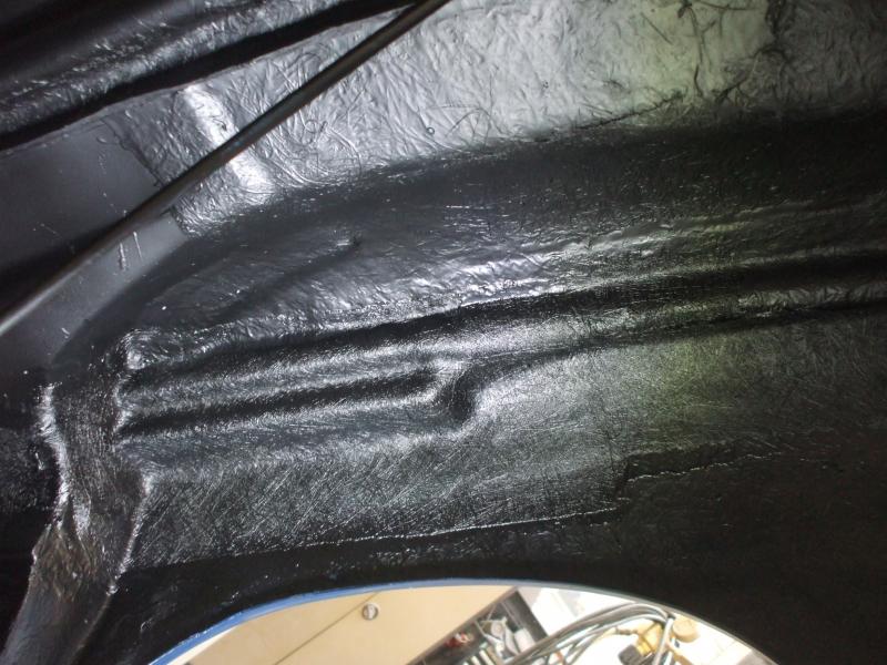

Just picked the car up.
The paintwork is lovely and the colour match is spot on.
This is the underside now it's finished, hopefully the cracking issues are now all in the past.

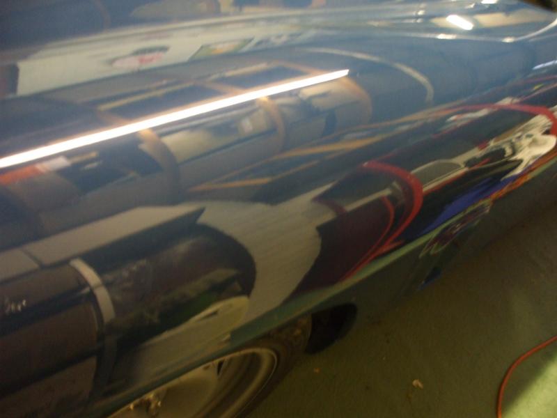

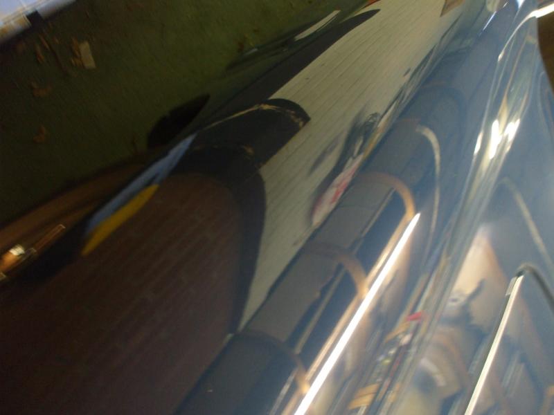

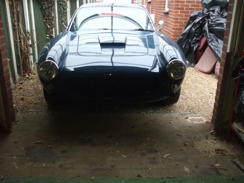

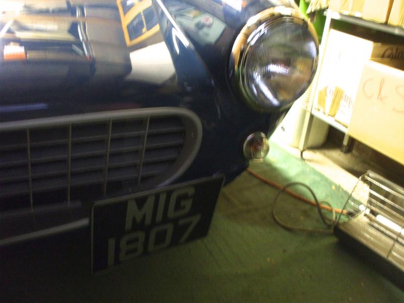

20 Jan 2017, 4:38pm
This is all the photos I could take as the car is hemmed in again by a load of auto jumble that came today and is stacked under the carport.
It shows the areas where the cracks were all looking invisible now.
The grille and number plates went back on this afternoon so I though I'd put the new plates on. The yellow/white ones are still on the car as backing plates to the new ones so I can change them easily if requested.
I thought I'd found the ideal solution to the unattractive black plastic trim under the windscreen, A Jaguar XJS polished panel was in the auto jumble purchase. I may try harder another day but it doesn't look like it will quite first. Shame.

20 Jan 2017, 10:56pm
Amazing!
I like the idea of the plates too.
Sorry officer, I forgot to remove the show plates... :)
21 Jan 2017, 10:24pm
How do the "show plates" attach to the reflective ones? Tenax fasteners are possibly a good way?
21 Jan 2017, 10:27pm
Simpler than that. They are just bolted to the brackets/body through holes in the same places on both plates.

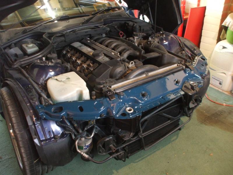

Just fiddling about under the bonnet today.
I'm going going to do much to change it or bling it up, just some paint and a good clean really.
I used left over paint from the wing repairs to brush paint the front slam panel. Not perfect but much better than it was. Some more will be blue and the rest will be flat black.
I also took the engine covers off to repaint the stripes and have removed the BMW . I've made a plate to fill the space and ordered a new badge to go on it.
