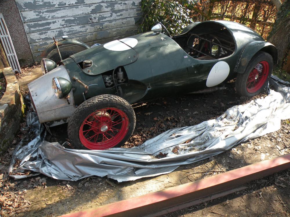

Thanks for kind words chaps, they're much appreciated :). It's certainly been a bit of a marathon over the almost four and a half years since this was taken.
There are still jobs to do: re-covering the seat squabs and making a tonneau cover. If I had the time again I would line the visible cockpit areas with ally before riddling it with rivets and chopping holes everywhere - I'll probably make do with rattle can stonechip to hide the green.
