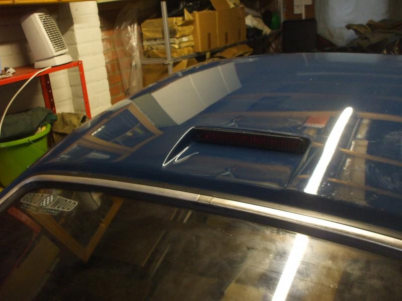

Nearly finished the high level rear light now. The red plastic surround is now black and has the mesh fitted over the top. I'll try to sort something to go around the edge to make it look more like an air vent. I'm at Newark auto jumble on Sunday so will have a poke about for anything suitable.
15 Nov 2016, 10:32am
Look even better. That trim sets it off

Hi,
It's a boat trim from Walker Rubber in Norwich. I bought all 15 metres that they had in stock.
I can send you enough (plus a bit extra) for £12 with post. Just pm me if you're interested.
I taped it in place first and by the next day it held it's new shape which made glueing it much easier. It also needs a tiny bit trimming off the wiper/vent cover plastic panel which is easily done in situ with a sharp knife.

I stuck it in with Stixall from Tool Station but I expect any of the body adhesive sorts of stuff would work.

I would be tempted to stick a flat rubber trim to the windscreen first and then the chrome trim on top in the centre. This would make it look like a traditional rubber windscreen mount and you could also make the top section a little thicker.
One of the few design flaws (due to necessity) is that the windscreen is too tall, this would give the impression that it was shorter.
16 Nov 2016, 1:09pm
That was my first plan. Speaking to the guy at the rubber supplier he showed me some flat rubber but warned that it goes brown after a few months, I've seen this before.
The other trouble is getting a chrome trim to bend round the corners without a groove to help hold it in place.
It will look great if you can get it to work though.

You won't need to, it curves round so easily and keeps it's shape if you tape it for a while
