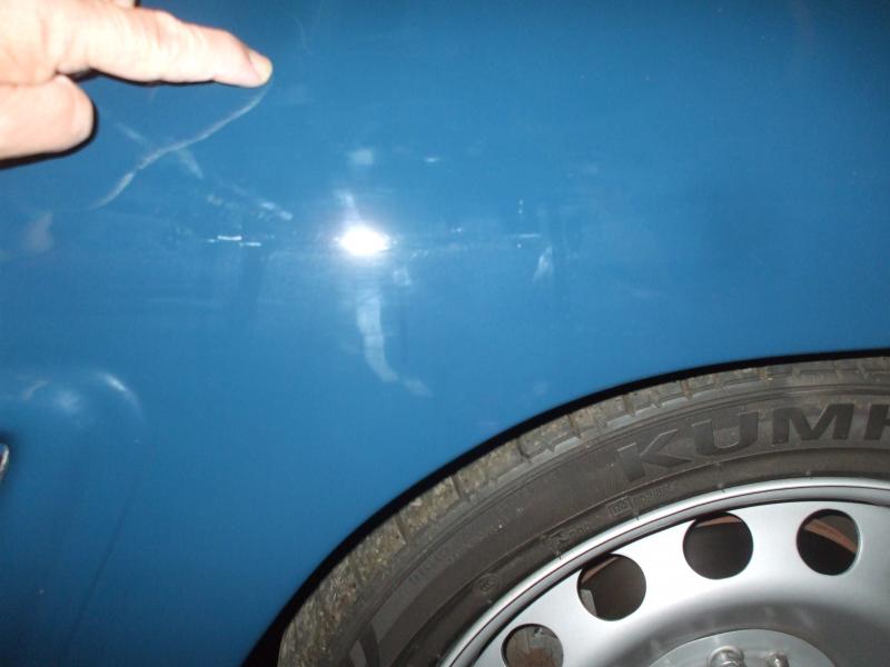

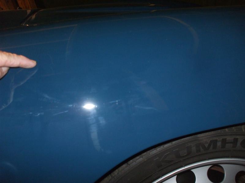

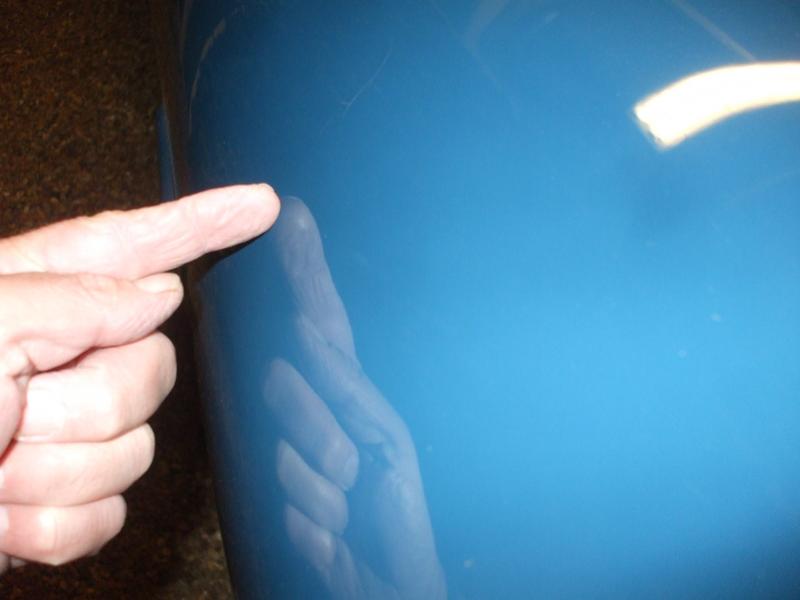

I took the car over to the painters' yesterday to talk about the stress cracks on the front wings.
It now seems unlikely than the pie cutting has caused it, rather it looks like it's where the box section part underneath the wings stops and changes to single skin as it heads along to the headlights.
This is causing a weak point where the box part stops and very slight vibration of the front end ahead of it has caused the problem.
I'll leave it now until early next year and it can go in for strengthening and painting as well as rubber buffers on the slam panel.

Any chance of some pictures, if it doesn't show up very well perhaps a couple of shots with your finger pointing to the troublesome area.

12 Oct 2016, 6:29pm
Here's some photos of the worst side. Hopefully you can just about see the crack and can work out the position from the wheel arch and vent.
Not sure if it wants more layers of glass or if it's possible to fit a lightweight box section down the inside of the wing top as there's no point just moving the problem along a bit.
As mine's been lowered it does crash a bit over speed humps if I'm not concentrating and I've taken to shows across bumpy fields to camping areas. Possibly a car that's been treated more carefully wouldn't have the problem.
12 Oct 2016, 7:40pm
I wonder if creating ribs out of 15mm plastic pipe and a couple of layers of glass would do the trick. They can add a lot of strength.

12 Oct 2016, 7:50pm
Thanks for the photos.
That's the sort of thing I had in mind.
Also making sure it's well supported on rubber at the front will probably be good.
Let us know how it proceeds as I'll probably be following your plan.

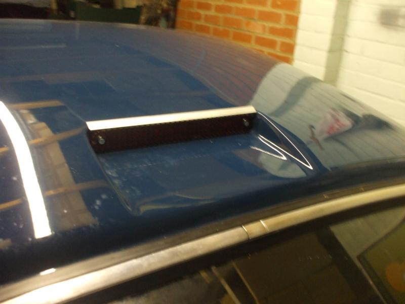

hurnleft wrote:
Hi folks,
Not much to report at the minute but I have finally sorted the high level light.
I've just filed the slot so far but will screw it on now. The wiring can wait until I get several electrical bits done.
It came from Car Builder Solutions LEDST237 and is a stop and tail light. When we went to Snetterton in the rain a mate said my rear lights weren't easy to see so this should help, along with led bulbs in the rest.
Now I'm making a combined reverse/rear fog light using an old spot light, some led lights, some glittery paper, a piece of bathroom glass, a bit of a plastic sign, (a fairy liquid bottle and a pair of Val's old knickers --a Blue Peter joke that shows my age!). Hopefully it will work out as I've never been keen on the ones I've got fitted at the minute.

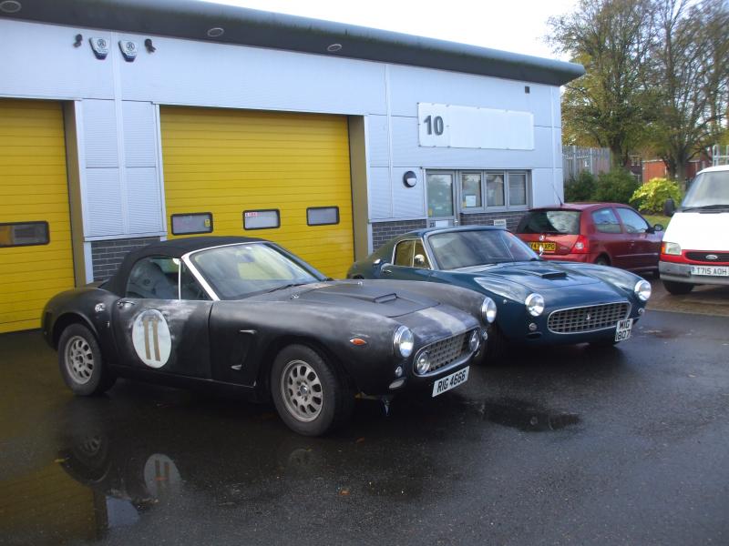

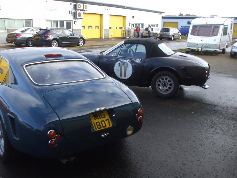

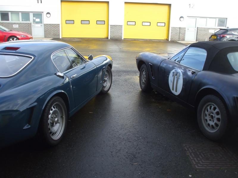

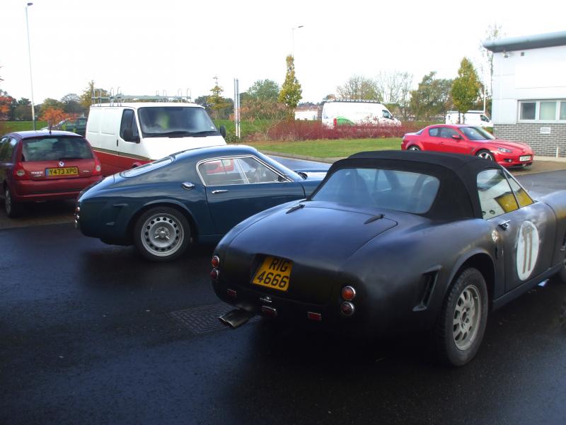

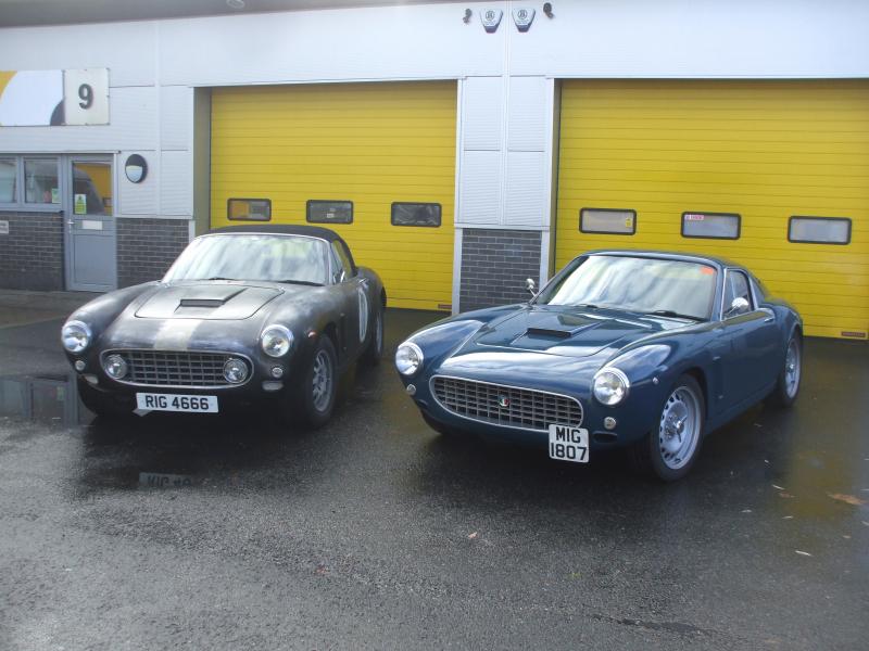

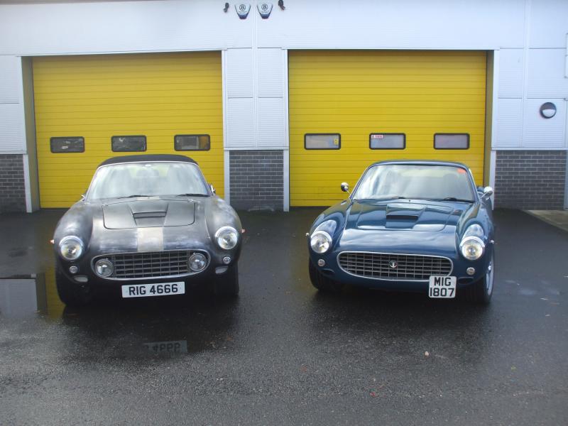

This morning I've been to see my friend Graham so we could take some comparison photos of my coupe and his recently bought convertible.
Since he bought it from Chris a few weeks ago he's had some brake and suspension work done for MOT and has altered quite a few small bits on the way to making it his idea of how a slightly hot rodded version would look.
Making a kit to fit your vision is a lot of the fun of this hobby and it was interesting to see just how many details are different between the 2 cars.

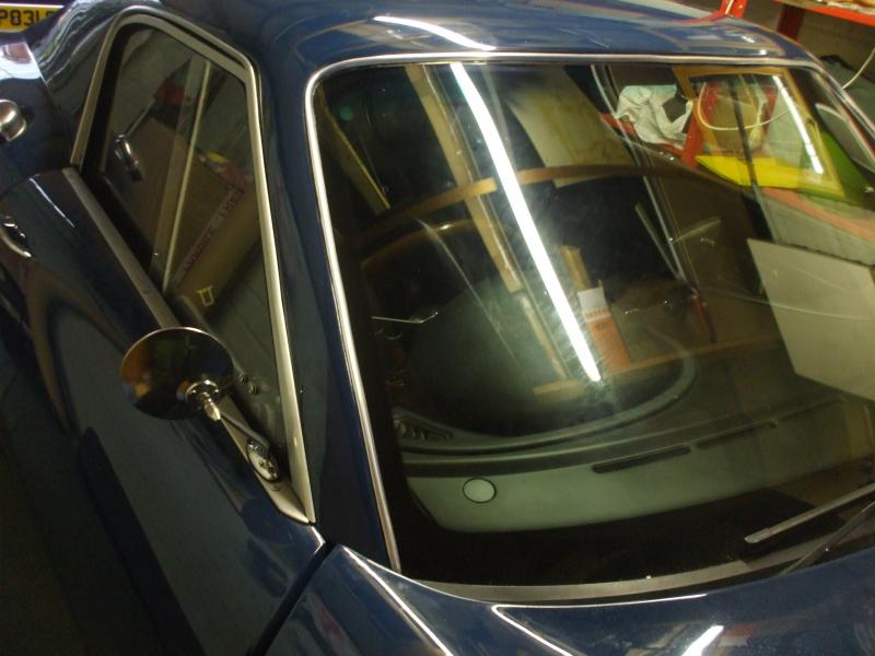

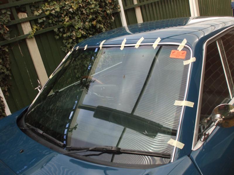

I've also bought some trim to go round the edge of the windscreen and will report back when I've fitted it. I bought quite a bit so should have enough to supply a couple more cars if it all works ok.
11 Nov 2016, 2:00pm
I cut the screen trim to length and taped in. Will leave it to settle and probably tiger seal it on tomorrow.
11 Nov 2016, 3:45pm
I prefer the coupe version and yours looks great. The windscreen trim will be a nice addition, hope your idea with fitting works out.
12 Nov 2016, 2:34am
That windscreen trim really helps the overall "look". Good work!
I do prefer the coupe, wish I could get one here. (USA)
12 Nov 2016, 3:35pm

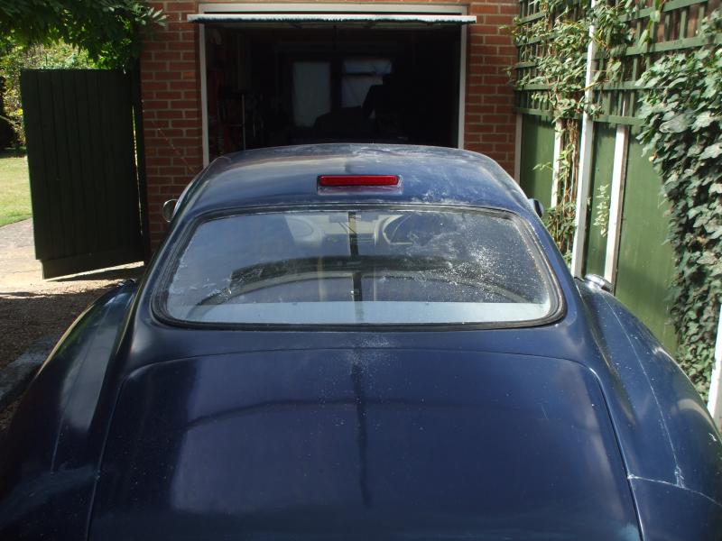

Trim is stuck in now and does the job nicely.
I've started to disguise the high level brake light
Will do a bit more tomorrow
