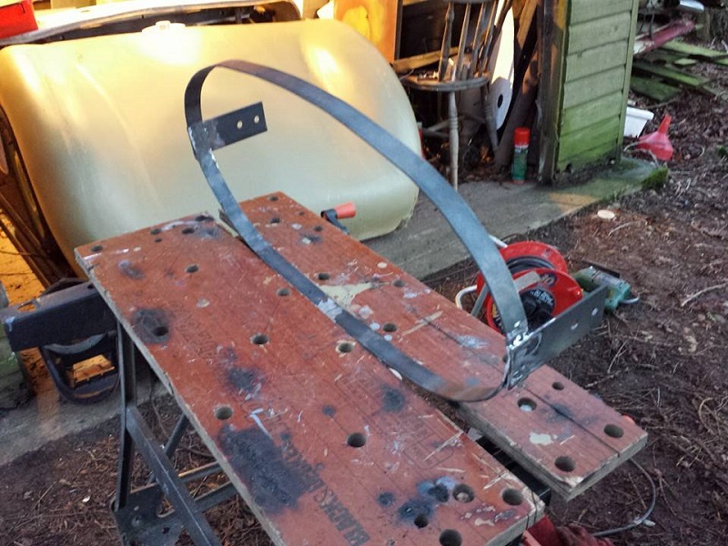

Despite being quiet of late I have been braving the cold down at The Glade. I have mounted the radiator (I want to start her up in the spring to boost morale). I have been down there today pretending to be a blacksmith - making the bonnet/hoop hinge bracket. The mounting will be adjustable in three planes and I want to be sure it doesn't foul on anything.
All I need to do now is fight the symptoms of hypothermia.
1 Feb 2015, 8:28am
Oxford - Nice job on the bonnet hoop. :cool:
Do you have any form of heating in The Glade?
At least I can step back inside my house when I've lost the feeling in my limbs. :icon_wink:
More photos please.
1 Feb 2015, 8:32am
Get yourself some old-fashioned welding goggles to wear instead of a full-face mask. Then do shed loads of welding and you'll give yourself a panda style ski-tan. You won't feel any warmer but at least you'll look it. :)

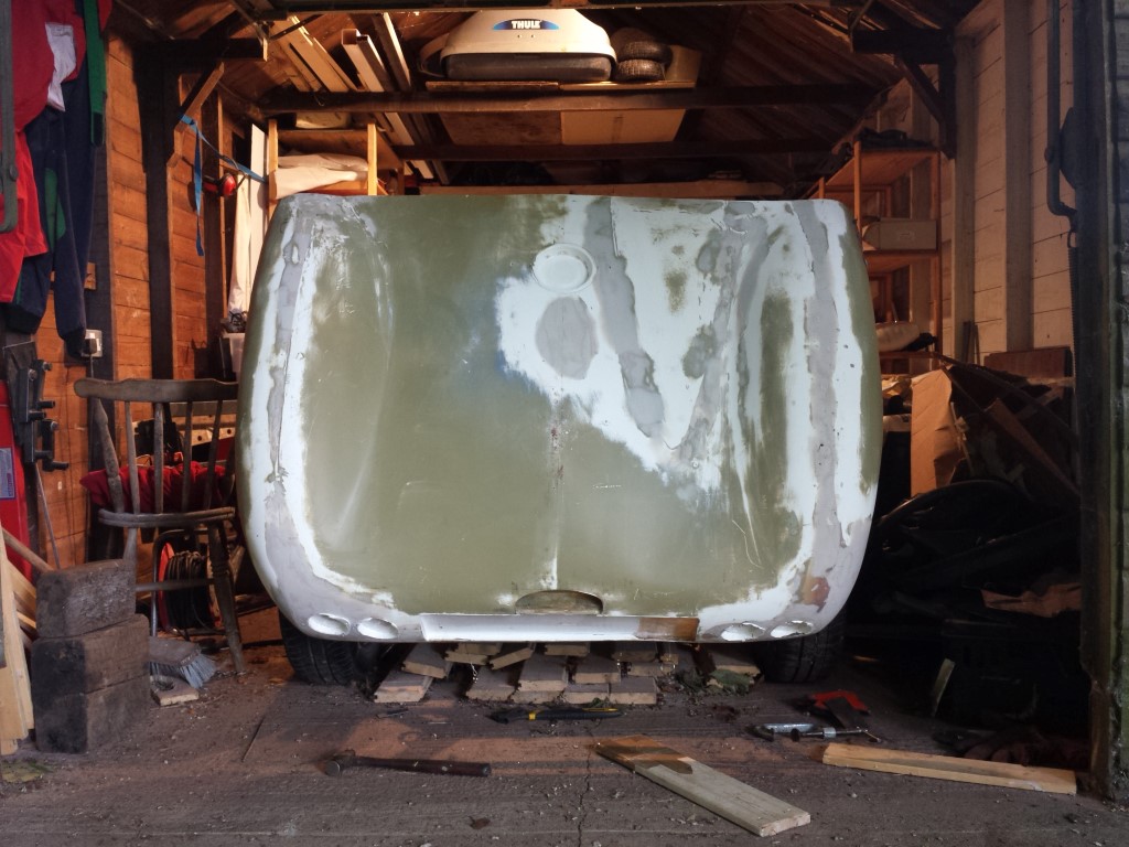

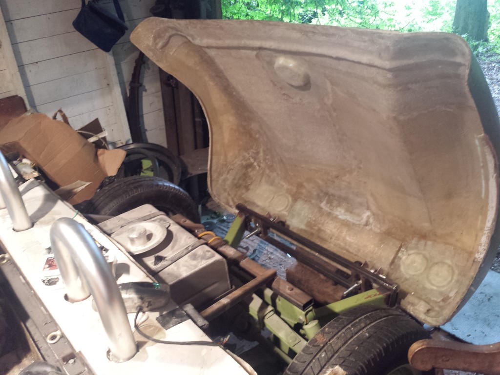

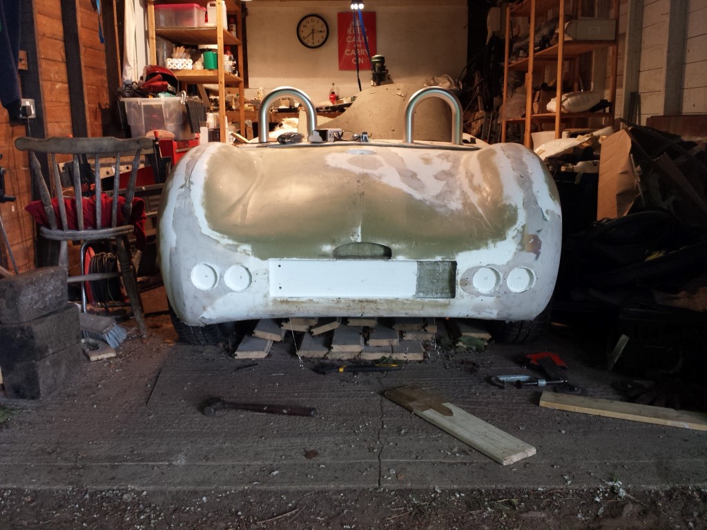

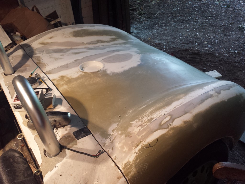

An update
Well, despite being quiet I have been making progress. Some has been under the bonnet, but most has been with the hinging mechanisms for the bonnet and rear deck, and lots of work on the body. I needed the hinges to be in place before fitting the radiator and routing the exhaust....and other tasks.
So, just a few from this afternoon when the rear hinged up and down (just as I had hoped) for the first time.
You will notice that I have been cutting and shutting (down the right hand rear arch etc) to try and get the rear more symmetrical. I also had to extend the number plate recess as I cut the first f***** in the wrong place. Don't ask "how" because I don't know. I suspect a faulty tape measure.
All the different paint /filler colours do appear to distort it a little, and I have still to address the shape of the bottom edge of the rear deck......but the evenings are light.
For those not familiar with this build, the hoops are removable, and when in place will be covered by humps.
More pics in the coming days.

evening O, lots of nice work going on, will you be adding to right hand side of lower rear deck... And how's the dog, must be big by now.
14 Jun 2015, 6:33pm
Yes, I shall be building up the right side to make it symmetrical. Also, the rear deck is not adjusted accurately so looks worse than it is.

Oxford - Wow!
You have certainly been busy, as there has clearly been a lot of fibreglass fabrication work going on. :eek:
I know what you mean about the "work in progress" being hard to see clearly.
But by the time you have got a coat of primer over the top I am sure it will look amazing. :cool:
How are you planning to fit the humps over the roll bars (e.g. will they be hinging forward)?
16 Jun 2015, 6:48am
Yes, Paul, the humps will hinge forward so that the rear deck can lift. They will also be easily removable. The plan is to have a bit of a "transformer" with a few appearance options - one or two roll hoops, and one or two humps.
The bonnet and rear deck are each quickly removable - they are both held on with two meaty ex-MOD pins. The idea is for the finished (ha ha) car to be as easy to work on as possible.
