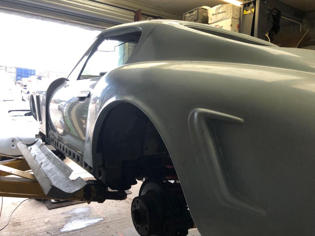

Door mirrors removed, inner screen trims stripped and front and rear shells trial fitted again....

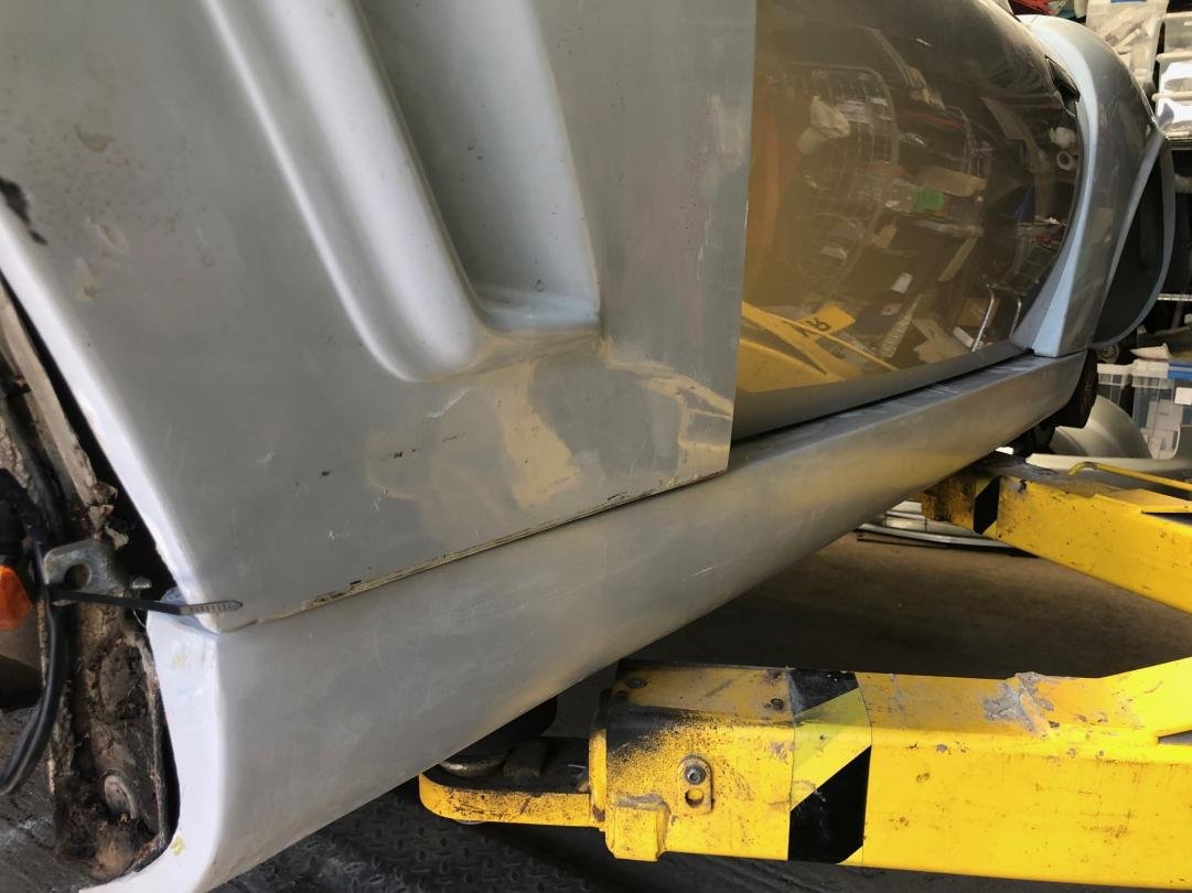

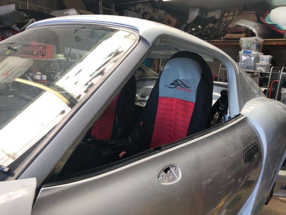

Ian had the quarter lights and door internals stripped out over the past couple of days - good work that chap!
(Nice seat covers:sick:....only there to protect the leather seats beneath thankfully!)
26 Jun 2019, 4:29pm
And he also got the first outer cill (sill?) positioned and fitted....

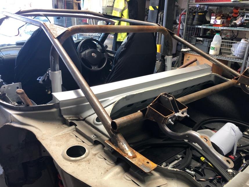

This afternoon and working together we offered the metal strengthening cage into position in order to mark out and drill the rear fixing stud holes through the inner rear wings to the boot. Easier said than done as the main tubes slide down inside the Z3 roll-hoop tubes but are an extremely tight fit!
Half an hour and several hundred thwacks with a soft-faced hammer later....
After which of course we had the fun of removing it again :mmph:
The rear left hinge in the picture is going to need to move if we're going to be successful in fitting the filler where I intend in the rear deck. Ian tends to get these cages fully prepped and powder coated before fitting too so it'll look a lot different further down the line!

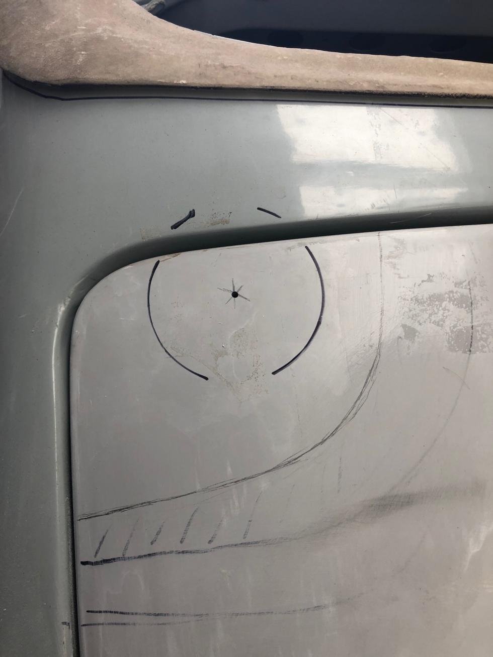

Ian and I have been busy with other things so things have been a bit quiet in the past couple of weeks, until today...

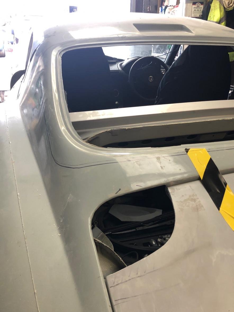

After much deliberation we've come up with a plan for the fuel filler and filler pipe route. The first step of which was to approximate where it should go and both look good on the lines of the car as well as ape, more or less, the originals...
Note the various pencil lines for versions 1 through 18 or so!:nono:
13 Jul 2019, 6:26pm
I've decided not to recess the filler at all so I don't need to worry unduly about spillages getting into any recess. So the next step was to get stuck in and cut the boot lid....
13 Jul 2019, 6:32pm
We then cut off the inner skin around the hinge and moved this inward before re-bonding it to the lid, still allowing a 40mm lip around the perimeter and making sure to keep the hinge bolts aligned...
Looks a little messy at the moment but will be very solid when blended back into the original lines:blabla:

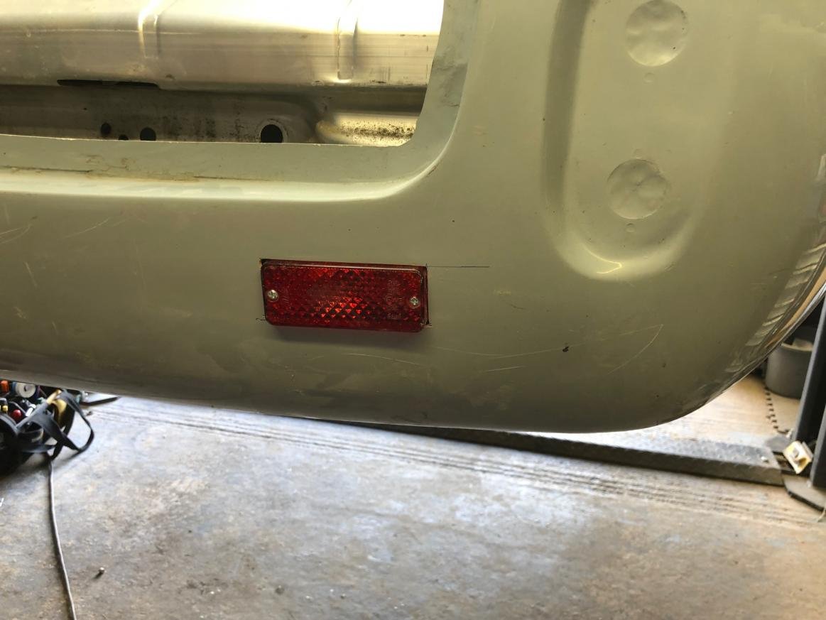

While we were in a cutting mood we also cut the boot lid ready for a couple of recessed number plate lights (sorry, forgot to photograph that!) and also marked and cut the rear for a pair of flush fitting fog/reverse lights where the reflectors usually are...
Now I know the originals had no reverse light and usually a drop down suspended fog but I always feel these just look wrong on the lines of the car and I wanted to tidy things a little...plus it's mine so I'll do it my way...so there! :icon_lol:
