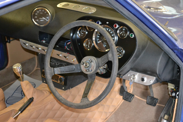

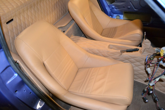

3 May 2020, 7:50pm
The car was away at the trimmers over the Xmas period, I am very happy with what he has done, it is all been done in hide and for a decent price as well.
I had to prep and paint the floor pans before it went as the paint was flaking, I also did a dry build of the seats and dash etc and fitted the sound deadening material.
I have also removed the fuel tank, flushed and painted it and fitted the rear exhaust box, fitted the rear screen and all the lights etc, brakes are next on the list and then it won't be far off for an MOT.
