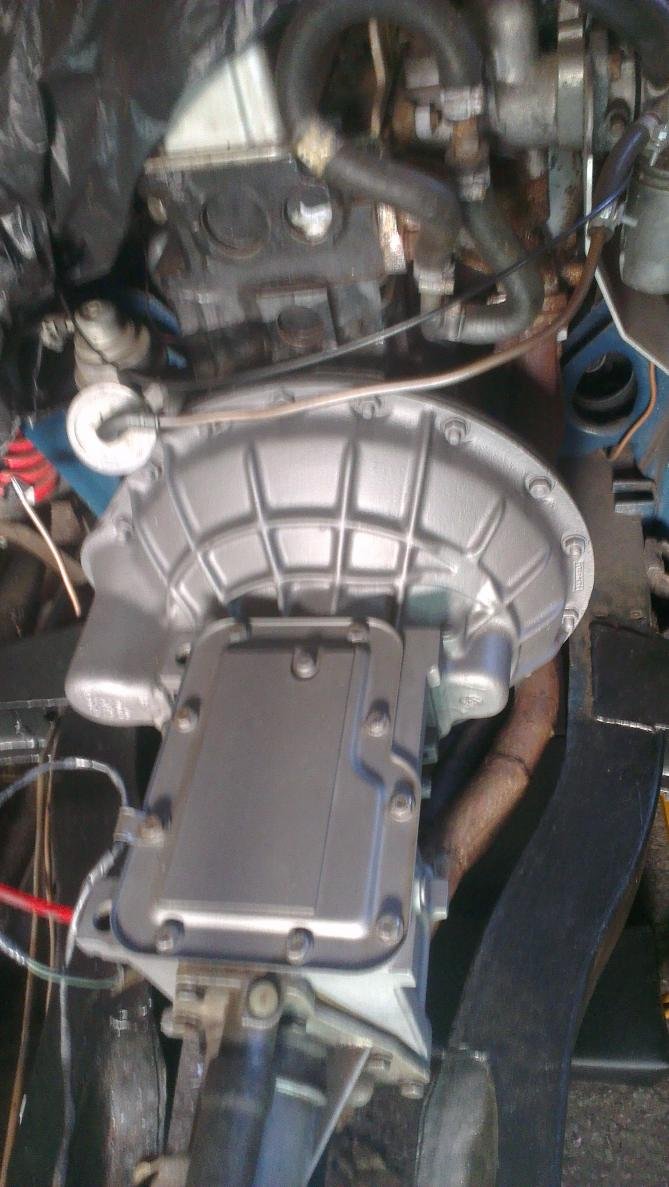

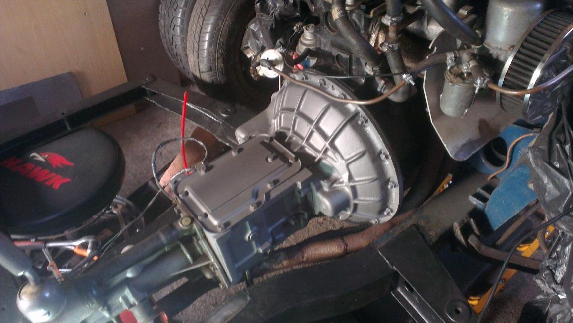

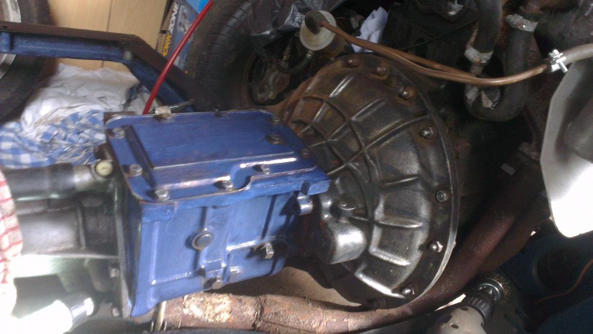

I had (finally) a couple of days to work on the car. I could not spend much time working on the car lately, but hopefully, I will have some more time in coming weeks. Didn't do much but I'm a bit further nevertheless. Here are some photos.
Gear box housing cleaned and painted.

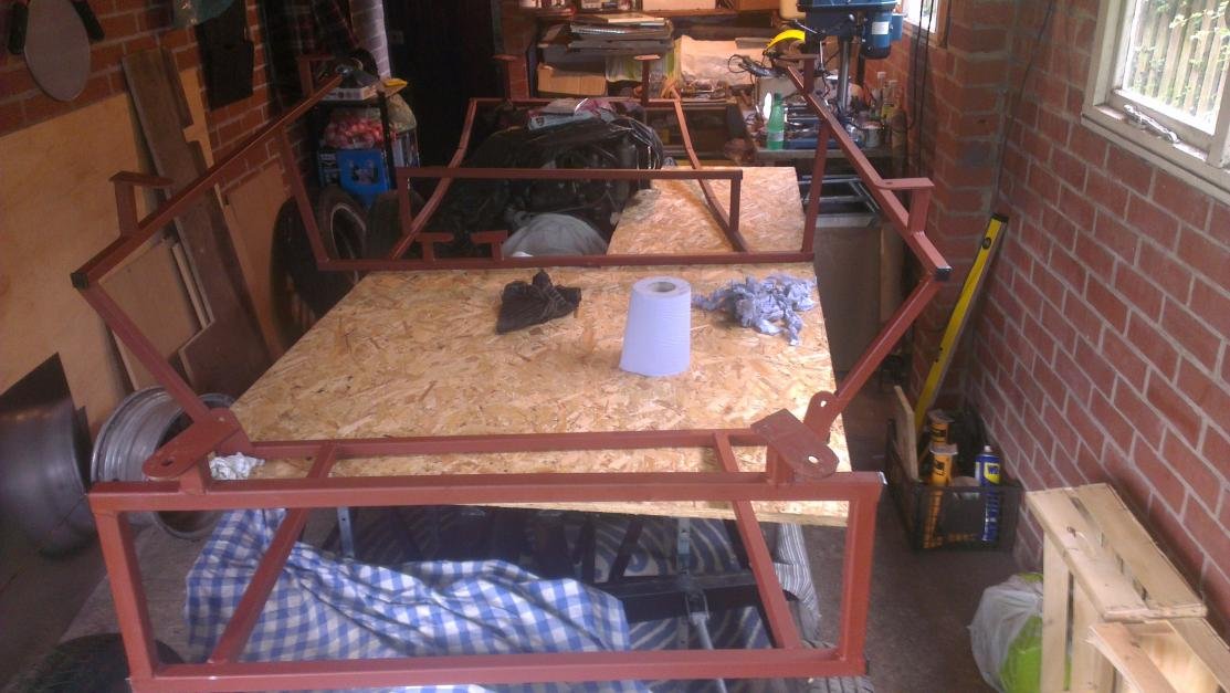

5 Jul 2017, 10:20am

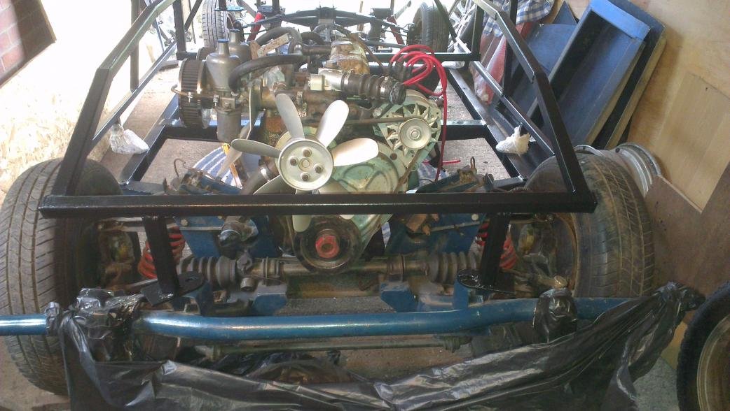

Frame in primer and painted.

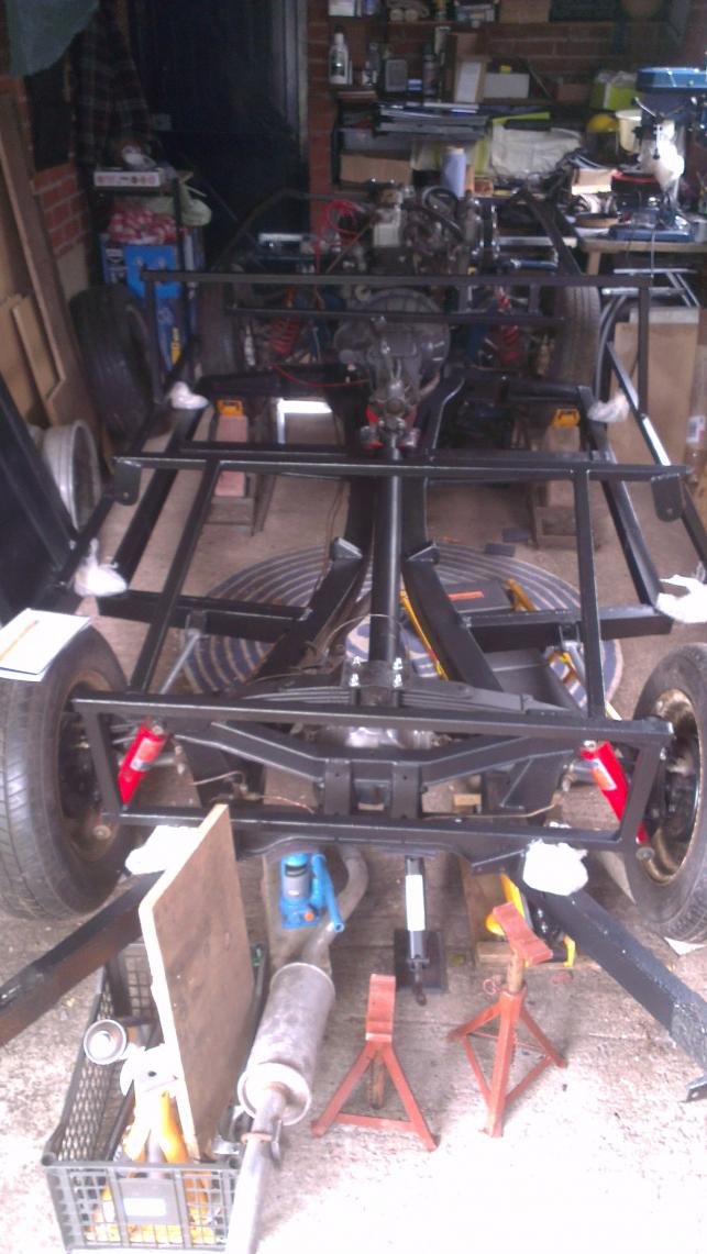

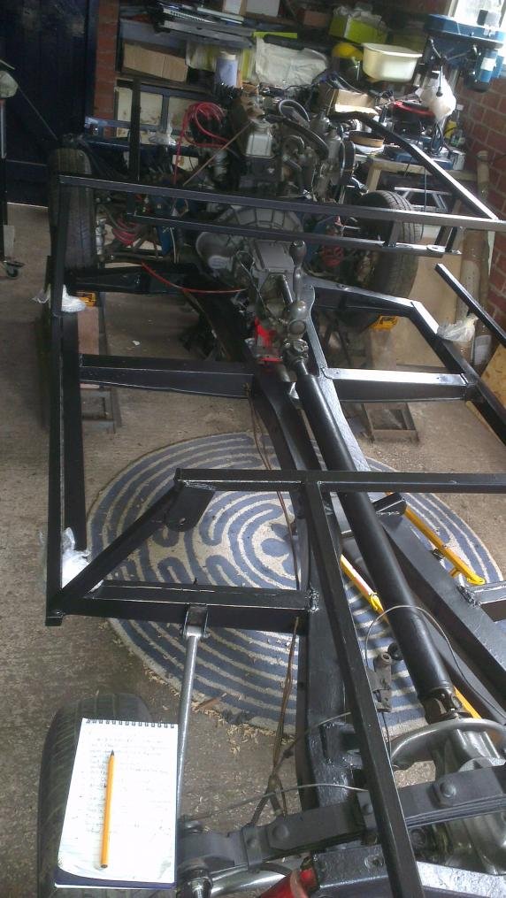

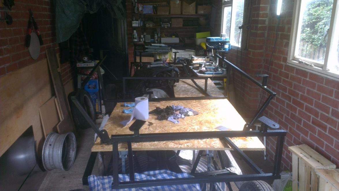

5 Jul 2017, 11:06am
Trial fit of the frame.
Overall, the existing attachment points on the frame are perfectly aligned but I have noticed that the frame is not quite complete, which is a bit disappointing.
Two attachment points that should mount on the rear part of the chassis (just behind the spring) and the pedals mounting plate at the front of the frame are missing.
Also, the bar on the back bottom (lateral) that should link left and right back sides of the frame is missing - this is maybe left out in the case the frame doesn't align properly, so it is easier to make the adjustments...anyway, I need to fabricate the prop shaft tunnel and the gear box cover, so I guess it is time to learn how to weld. Actually I am looking forward to learn how to weld. A while ago I've bought an arc welder, so we shall see...
I have a few questions please:
There are two small attachment points there on the front of the frame, where the dashboard will be - I guess they are for the steering column?
Two attachments on the top back corners of the frame (just behind the seats) - are they for the seat belts or something else?
The petrol tank area is on the back of the car - I know that many of you have placed your petrol tank at this position but is it safe to put it there and would it be safer to mount it behind the seats?
The fiberglass floor panels - is it necessary to put anything in between the chassis and the floor panels, like some kind of rubber (possibly neoprene), or another kind of a sealant like silicone or a Tiger seal, or is it enough just to bolt them to the chassis?
When I bought the chassis, there was a piece of a double sided sticky tape of some kind (green stripe on the photo below). The green bit could be peeled of exposing a sticky, soft, rubbery kind of tape. Is this something that can be used in between the chassis and the floor panels maybe?

5 Jul 2017, 6:03pm
Yup and they should be the right distance apart for the U bolt that mounts the Triumph column to the old tub. "should" being used based on experience here! I had to cut and re-weld mine, others used Garage Adjustment Device No.1 i.e. a big hammer!
deni wrote:
Two attachments on the top back corners of the frame (just behind the seats) - are they for the seat belts ?
yup.
There has been some discussion about this over the years with the various Sammio / Ribble / Migilia designs and i think the thinking the last time i remember was that it's as safe as any motorbike!
A nice thick bead of Tiger Seal all along the contact points does the trick, adds some sealant between the gaps (not that you'll drive it much in the rain) and also adds some strength.
someone has gone a bit Blue Peter and used some double sided sticky tape with one of the sides still covered to add some padding. That'll work and stop rubbing, but if it's not the proper external stuff like they use to put number plates on with, i'd worry how long it would last and, for us, if it would trap moisture!
I hope that's some help?

If you are going to be doing some welding on your frame , may I suggest adding a bit of bracing for strength and rigidity in places ? ...The S*mmio frames had a slight flex on the rear when off the chassis , but the central tub area ( where you sit ! ) was far more robust than the Miglia version ...I never felt their frames were strong or complete enough ... The S*mmio version's have triangulation as well , which is very important ...I know Miglia's have been built and used with frames just as they are ..but if yours is incomplete and requires work ..you have the opportunity to improve it before it is clad ... just my opinion , obviously its not my car ...
5 Jul 2017, 10:34pm
lancelot link - thanks for your reply. I would be happy if you would offer any advice on where to place the bracing in order to strengthen the frame. By the way, I am happy with any other advice too really, as this is all very new to me.
Cheers, Deni

DENI ...I have been trawling through photo's trying to find you some examples , but with the recent photobucket issues and Tinypic not responding this morning , I am struggling a bit ....
If you google image search ''S*mmio Spyder frames'' you can type the 'a' instead of the asterix , I'm not allowed !! ... You will find some good images ..the red oxide frame on the white bulkheaded car is a decent example , we ended up farming some framework out and it resulted in varying quality , but the early ones were the better ones , in my opinion , thats a fairly early one ....also , if you google image search ''S*mmio Chevaux frames'' , they show triangulation quite well ...again no door pockets which will always be easier to make strong ...
This is how the Formosa 120 GR frames are being done , this might help you with the door allowance , note that there are 2 bars running horizontally under the door step and they are tied together with triangulated sections ...this may be the best example for you to draw inspiration from....
I'd definitely put some side bracing , webbing or triangulation on the steering column mounts too ...2 little stubs like that unbraced , isn't very strong ...if the steering column was or needed to be wrenched sideways left or right for any reason , theres not much stopping those from leaning over and/or coming off ... look at the way the Formosa one is done in that picture above ...you could easily add a couple of bits to do something similar ...
If you did a 25mm box version of that , kind of , then you will have a much nicer frame ..
Oxford 13/60's S*mmio build thread is worth a look too ..his frame is rather nice ...
What you will notice on all these examples is that there is quite a lot going on compared to your current frame ......
