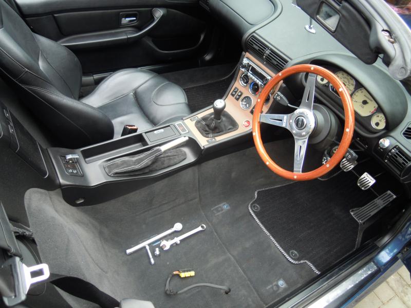

If you want to be a bit more radical with your remodelling, here are photos of my interior and the frame that was built.
I basically gently unthreaded all the wiring and relocated the switches to the centre console mounted as far back as I could push them. I then had the framework shown in the picture made and a fake panel put in front of the switches.
Top of the door linings simply glued over what was there already, you can even see the speaker panel still showing through which irritated me at the time but now I don't really notice.

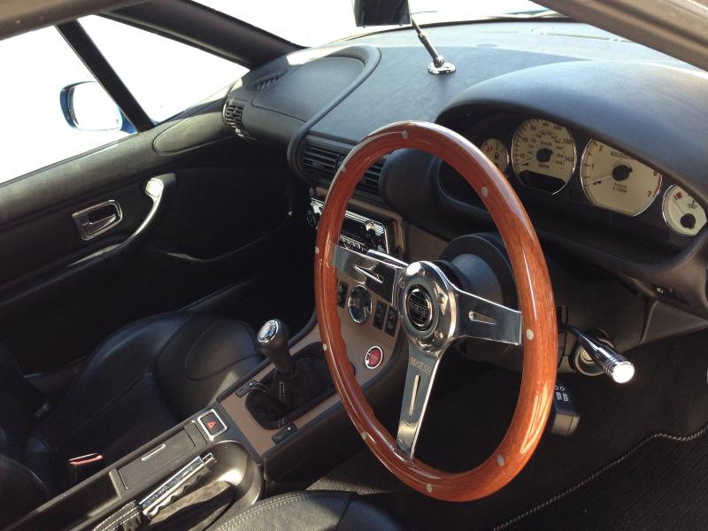

Just found a picture of my first attempt when I was playing with ideas. The idea worked but the fit and finish shows why I got help with the finished article.

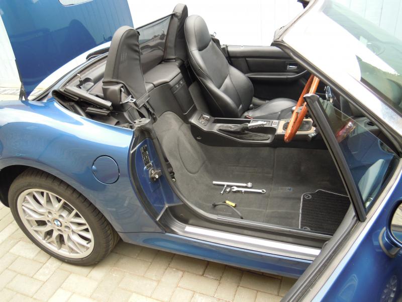

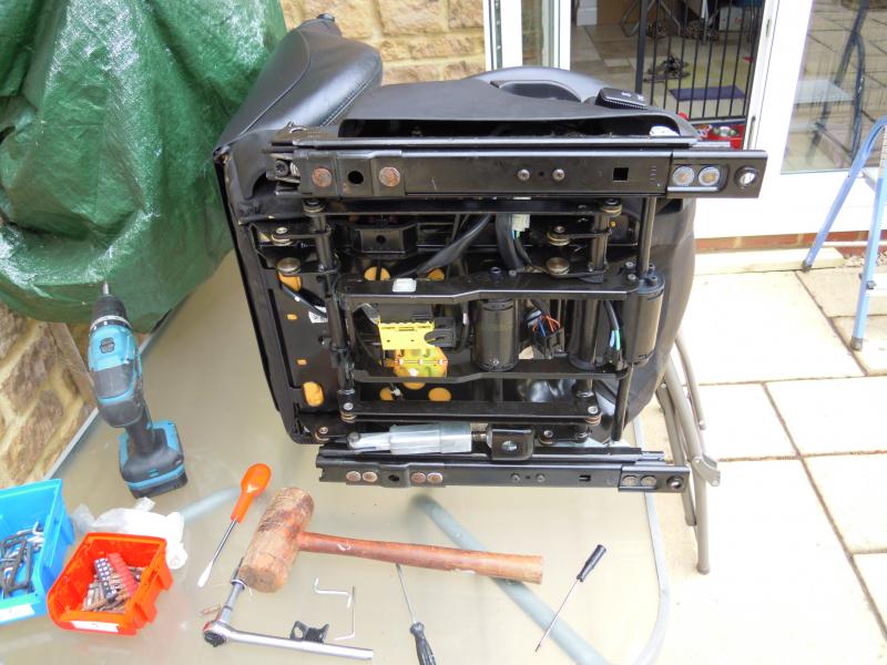

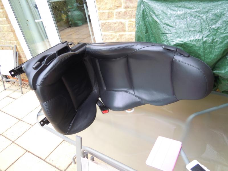

Not part of making the interior look 'older' but this weekend I pulled my seat our to replace bushes that make the seat move slightly on acceleration and braking, and is really annoying. Bought Bushes off ebay from Czech Rep, had to sand them down a little to make them fit, but all in now and no more movement! Yay!, took around 1.5 hours to do in total as a leisurely pace following z3 forum instructions, heres some pics:

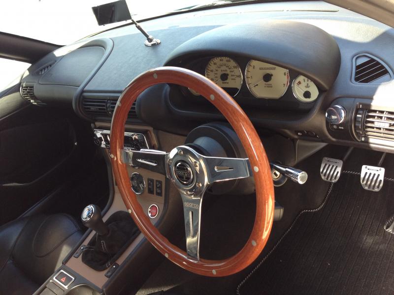

Chrome Indicator stalk ends and chrome effect door handle surrounds added:
29 Jun 2015, 5:24pm
Where did you get the indicator stalks from?
Are they easy to swap over?
Also, where did you get the door handle surrounds?
29 Jun 2015, 7:41pm
Stalks from:
uwf-Interieur
Zu den Bettern 13
35619 Braunfels
Tel. 06472-831899
Fax: 06472-831901
Surrounds from: http://www.fmw-tuning.de/BMW/3er-E36/Interieur/Chrome-parts/Inside-door-handle-surround-chrome-2-pcs-for-BMW-E36-Z3::853.html
I have 3 stalks (wipers, indicator and cruise control). I only put the new ones on wipers and indicators as need to know what cruise control movements do what.
Wipers one was easy just twist off with a bit of force applied :laser:. Indicator one was more difficult as have switch for BC, which I have removed and replaced with analogue clock, so I totally destroyed it to get it off, snipped the wires running down its centre and secured in steering trim capping each wire off so I don't get any shorts.
Both stalks have a grub screw fitment, so really easy to put on.:nod:

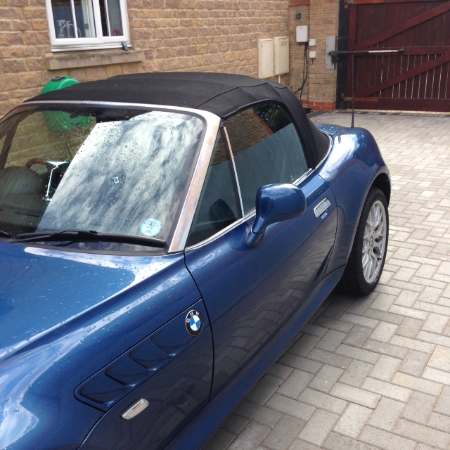

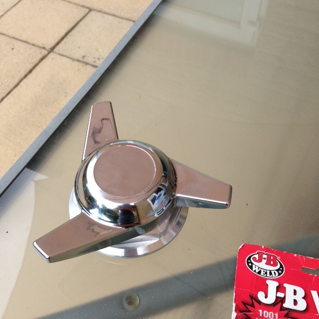

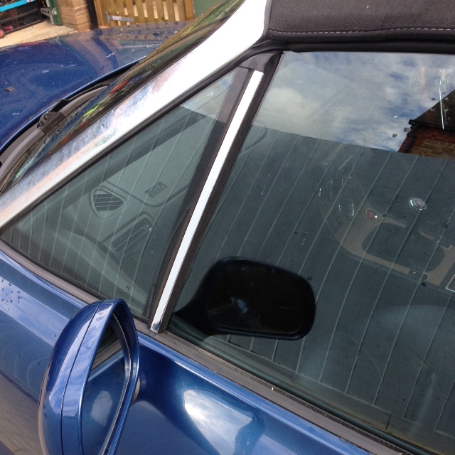

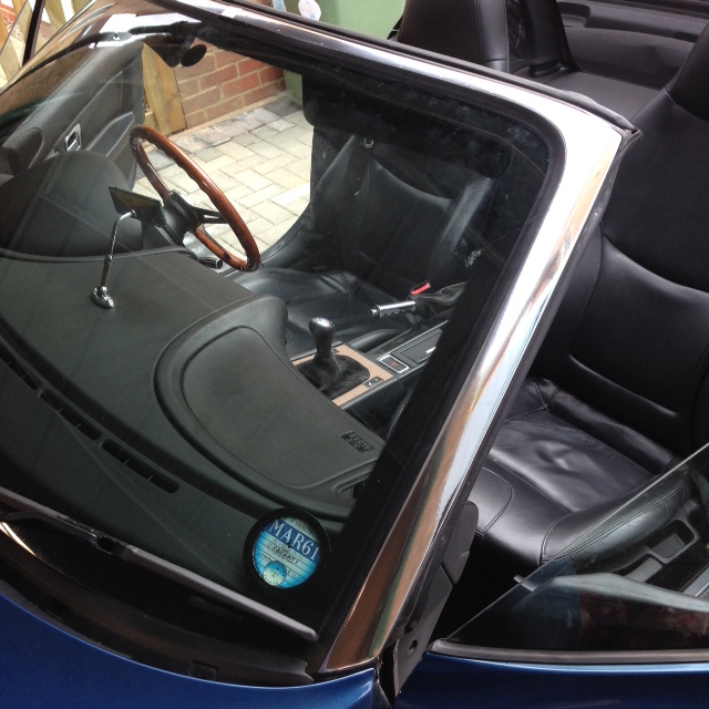

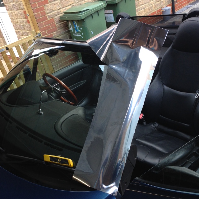

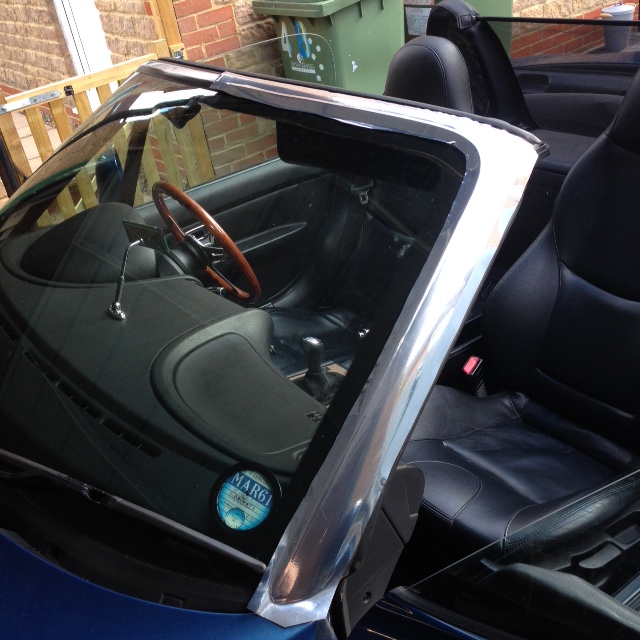

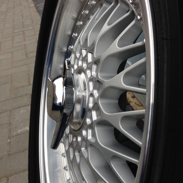

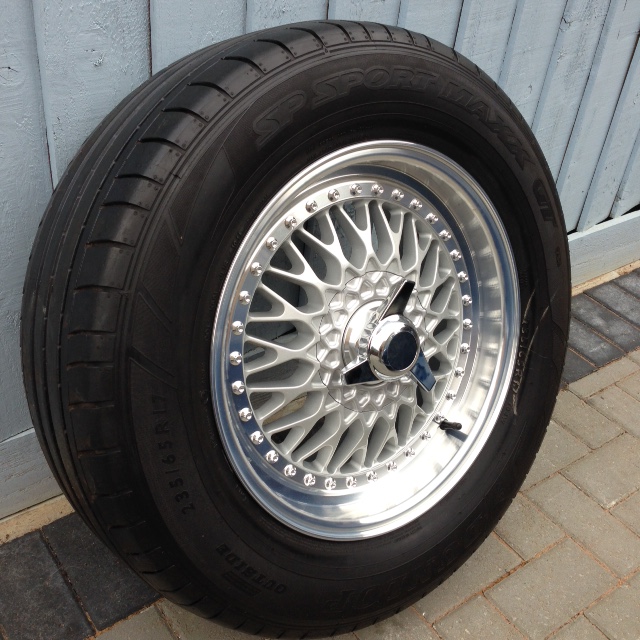

Ok, so not really classified as interior, but started to work on exterior parts as kit arriving in 1 week, fingers crossed....

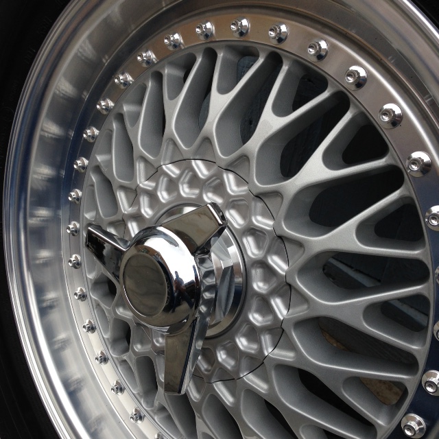

Spinners onto alloys
Chroming of side window support
before...
after...

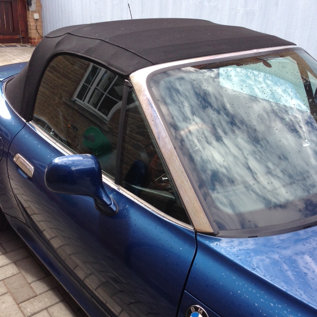

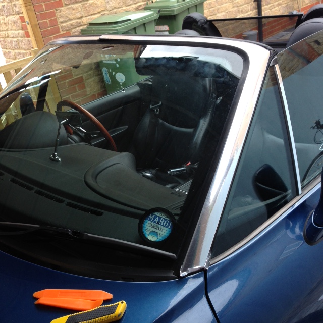

Re-Chroming of windscreen surround as it was faded...
23 Jul 2015, 7:14pm
Hi Andy,
Wheels look very nice, spinners work a treat.

Where did you get the stuff for rechroming from?
Mine is tatty and could do with refreshing. Is it hard to fit?
24 Jul 2015, 10:15am

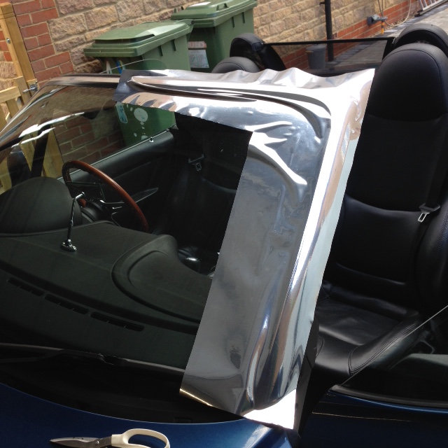

Lots of "mirror chrome wrap" on eBay.
I have some spare "sticker bomb" wrap from doing my Jago if you'd prefer...
24 Jul 2015, 11:08am
Yep ebay, search on 'chrome wrap'. Its fiddly, you'll need some 'prying tools' and a heat gun/hairdryer. I'm no professional at wrapping but I managed it ok. Still have the other side to do.
24 Jul 2015, 11:14am
An old respray trick is to lift the windscreen rubber and feed some thin electrical cable- bell wire or similar, underneath which leaves the lip raised. Wrap or respray and then remove the wire so that the new colour goes underneath the rubber.
I didn't need my heatgun when I wrapped the screen pillars and windscreen surround on my Z300S, just a warm day and a felt edged applicator.
